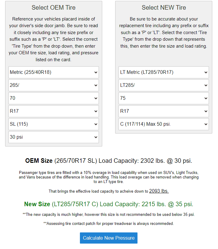

In an earlier post that received no replies I asked what PSI people were running in 285/75R17 load rated C tires.
Searching the internet found vehicles with similar GVWR’s of 6300 lbs. varied greatly from 28-40 psi for highway travel.
Internet review of chalk testing recommended procedures were all done on cold tires. I would think it would make more sense to determine hot temperature psi’s and adjust from there?
Tire Rack had no input. I’m currently experimenting at 37 front and 35 rear. Any thoughts on that would be appreciated.

Chalk test
The chalk test for my 285/75R17 load C Toyo’s found 35 psi front and 32 psi rear COLD. The tires WARM today on an 84 degree day increased 3 psi in all the tires.
So my logic would be to reduce the cold chalk tested pressures by 3 psi in each corner. Does that make sense?
Something never discussed in caulk test procedures I’ve seen.
