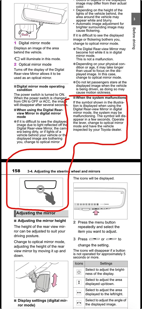

Unfortunately, no technician actually inspected the mirror issue that day because they were tied up with training. Instead, the service advisors essentially Googled the issue and initially tried to tell me the graphic was normal. I pulled up the owner’s manual and showed them that Toyota specifically identifies the graphic as indicating a malfunction. After that, they agreed to let me bring the truck back the following day so a technician could inspect it. At least they were able to complete the alignment under warranty during that first visit.
