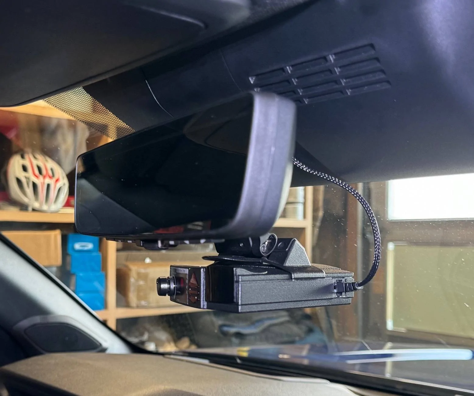

Installed our Valentine 1 in the Taco today. 10 minute job. Used a mirrortap power connection, and readily found switched power right at the mirror plug.*
You remove the mirror cover (the large one covering the forward facing camera) by sliding the whole cover down toward the dash while pressing it against the windshield. There's 2 clips on either side that will pop, it's quite simple and foolproof. There's also a center piece that pops out to allow the rest to come around the mounted mirror. Don't remove anything else.
With the cover off, you'll see the mirror plug on the left (drivers) side. It has roughly 6-7 leads. There are 3 larger wires in this plug. Red, Blue, and Brown. 12V switched power is the blue lead, and ground is the brown lead. Connected the mirror tap harness to these from the backside, and buttoned it back up. Works great. :)
* a note of caution for those running wires down the A-pillar to the fuse box. There's an airbag in these pillars on both sides, and the wire you run could interfere with airbag deployment. For this reason, I prefer a mirror-based connection for my detectors. FYI.

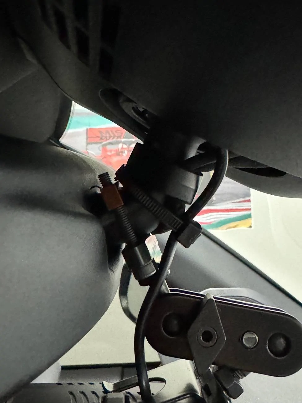

Did mine today. Used a blend mount and add a fuse. Ran it down the passenger side and popped into an open spot that had switched power. Took maybe 30 min total.
FYI, that bolt back there isn't a ground.
I routed my ground back up the A pillar and used the lower air bag mounting bolt.
Little sketchy but once everything is back in place doesn't cause any interference.
The A-pillar trim mounting bolts also aren't grounded.
Ok if you say so. Mine works perfect so obviously on my truck it is a ground or it wouldn't work. Cheers.
