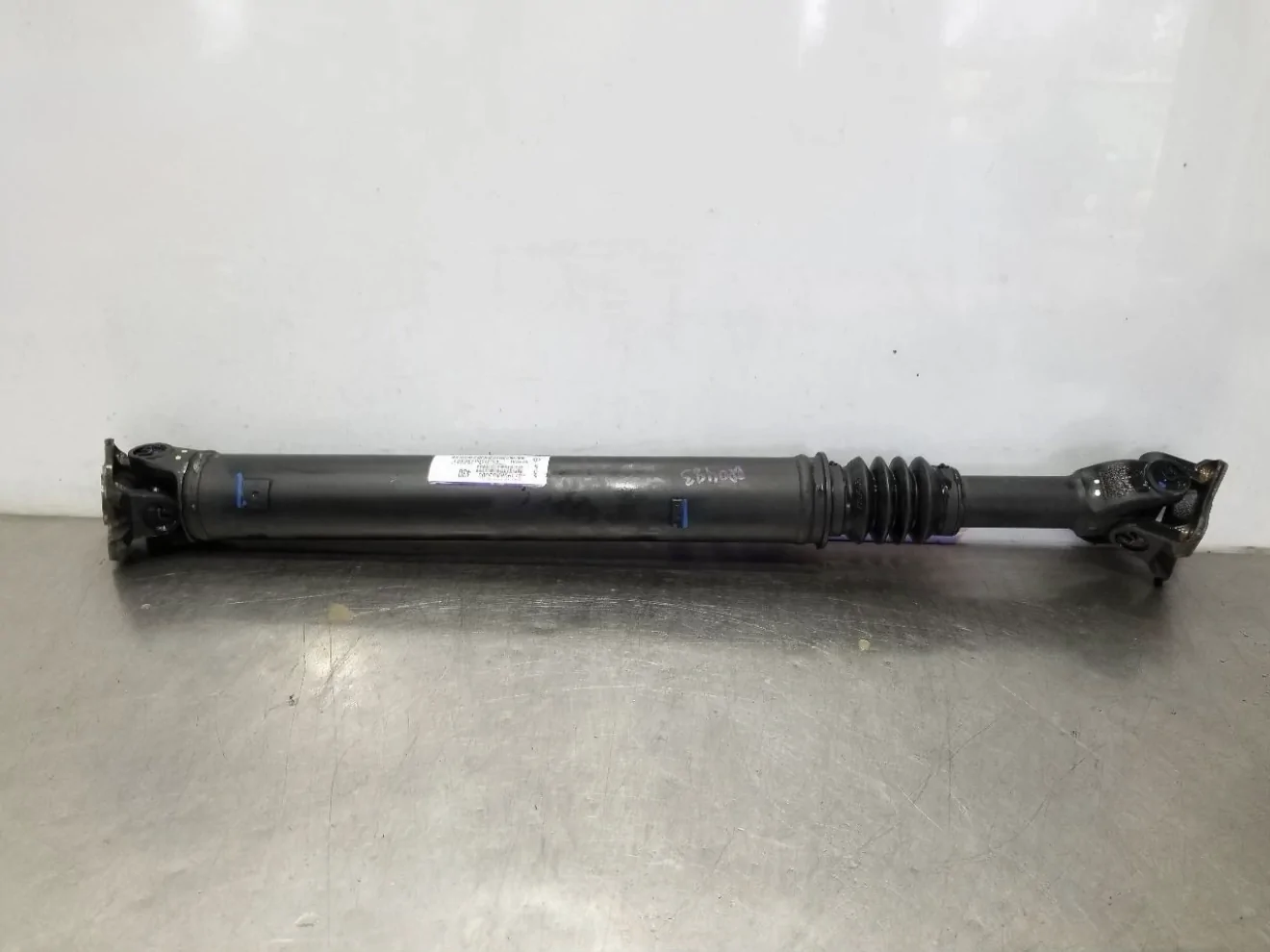

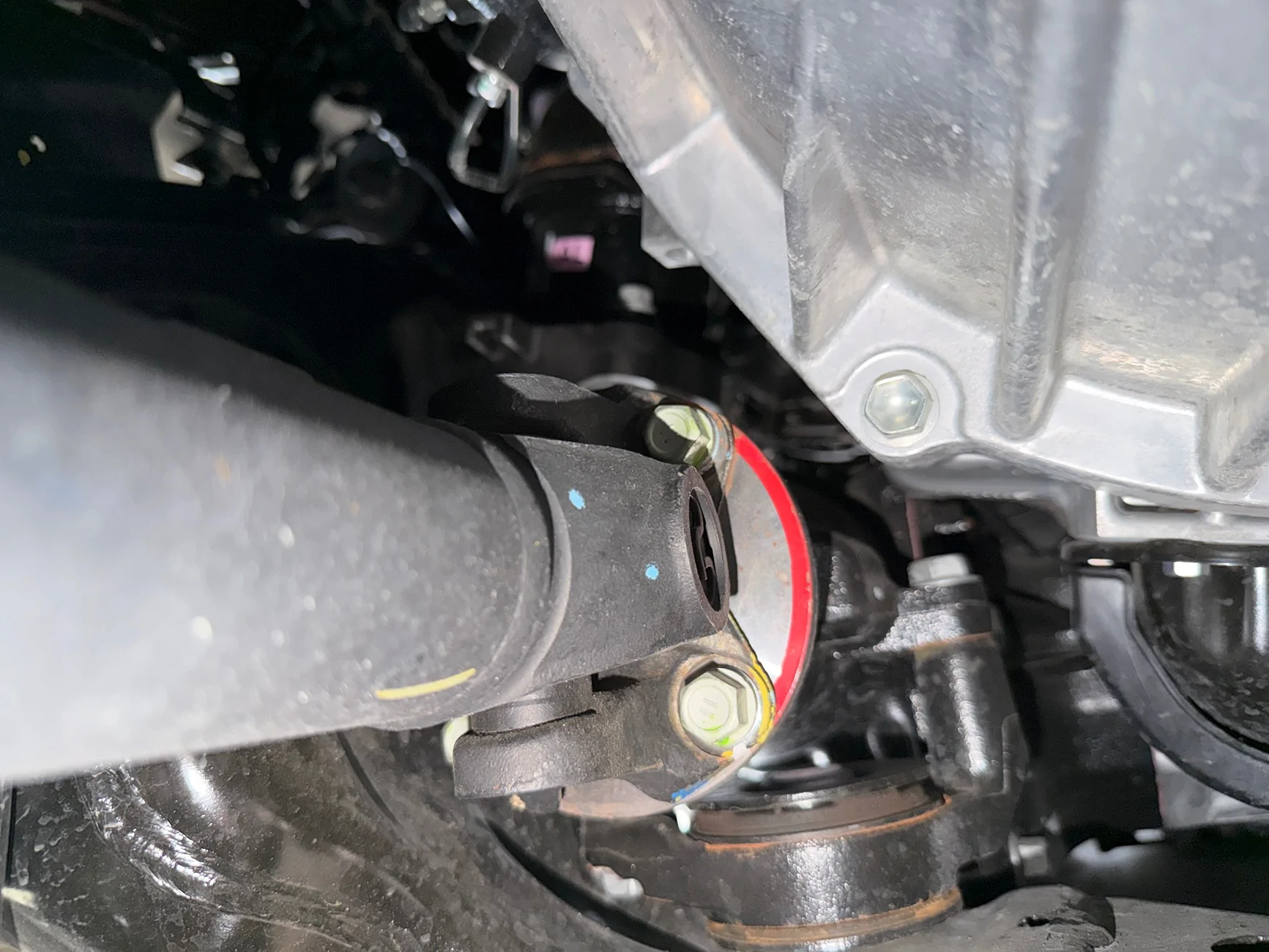

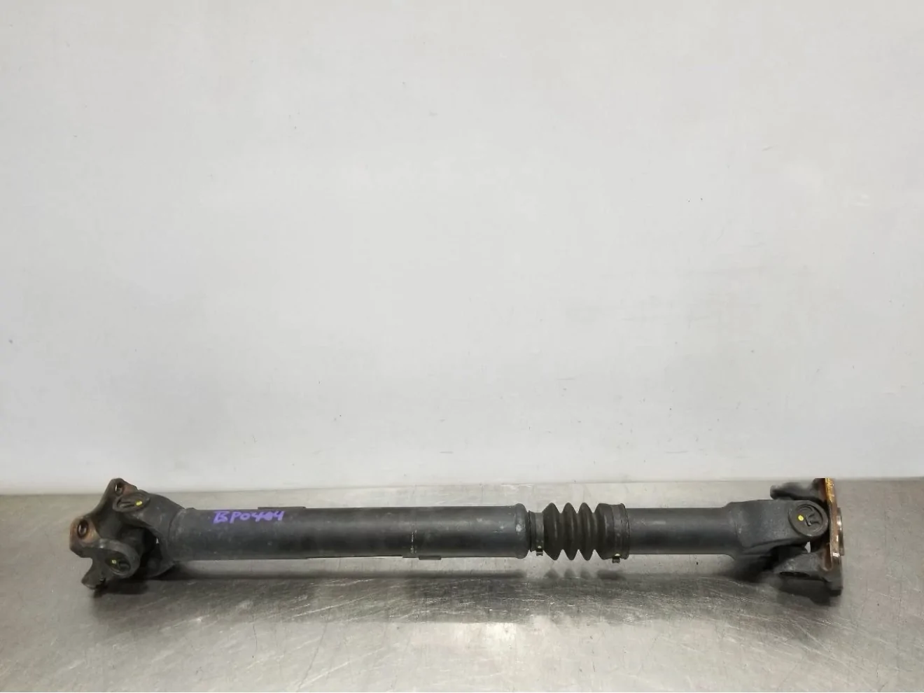

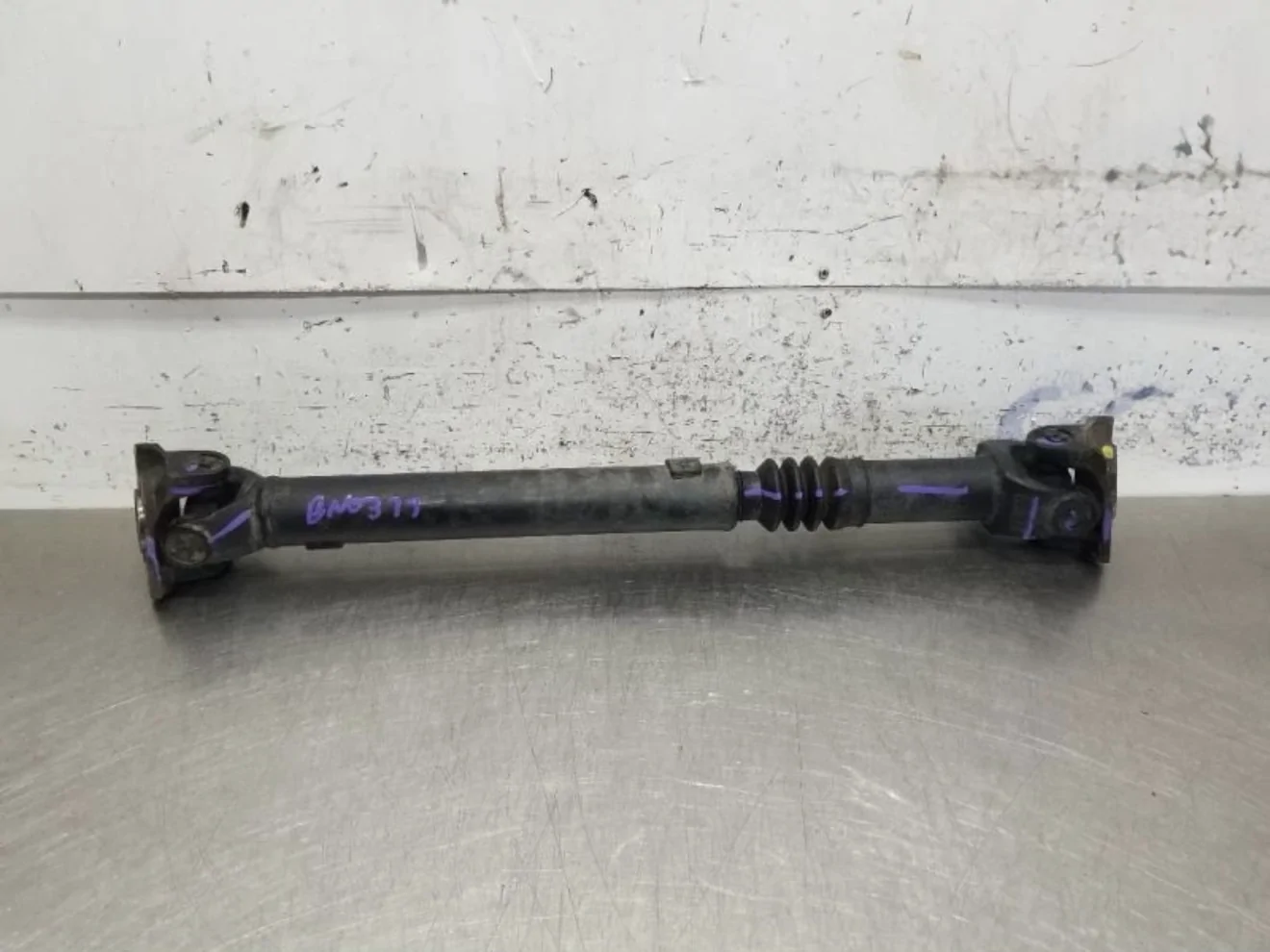

It could be just an assembly issue. The slip joint has a spline, and that first pic does look as though it could be off by just one tooth. But then if you correct it, the shaft would likely require rebalanced.

I've noticed it on mine since the first time I engaged 4H with any meaningful speed, and sadly after the 60 or so miles in the winter storm, it didn't get any better.
I agree it's probably off by a tooth, but it's not just mine - it's every single front driveshaft for the 4th gen that I could find on eBay. Whereas previous gen had them perfectly in phase as expected.
I'm not sure how the 4G driveshaft could even pass a balance test unless there is no angle on the balancer machine. Spicer typically knows what they're doing very well, I'm amazed to see them be the builder of this shaft unless Toyota specs told them to do this for some unknown reason.
I don't lean on AI very much but ChatGPT does tend to agree that there are zero functional reasons why someone would want a 2 joint shaft to not be in phase.

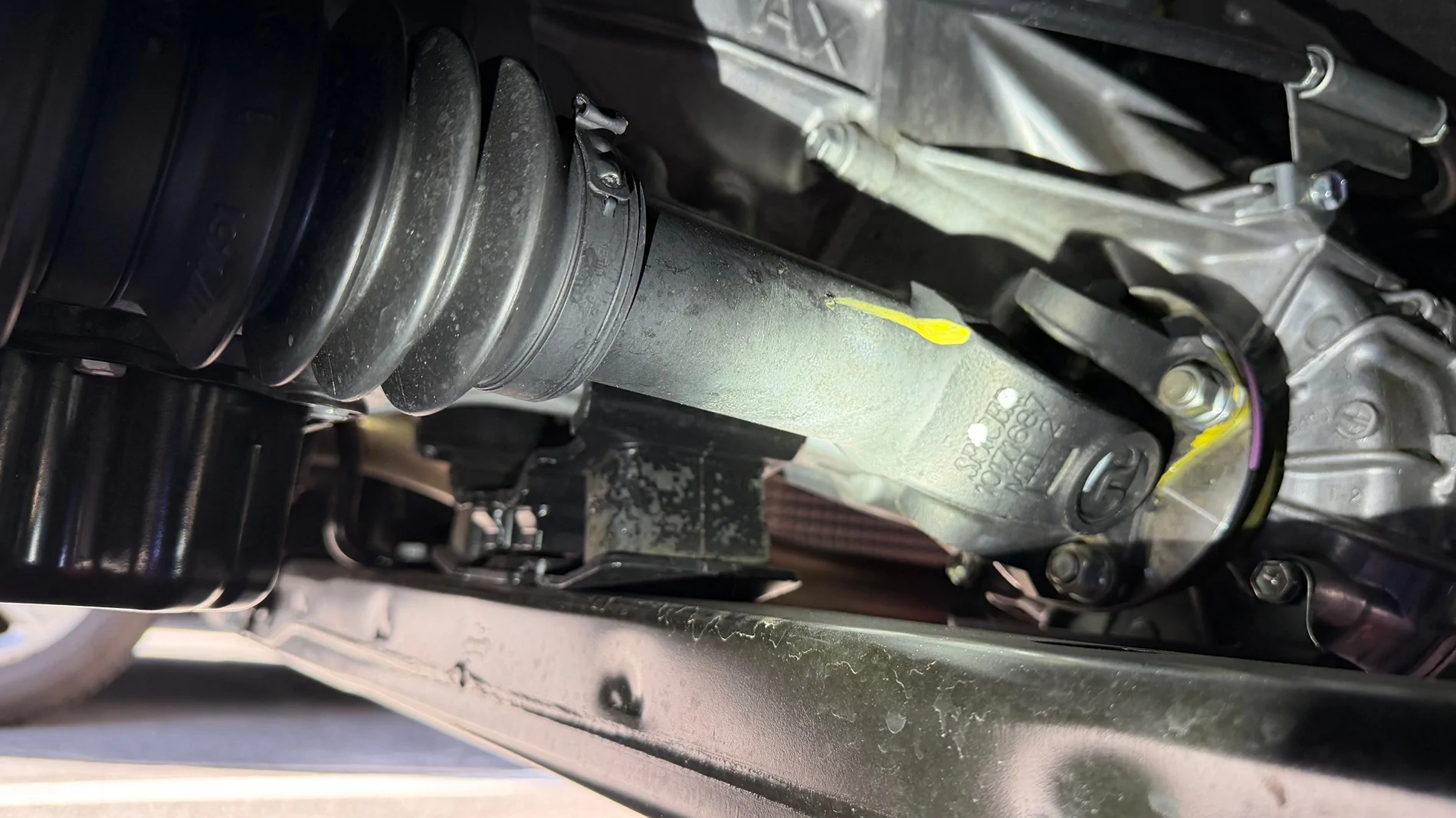

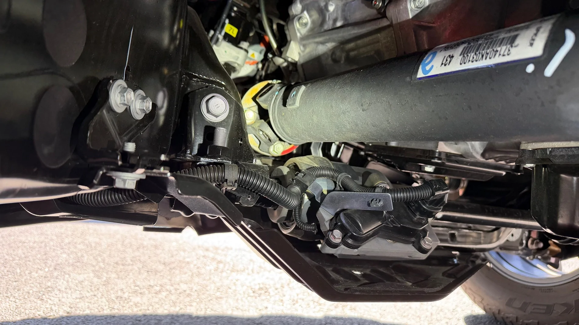

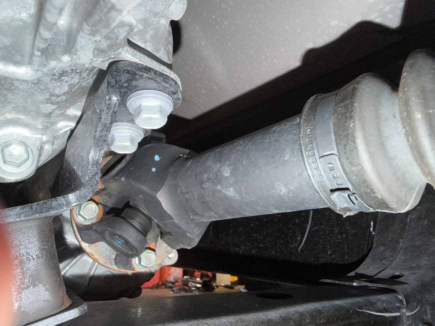

I decided to pop out and take a look at my front drive shaft August 2025 MY25 TRD Off Road Hybrid.
My driveshaft appears to be 90 degrees out of phase.
Have not noticed any vibrations to speak of, though generally don't use the truck at freeway speeds in 4wd, rarely did with my 3rd gen as well.

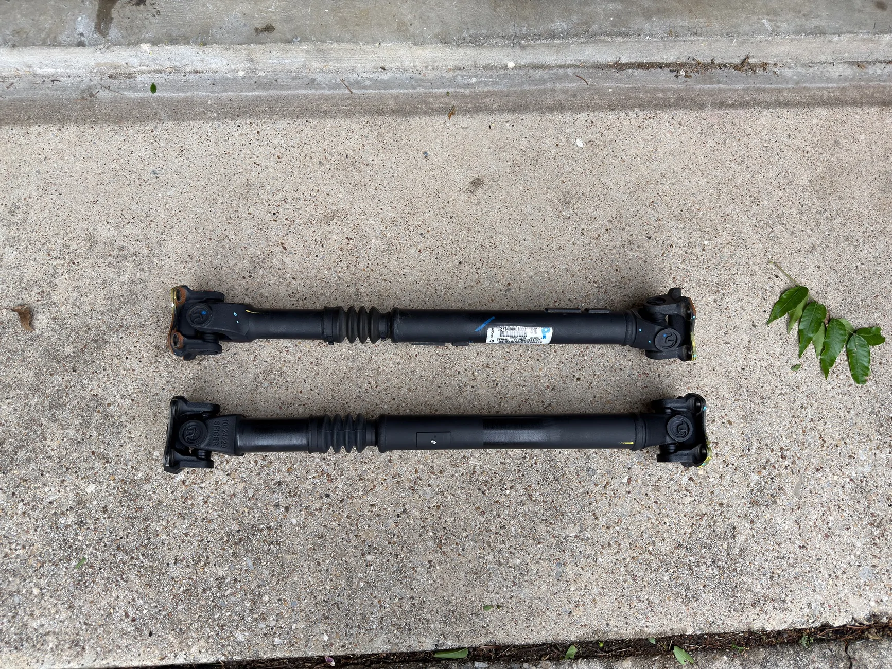

While phasing probably contributes in some way, it seems to be an intentional choice regardless. I received the new driveshaft today and installed it. Before doing so took a comparison photo. The two are practical identical besides the phasing.
Old on top, new on bottom:
2024 Tacoma Discovered the Front Driveshaft Out of Phase (Intentionally) IMG_3256
Unfortunately the vibes are now worse, so this is a failed experiment. That’s disappointing.
