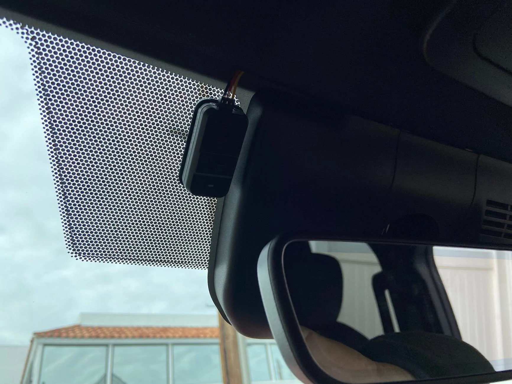

I installed mine today in preparation for my VanTrue E360 dash cam that ships next month.
So easy even a caveman can do it?
It took me a whole 3 minutes from start to finish after watching the video. The look is very sanitary. This product is an exactly what I was looking for.
Thanks Dongar!!!
