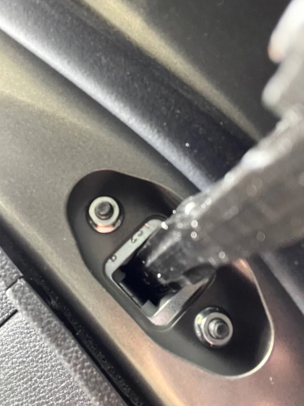

Just noticed in the last couple days when I open and close the drivers door it started sounding loose.. like something was clicking/and knocking a bit, all the other doors were fine..
Upon further investigation this morning, I discover the nuts on the check strap where it attaches to the door are finger tight at best, I was able to thread it in and out with my finger tips. They had backed off and was causing the strap to click and wobble.
Something to definitely check on yours if you're noticing any strange clicking sounds coming from any of the doors.

Thanks for the heads up @-Strike-. I wonder what the torque setting for those is? If we knew we could check that before they might come loose on their own. I guess the first move is to make sure they are not just finger tight. Which plant was your Taco built in?

Grabbed my trusty 10mm this afternoon and tightened them both up. Top was embarrassingly loose and the bottom one was was loose as well. Tightened em both up to .. good enough lol
Surprise surprise, noise gone

Same! Top nut was half way off! Making noise when closing for the last month. Torqued it down, doesn’t matter how much just tight. It even had the paint pen like it was QCd or something
