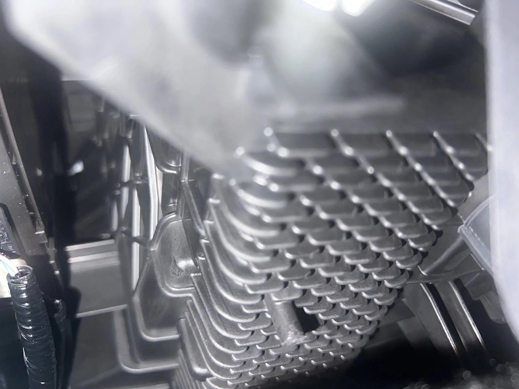

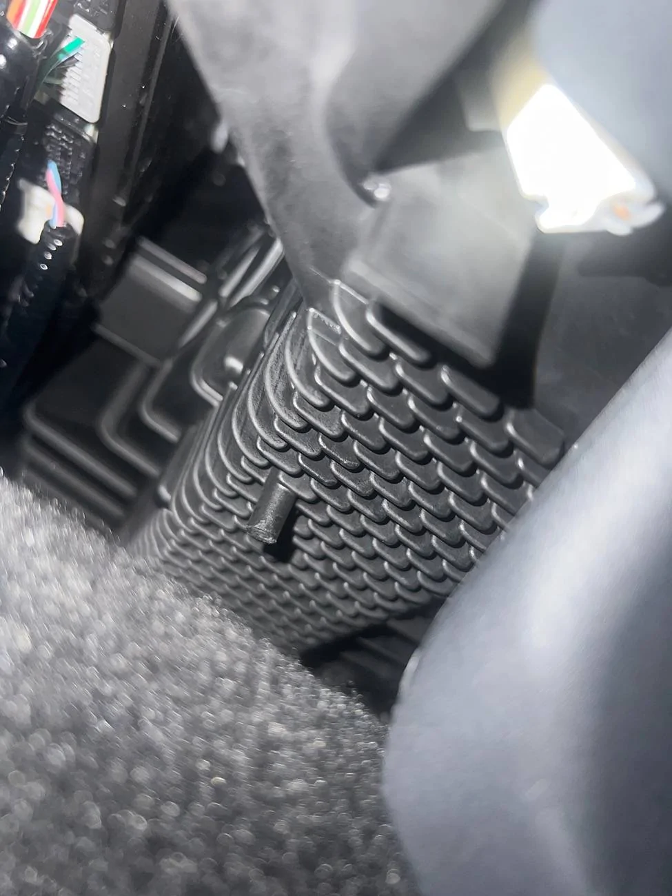

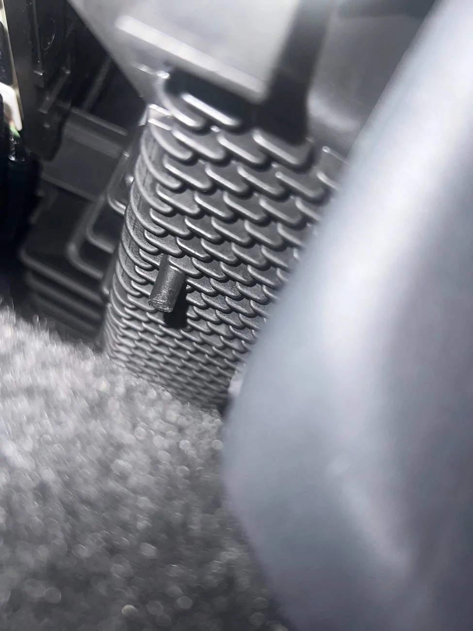

So does this look all clear? And is this a part failure or install error.
3TY, dual climate, build date 5/24
It was an assembly problem in Guanajuato (3TY). The evaporator box is attached to the front crash bar. The mounting points were not where they should be, because the crash bar was out of spec. When the part is screwed into place the stress cracks the evaporator.
According to Toyota this problem was resolved and should not happen in later builds. I have not seen this problem in any trucks built in Baja (3TM).
