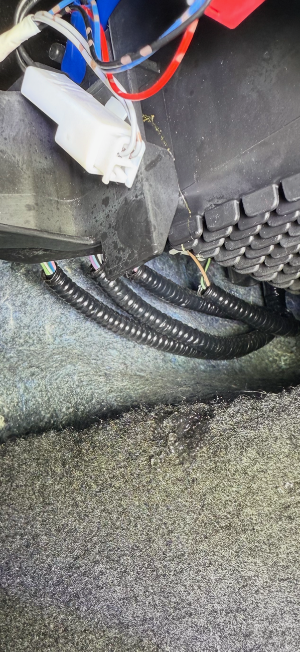

Have the same issue with my 3TY vehicle. Has been to two dealers who did not find any source of the leak. Last dealer asked me to bring it in while the leak is occurring. Happened today quite a bit and unfortunately it is a holiday so could not swing by. I did however pop the panel under dash as soon as I came home and took a photo and video of issue. I will contact the dealer tomorrow to advise and provide photo and video.
I did note in many of the pictures as well as with my leak that the seam of the crack has yellow stuff that almost looks like some sort of a glue. Wondering if they tried to glue these up at the factory once they realized they were cracking them during installation.
2,365
3,061
Yeah - that does look like a really lame attempt at a "repair". That would be sleazy if the dealer did it and outright fraud if they did that at the factory.

Have the same issue with my 3TY vehicle. Has been two dealers who did not find any source of the leak. Last dealer asked me to bring it in while the leak is occurring. Happened today quite a bit and unfortunately it is a holiday so could not swing by. I did however pop the panel under dash as soon as I came home and took a photo and video of issue. I will contact the dealer tomorrow to advise and provide photo and video.
Doubt it was a dealer attempted repair. Looks like the same stuff I saw on multiple photos posted by others.
