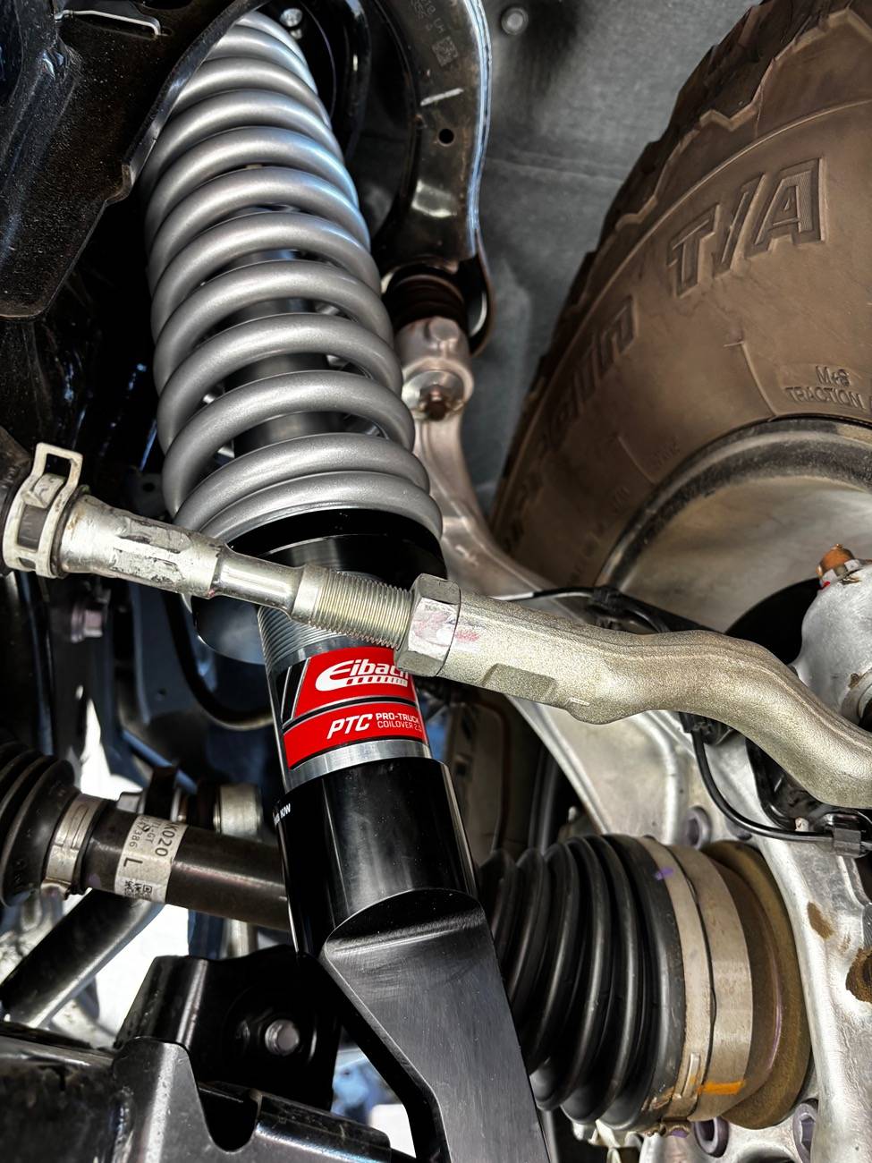

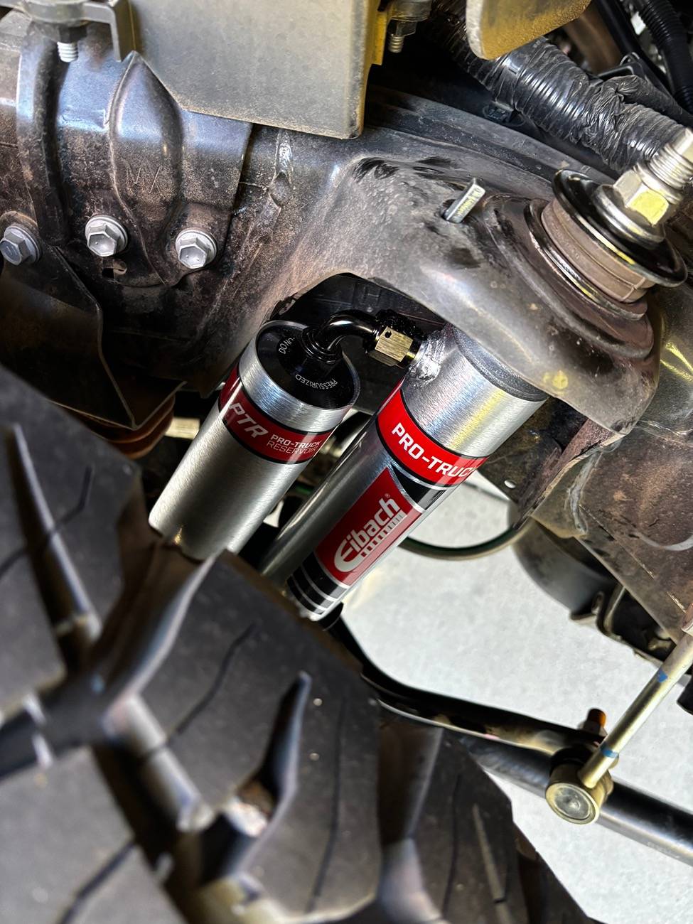

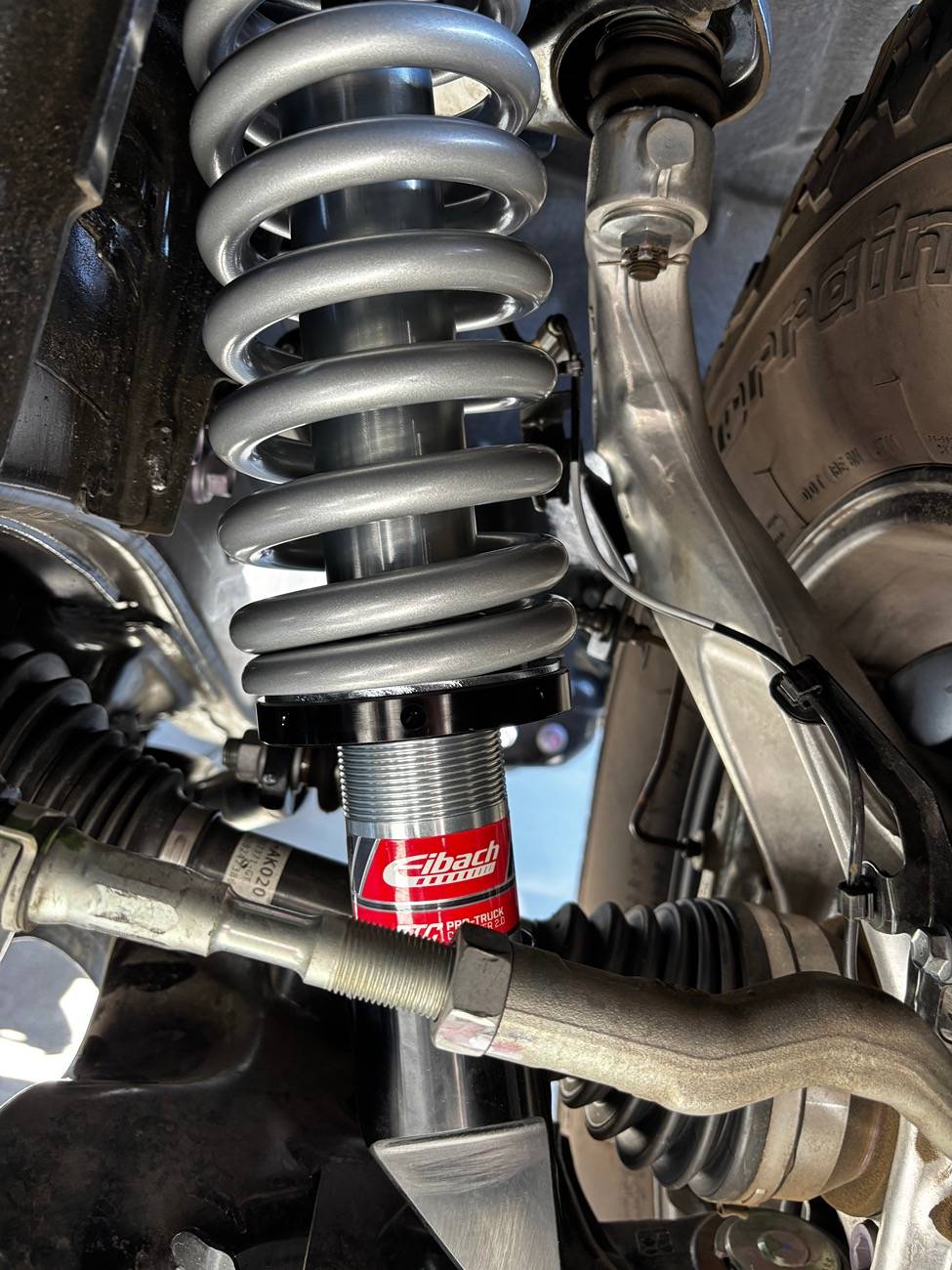

Just had the Eibach 2R installed along with Dobinson rear springs.
Much, much better ride compared to stock Toyota/Bilstein
2024 TRD Off-road Hybrid
2024 Tacoma Eibach ProTruck 2R set lift kit vs. stock Off-Road suspension? IMG_1958
2024 Tacoma Eibach ProTruck 2R set lift kit vs. stock Off-Road suspension? IMG_1959
2024 Tacoma Eibach ProTruck 2R set lift kit vs. stock Off-Road suspension? IMG_1939

The setup is holding up strong.
The Eibach Pro Truck Lift 2R has been impressive, the ride remain smooth? What was the measurement on the front shocks?
As for the CV axle part numbers for the driver and passenger sides on your trd Hybrid, can confirm those part numbers. referring to OEM CV axles?Cant thank you enough..
