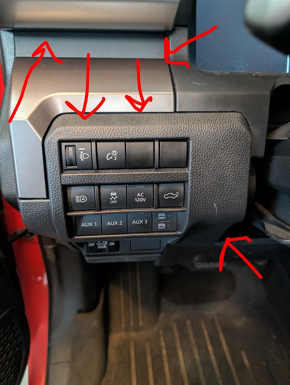

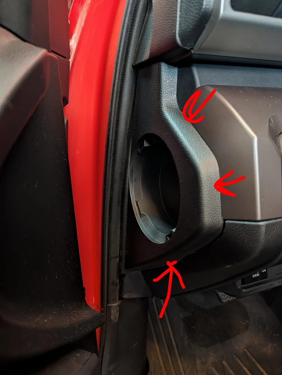

@SmokyMtnTaco Question. Why did you have to take all the other stuff apart instead of just pulling out the switch panel. Can't you just unclip the switch panel? I did a similar switch update for my light bar by unclipping the "hidden compartment" panel, the panel above the switch panel then the switch panel. unscrewing necessary.

Just food for thought, when I did my recent light bar install, I didn't have to remove any 8mm bolts. If you just remove those panels (pics attached this time), you'll have full access to the switches. Hopefully that makes life a little easier for you. The switch panel might not pivot as much as when you remove the bolts but you still have plenty of room to get in there and change out whatever you need to.
