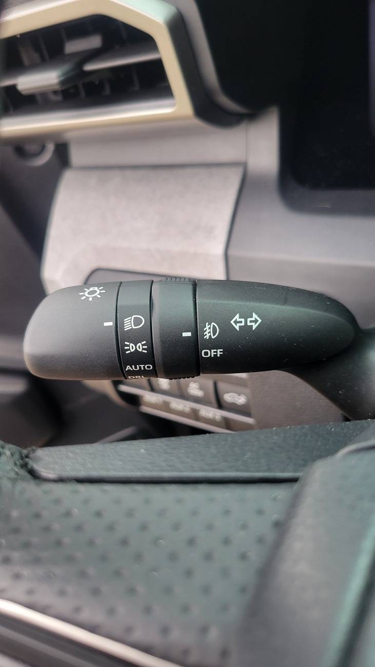

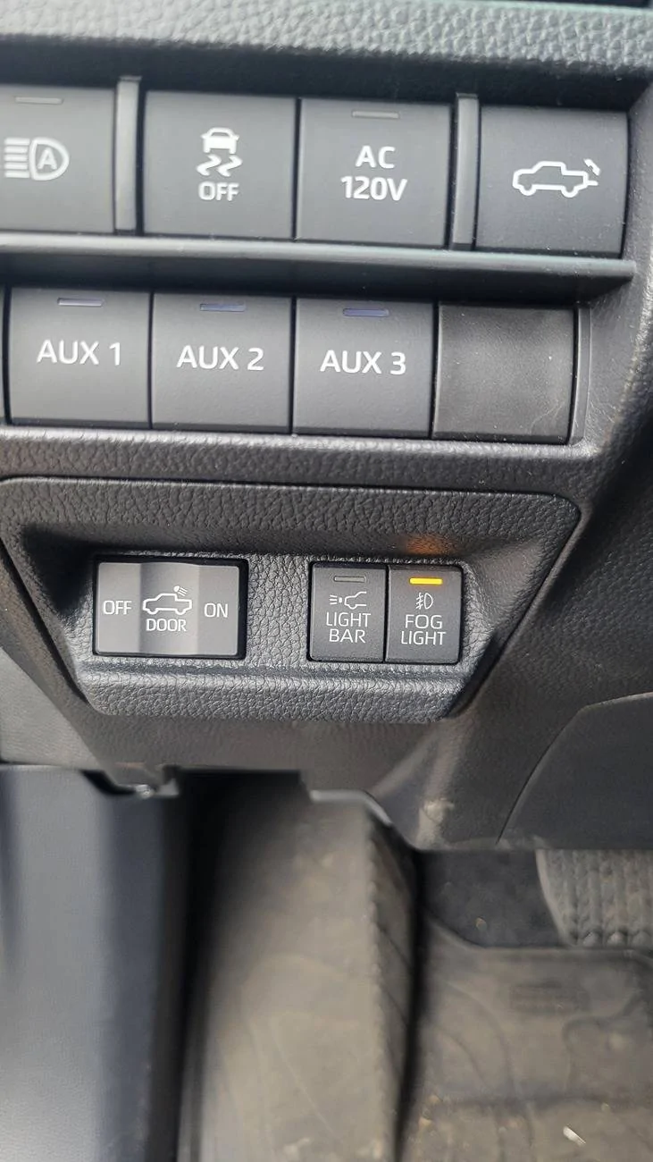

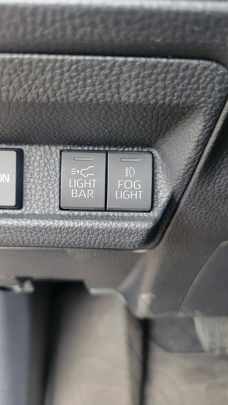

This may not be a major problem but this is still an issue on a truck I paid cash for lol. I live in a Port town and we have early morning fog roll in regularly. I usually just leave the fog lights on with the AUTO DTRL. Like every morning I was on my way dropping off the kids to school when was coming to a complete stop I was able to see the reflection of my Trailhunters lights , I noticed the fog lights just give up they turned off automatically. Not sure if it's a relay or what? The lights work when I place the lights on fully on. Has anyone experienced this? Anyone know what fuse or relay to check any help would be appreciated ...

Does the lower fog light switch change the color of the lights?
2,411
3,103
According to the owner's manual the fog lights only work when either the parking lights or headlights (low beams only) are on. That is how all of my other Toyotas have worked also.
