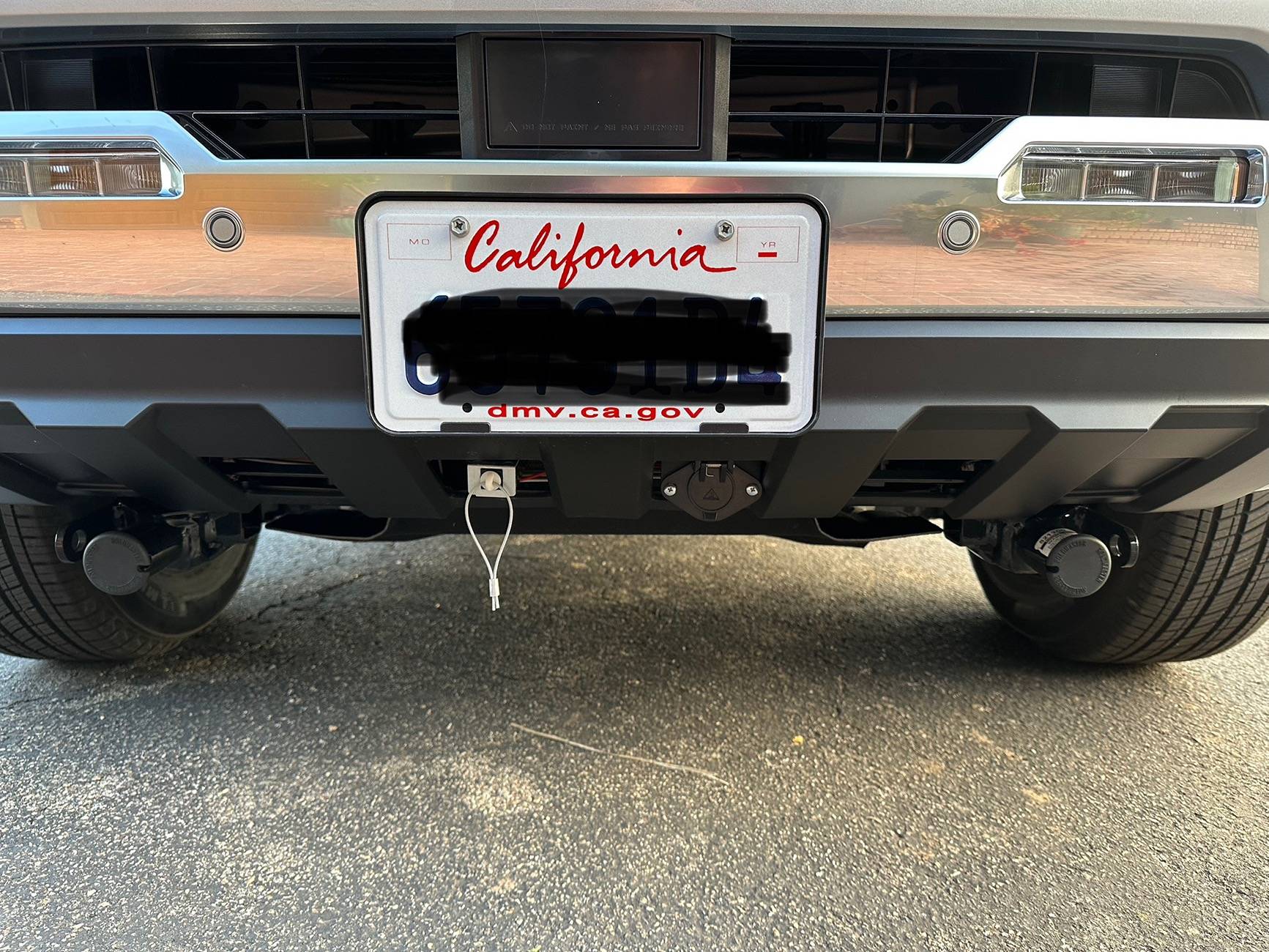

@Leo319 Thank you for your assistance with the parts. I ended up ordering and installing:
Roadmaster RM32EQ Direct Connect base plate kit for 2024 Toyota Tacoma: which ended up needing some modification to the bolt holes that go into the stock tow hook mounts. fit perfectly in the slots in the air dam, or you can leave the air dam off. On my limited I had to order .75" rubber plugs for the control arms to eliminate the wind howl by removing the air dam.
Demco Stay-In-Play Duo braking system (this fit perfectly). The 6 pin plug, and break away switch fit perfectly in the lower grill with no modifications.

That’s awesome! They didn’t have the baseplate available when I did my set up, post a pic once installed if you don’t mind. Curious to see how it comes out.

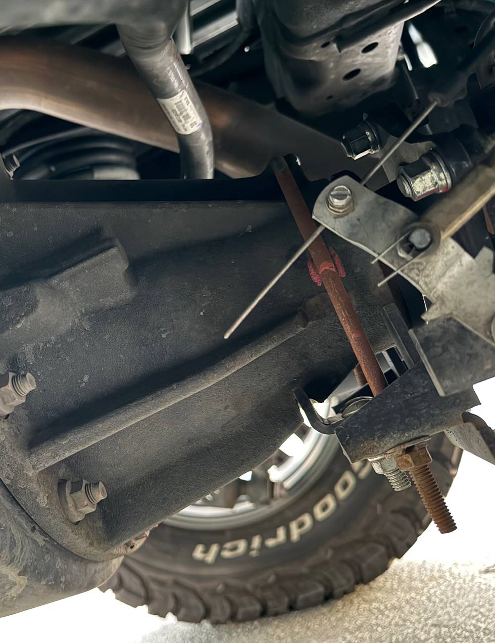

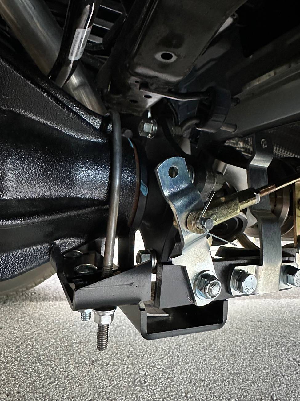

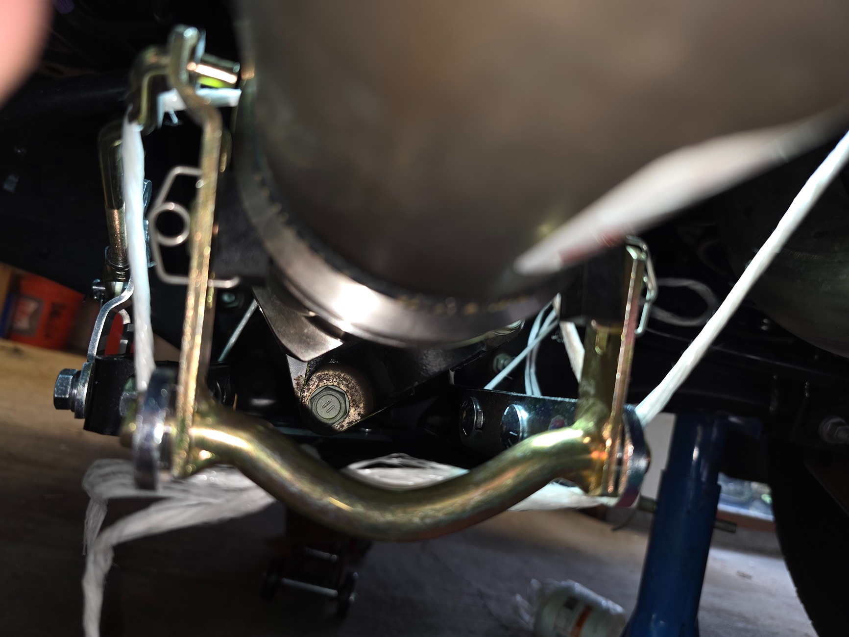

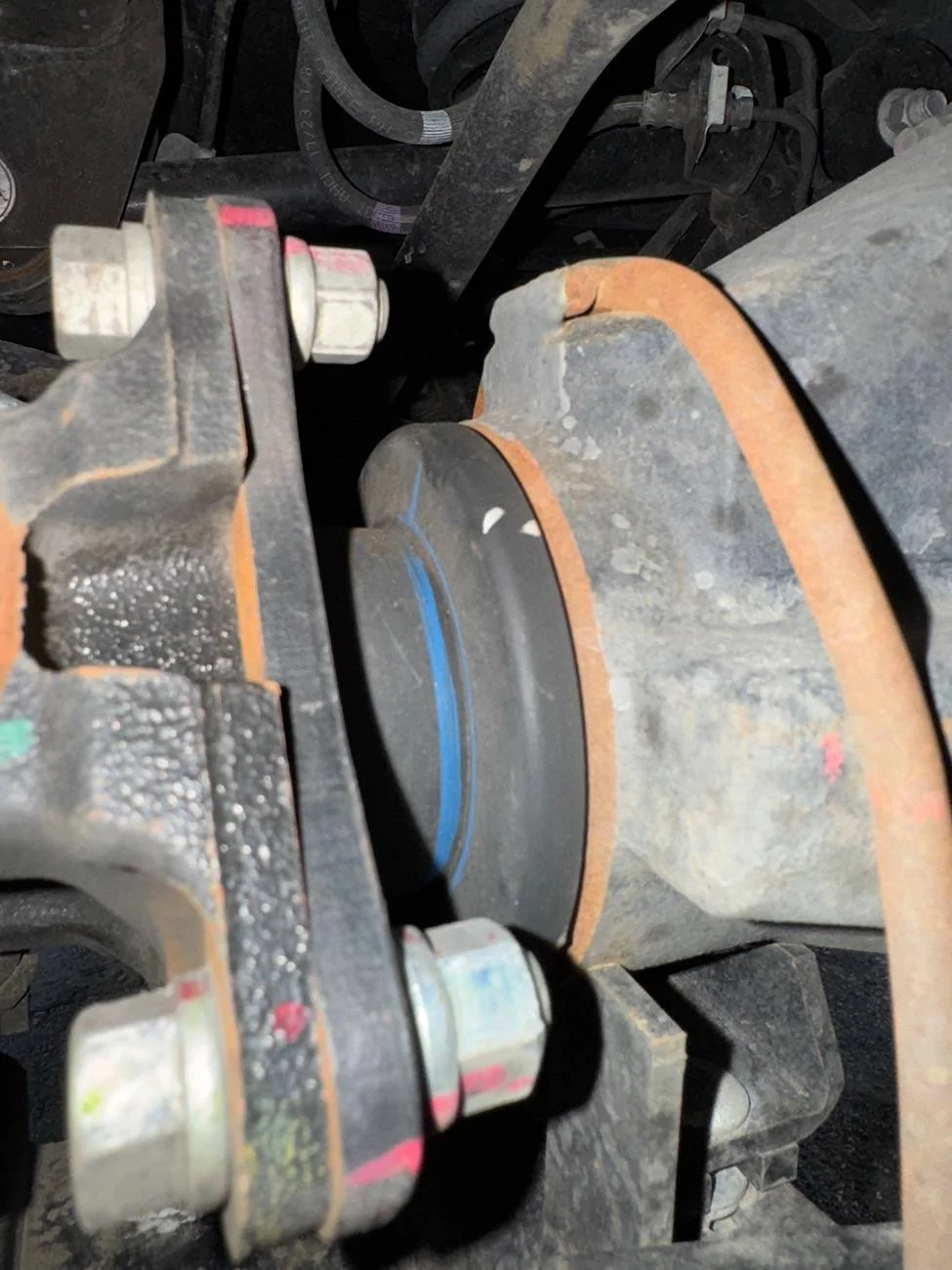

@Leo319, I got my drive shaft this week, and I installed it. I attempted to install the release lever, but I can't seem to find a good way to get the u-bolt to attach to the rear diff. Do you by chance have any photos of yours installed?

Here is my first attempt at the shift lever. I emailed Bill for ideas. my concern is I don't have enough meat on the top of the rear end for the u-bolt. If it were to slip, it would be catastrophic.

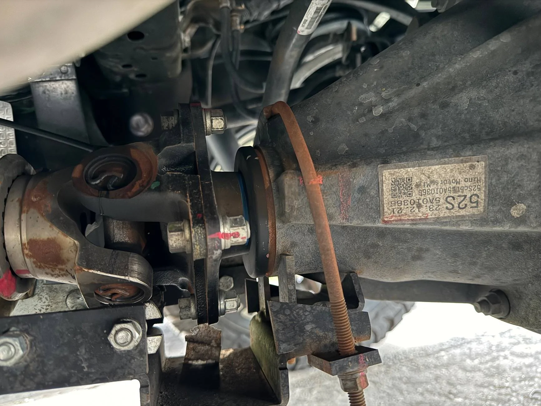

Hey sorry for the delay… yes, I encountered the same issue when they way you have it that’s pretty much as good as it gets. I marked the sides with red paint where the ubolt sits to see if it moved after driving it, but it didn’t. Towed it to Tahoe and back like that.
when I got back, I added a bit of JB weld on top for peace of mind (pics attached). Took a trip to Washington and back, nothing moved.
Heading to Moab toward to the end of next month, I’ll let you know how that goes lol all kidding aside, I didn’t like how it sat either, but appears to be holding up. Time will tell I suppose..

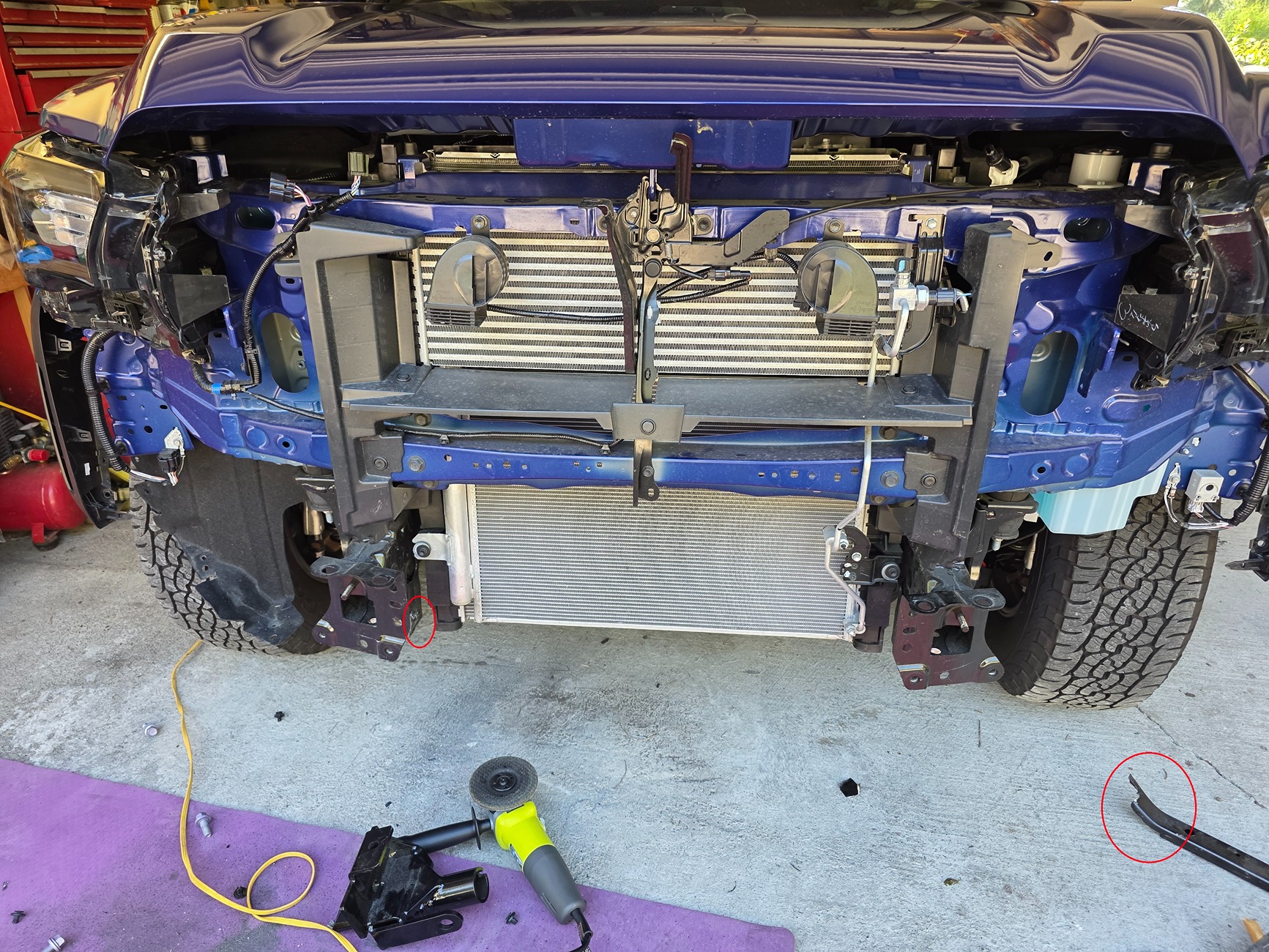

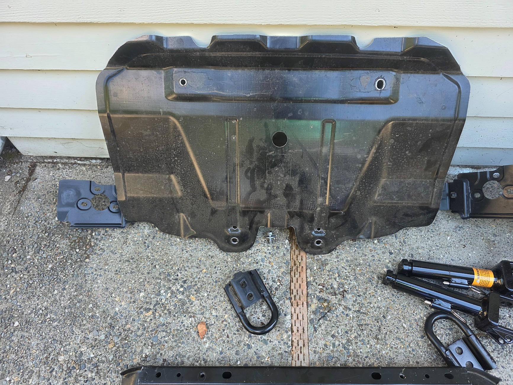

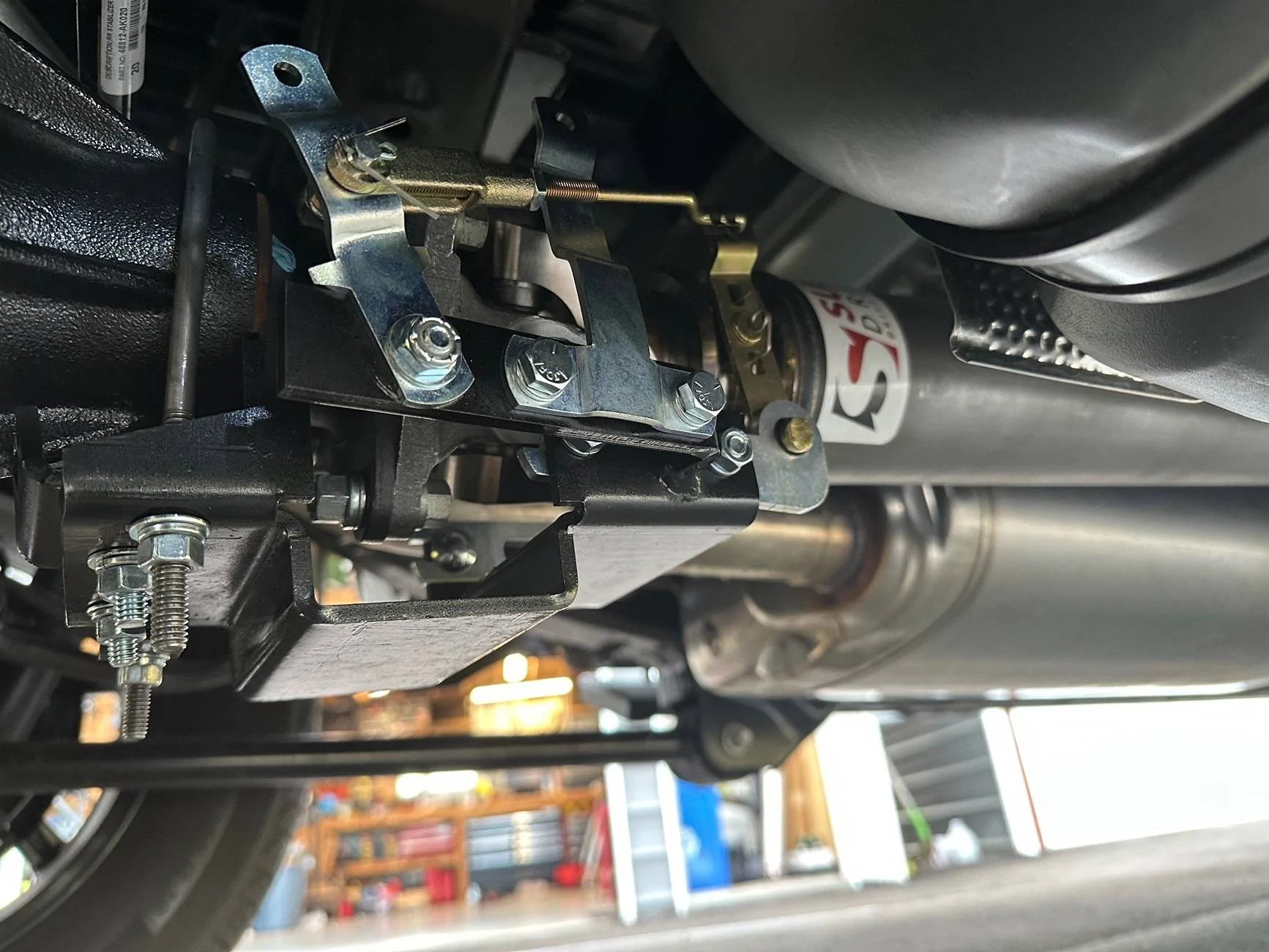

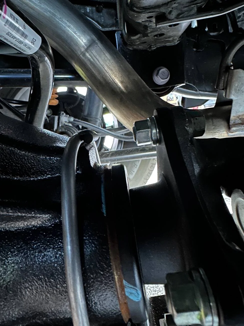

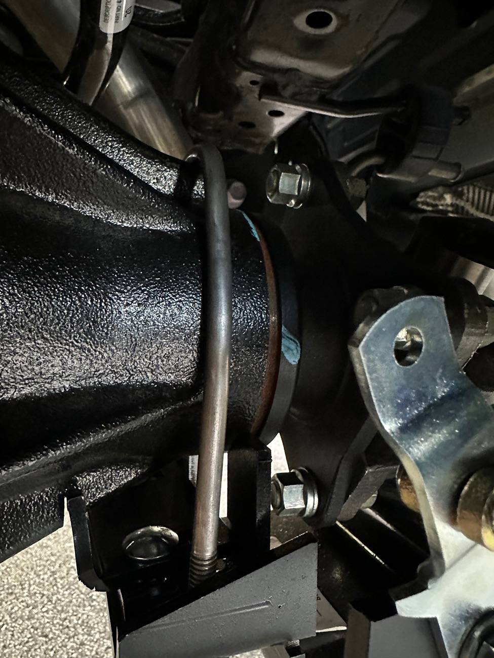

Just finished installing the RM32EQ baseplate on a new 2024 Tacoma long bed with a locking rear differential. The baseplate went on okay but the instructions are wrong. There are four bolts between the fascia and the structure that are not mentioned in the instructions but I found them in a video when looking at removing the fascia. There is also an interference problem with the fitting itself from Roadmaster. They tell you to grind down the frame to remove the excess weld but they don't tell you that a cross beam that holds the skid plate on has to be removed to make the fitting installation work. I have contacted Roadmaster with photos and a a description but they have not responded to my emails. Buyer beware. The fittings are installed, see photo with fitting with interference location circled.

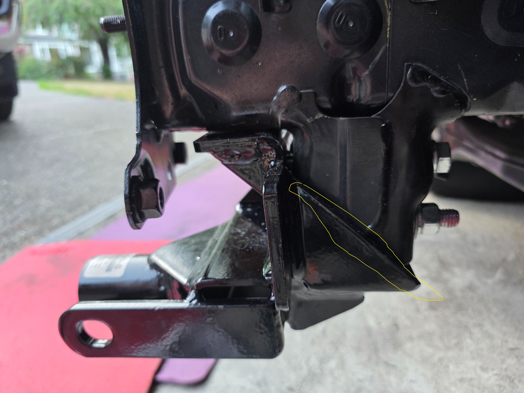

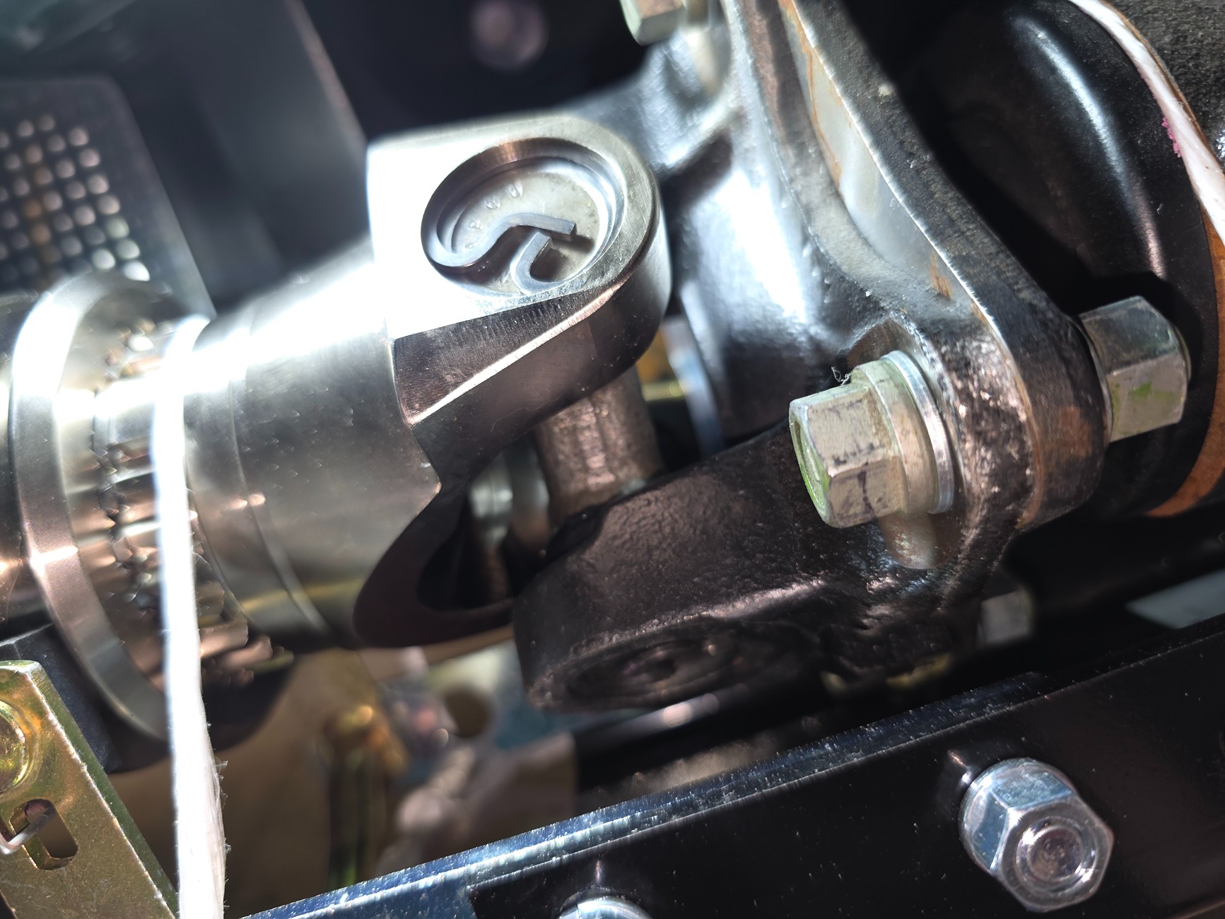

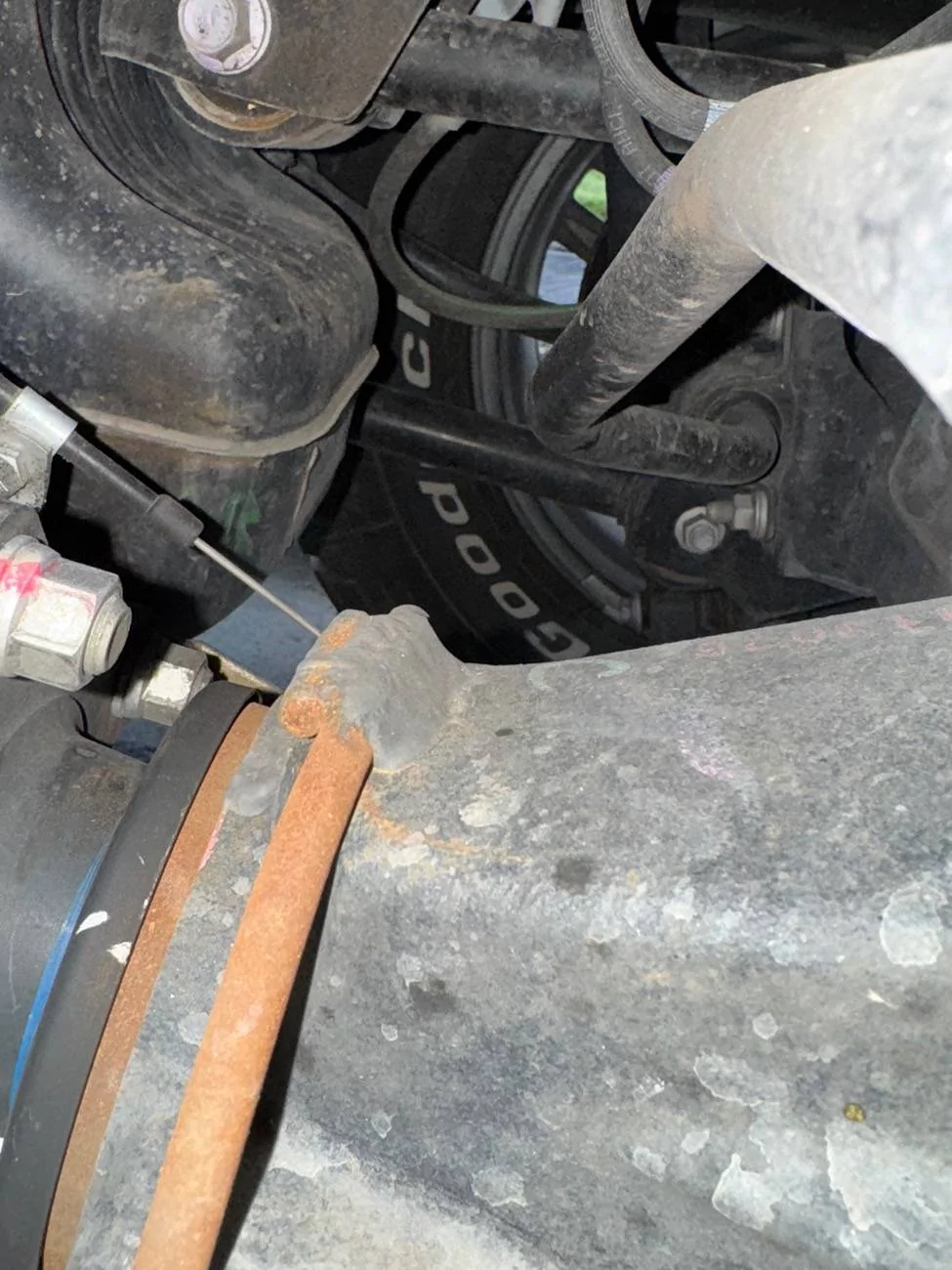

The second issue is with Superior Driveline. As I said I have rear differential that is locking. That means there is a mechanism on the passenger side near the top. Because of this SD provides a different mounting method for the disconnect mechanism. The mechanism is attached to the differential by 3 standoffs that use the 3 threaded bolts on the lower part of the differential. That is fine but there is no large u bolts going over the top of the differential. The problem is that the holes do not line up for the standoffs. Two out of three bolts line up. Also the structure for the mechanism interferes with the driveshaft mounting flange. The mechanism is too high and the sides will hit the turning driveshaft. There is a slot in the mechanism for a rib on the differential to fit around but it is mislocated also. I ground a new slot which allowed me to put it up there only find out about the mismatched holes and interference. They are looking at it and will get back to me. I don't need the disconnect until late October but I can always crawl underneath the truck and manually change the position of the slider.
