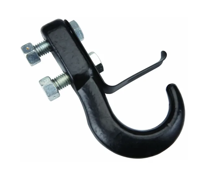

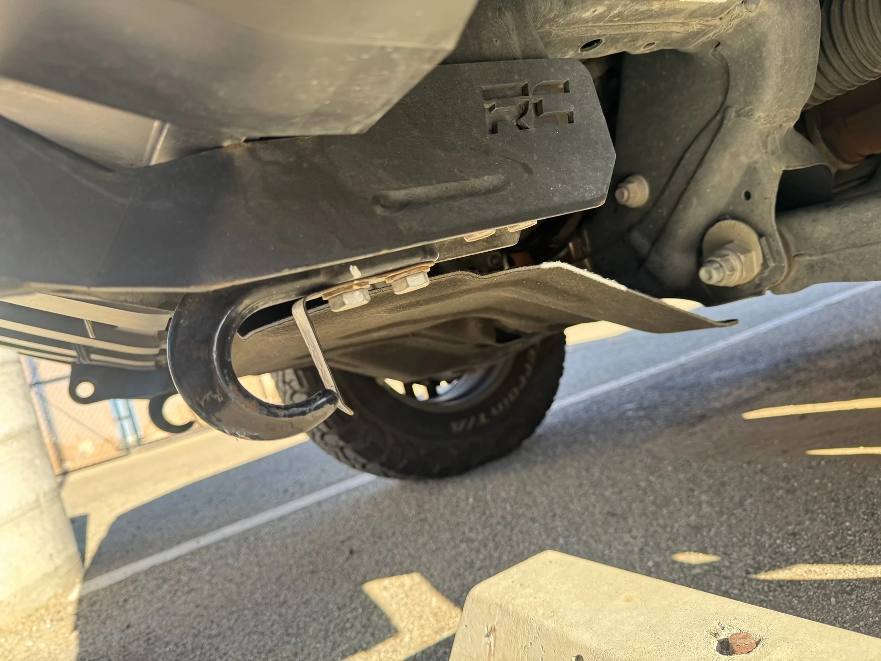

1. The safety chains are connected to tow hooks that are installed on the shackles; coincidentally, the eyelets for the bolts are identical. I don’t recall where I sourced them, but they are pretty generic. I got this pic for Harbor Freight, and it looks identical. All fits nicely and tucked.

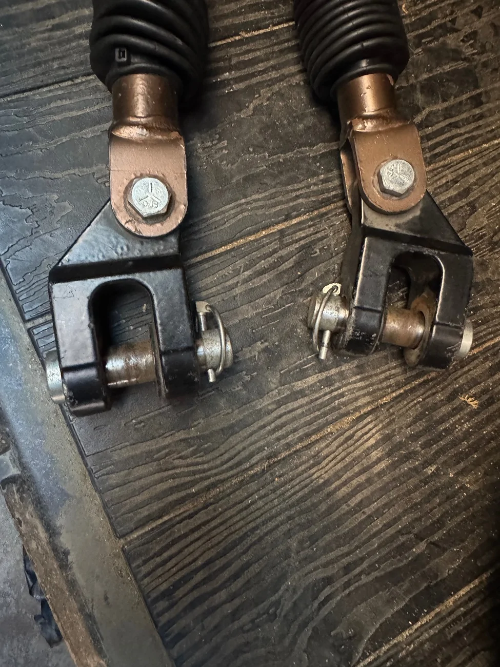

2. I think you are confusing the ½ thickness of the plate for the diameter of the shackles. The pin diameter of the shackles is in fact 7/8”, and I used the blue OX adapter kit with 7/8” pins. They fit like a glove. Let me know if this is what you’re referring to, or if I misunderstood your questions.

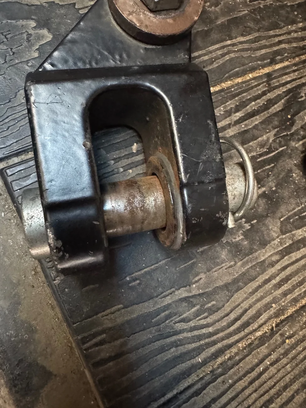

Here are some pictures of the washers I have attached to the mounts. Purpose is to minimize the gap you mentioned. Hope this helps.

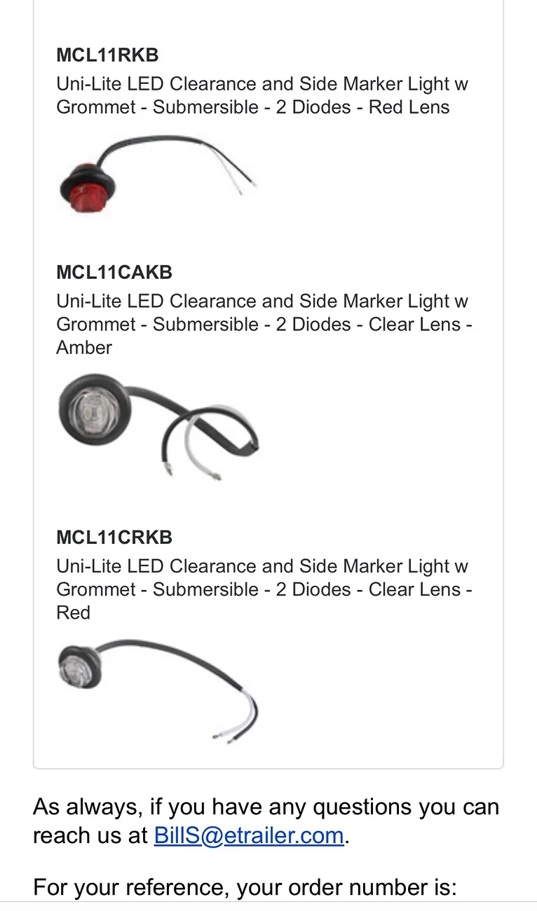

Do you remember what you used for the marker lights?
Here is the list of the markers I ordered from etrailer. All of them have a clear lens, except the three markers that face the rear. Those are red and placed on the center of the truck, also the most rear markers on the rear fenders produce a red light instead of amber. Picture you’re towing a regular trailer and its lights that illuminate at night, that’s how the truck looks.
Besides added visibility, they produce enough light around the truck to keep the monitor of the rear view camera in the RV on “day” mode instead of switching to night mode when traveling in the dark. This way the monitor is not as bright, and the screen is still in color instead of the black/whiteish mode when it switches to night mode.

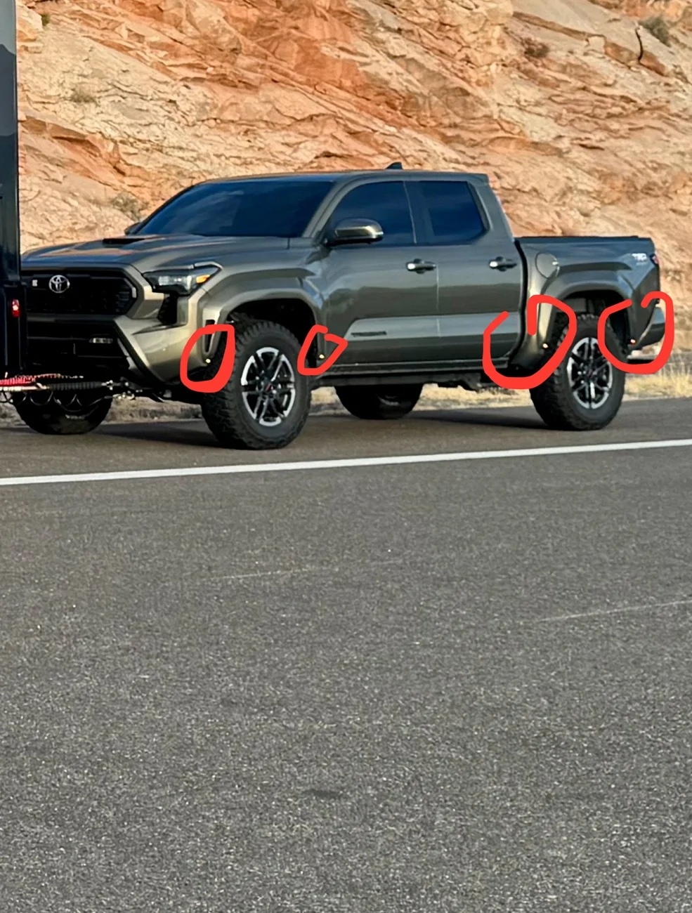

Found this picture on my phone depicting the three red markers to the rear. Again, none of these lights work unless truck is being used as a toad, all lights connected to the wiring going to the taillights and nothing hooked up to the truck.
Originally, I wanted to tap on the mirror lights so they can work as a marker or turn signal, but I ended up going this route. Much simpler.
