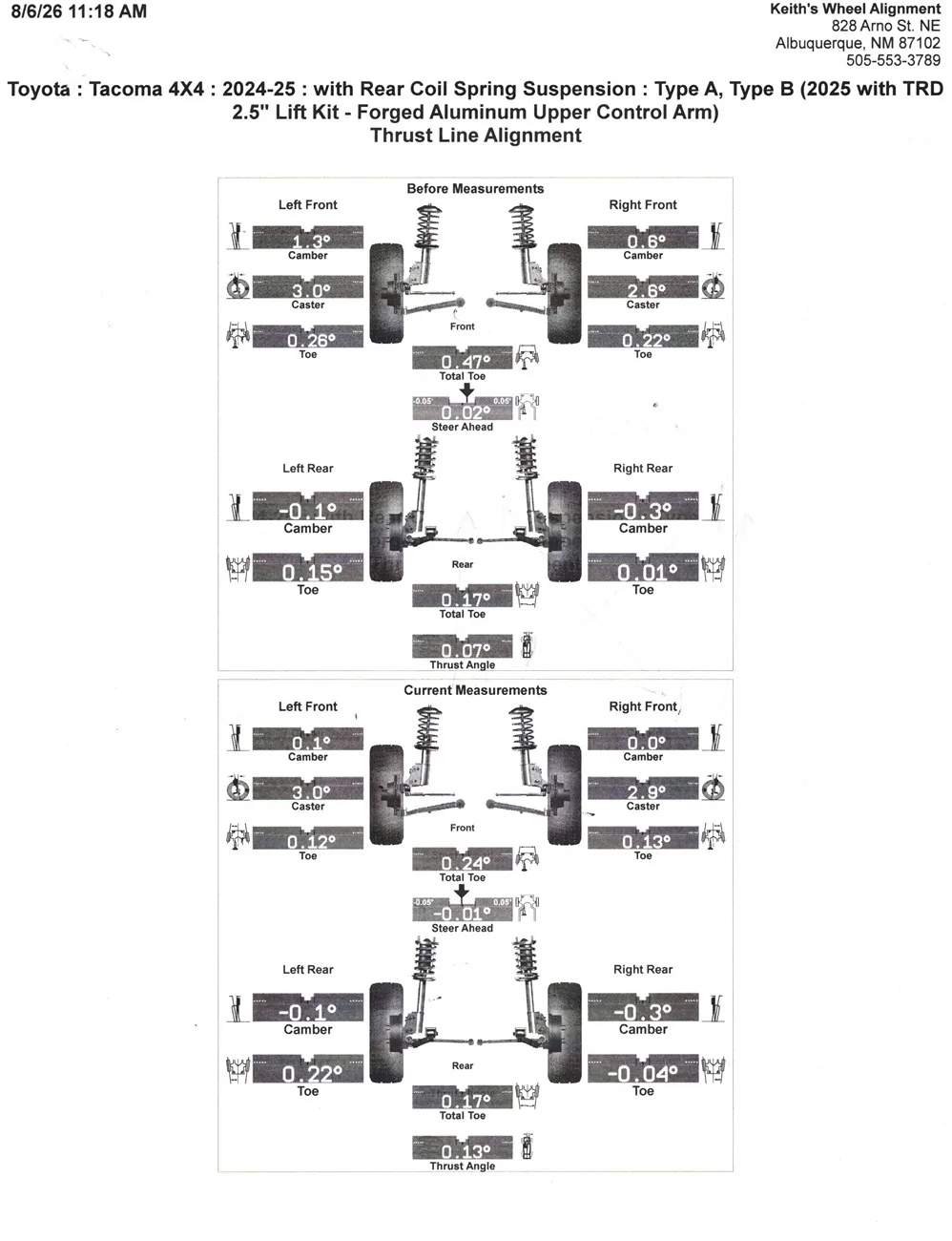

Just wanted to post a heads up for those swapping in expensive new tires. At just 3,000 miles my alignment was pretty out of whack, glad I elected to do an alignment when I put new BFG's.

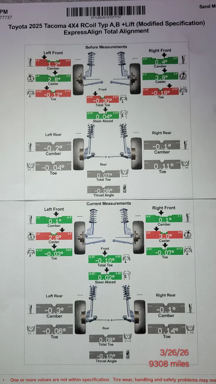

Those post alignment numbers look great to me. I don't care for the positive camber that Toyota allows for factory spec. My alignment guy was able to get mine close to "0" even with front and rear All Dogs springs (1.5" lift). My Truck drive great with these numbers.

Rybern those look great.
Initially I wanted the "Toe" zeroed out. Talking to the alignment guy who races and sets up lots of vehicles, he explained that once you get up to speed the "Toe" is going to splay out. With the settings he set he said that once at speed it will be "zeroed out". (not racing speeds but speeds in general) He has a 3 week waiting list for an alignment and is well trusted in this area so I went with it.
I wonder how its going to actually play out?
