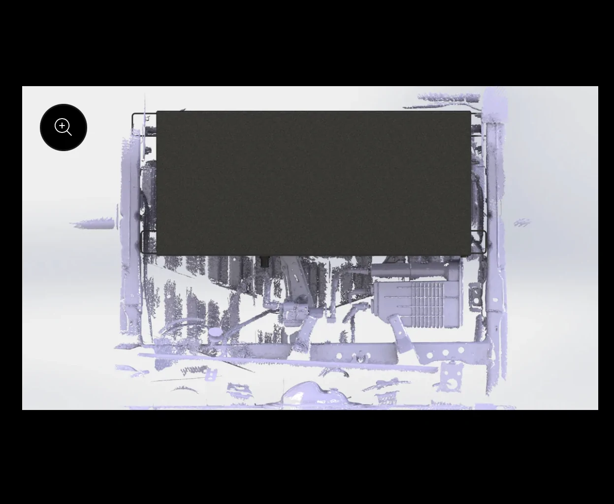

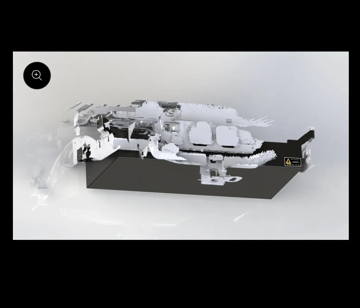

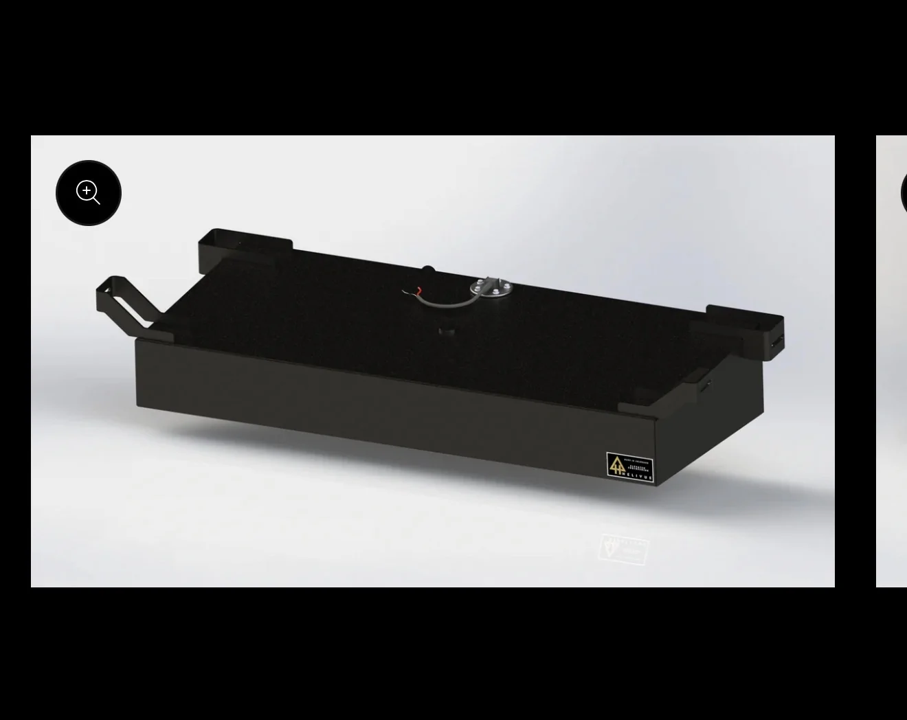

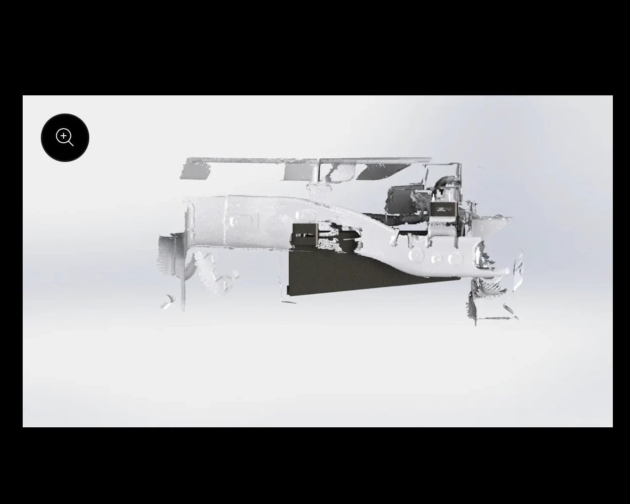

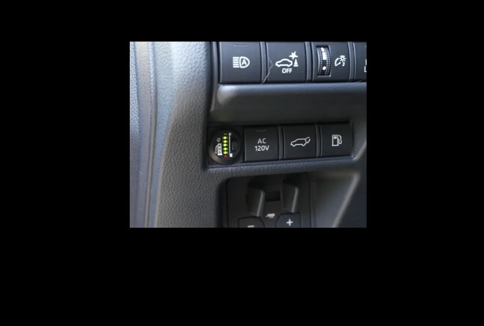

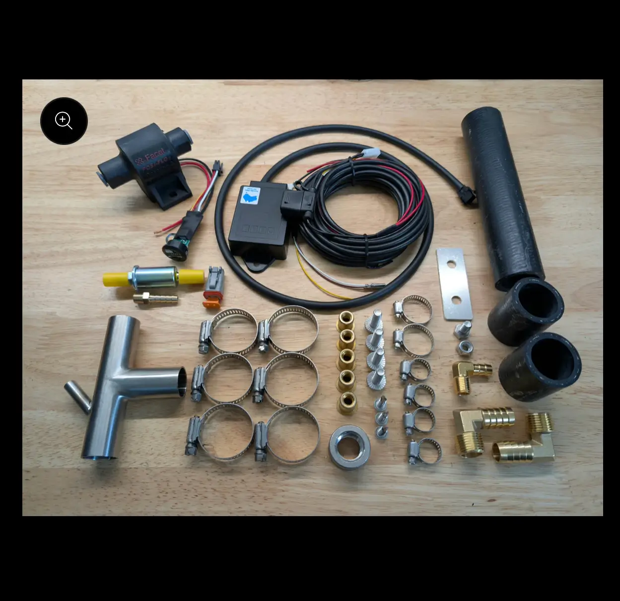

Here’s the info from the site and photos:
“Helivue Design offers a no compromises approach to auxiliary fuel systems for the demands of the Commuter or hard core Overlander. This tank has been thoroughly beat, bashed, landed on and driven from 5,000-13,000 feet regularly without failure. A Lightweight, High clearance, Aluminum 18 gallon auxiliary fuel system that allows you to KEEP your KDSS, Factory Air Ride and your Class 4 receiver hitch. This system is almost completely invisible as it tucks above the bumper line and keeps all factory evap systems in place. The Helivue Design auxiliary fuel tank fills up through your factory filler neck and will simultaneously fill both tanks at once. When you need to transfer fuel we include a high quality programmable Fuel transfer switch/fuel level gauge, quality fuel pump, and stainless steel fuel level sender. Kit includes everything you need to install including quality stainless steel clamps, stainless steel hardware and bung.”
Details:
Tank Type Auxiliary
Weight Dry 25 Pounds
Weight Wet 133
Capacity 18 Gallons
Fill Point OEM Split
Fuel Type Gas
Relocate Spare Yes
Recommended Install Time 5 hours

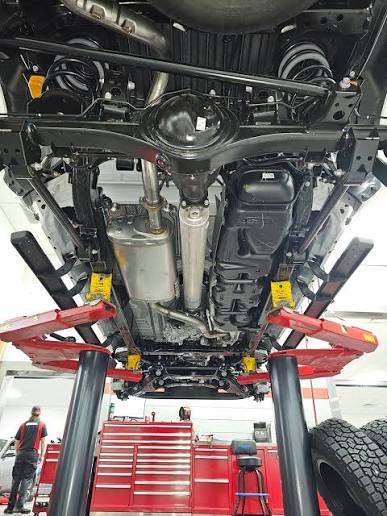

What baffles me, is why Toyota chose to mount the tank on the opposite side of the filler neck then make the exhaust cross over:
2024 Tacoma Helivue Design 18 gal Auxiliary Fuel Tank 1000003109
That's likely what really limits the tanks fuel capacity. I'd have to do some measuring but I'd bet the best solution would be if a company built a high capacity tank that fits on the drivers side, used an extension harness and lines for the factory sender, and rerouted the exhaust to the passenger side where it belonged in the first place.
