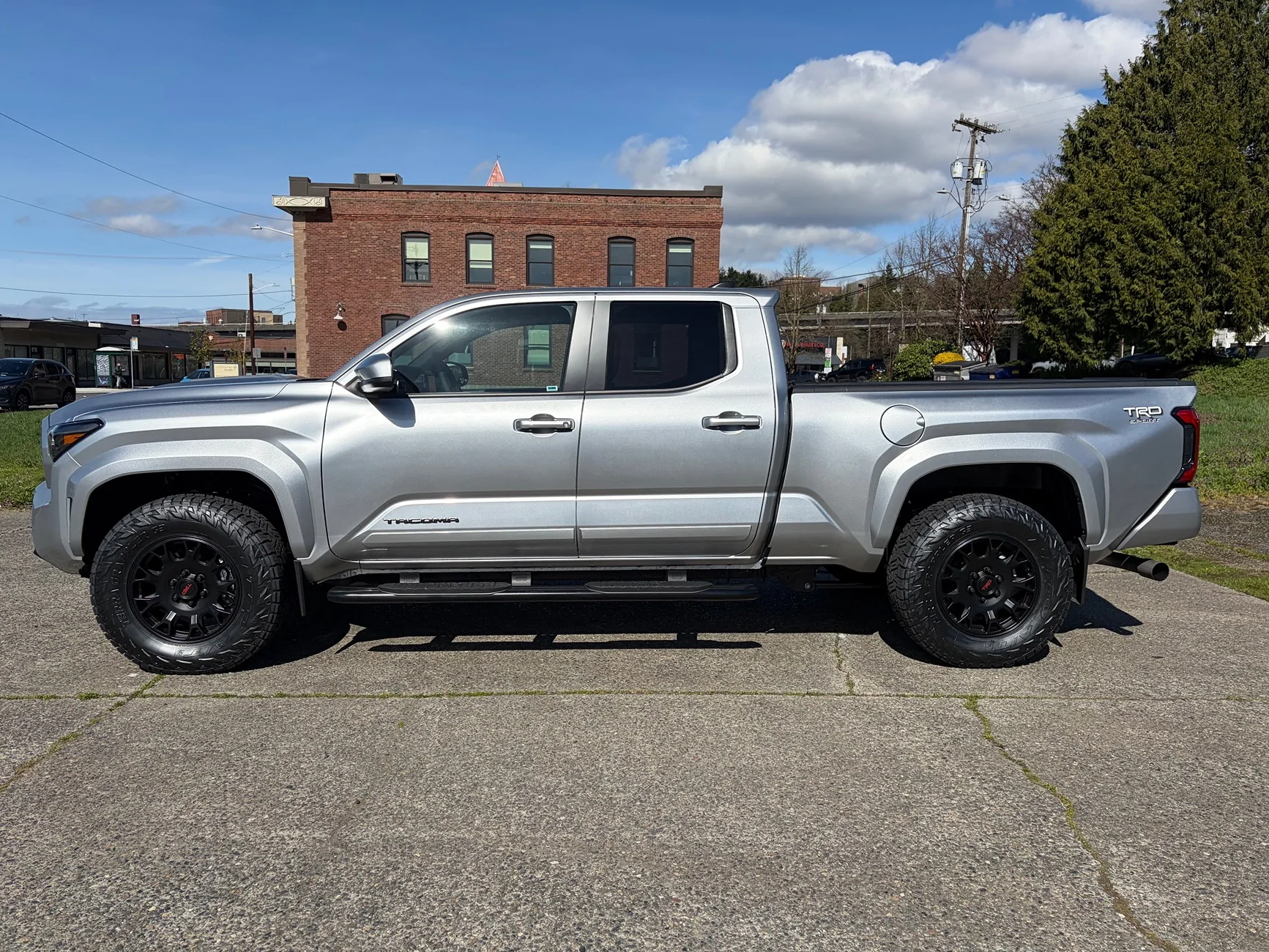

Getting Bilstein 5100 installed at the front this Wednesday. Recommendations on which perch setting? Is getting a rear lift spring necessary? Looking to hit trails this summer.

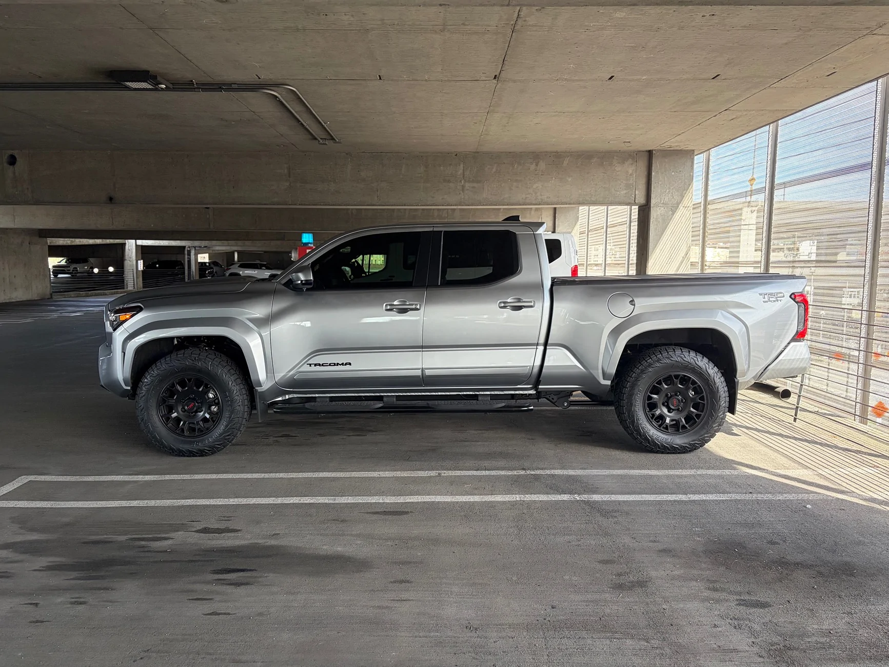

Just read your Bilstein experience and thank you for much needed information. I’ve measured the front and rear multiple times with some discrepancies probably because of surface level
Front:
21” 3/8 or 21” 9/16
Rear:
22” 3/4 or 22” 7/8
That said and with your info, I think I’m going to tell the shop to install at 1” or the lowest perch. The rear is very close to 23”, Does the rear squatted when you loaded stuff in the bed? I currently have 2 sandbags(50lbs each) on left/right wheel well. The truck have about 950 miles so I wonder if will still settle more?🤔

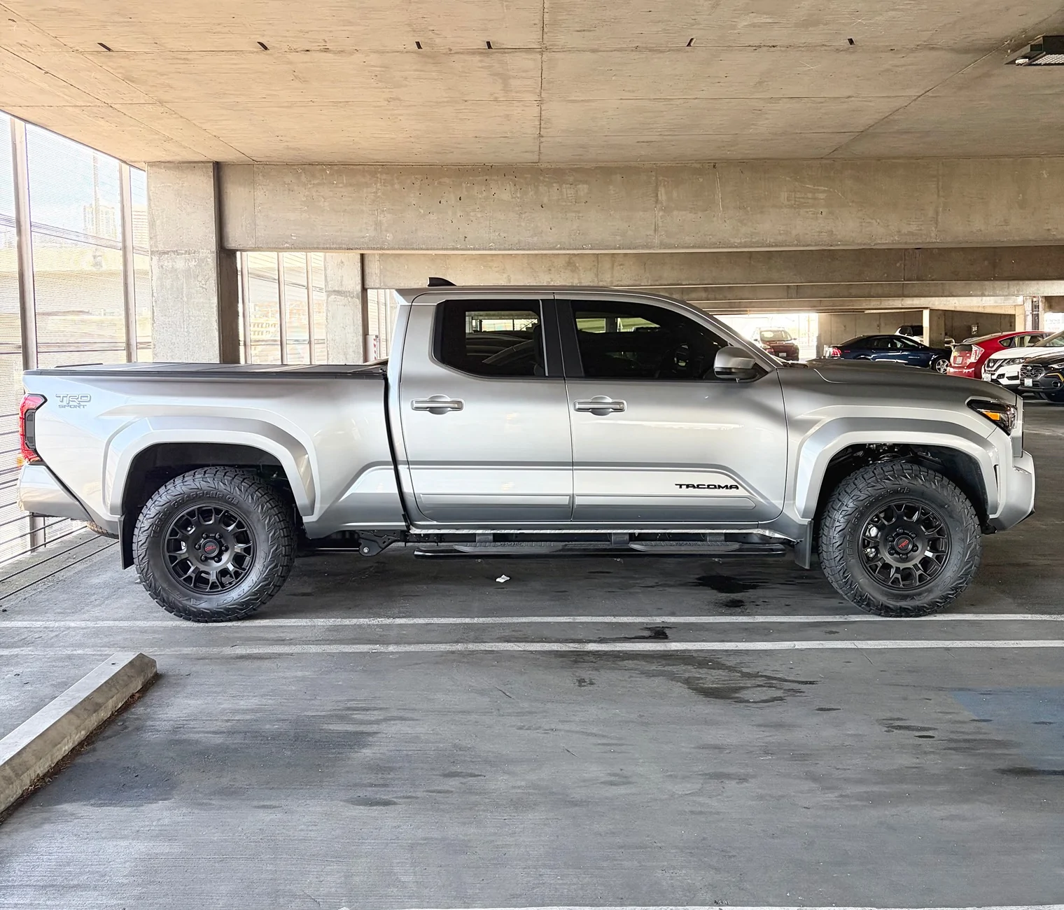

That was a lot of reading. And yeah I’ve been on the Facebook page “tacoma 4th gen owner” and most posts I’ve dug up has different perch setup like you said. Even at this I’m thinking of pulling the trigger on 6112/6100 Bilstein front and rear but I don’t know.
My initial plan was just to level it and have a “better” shocks for trails I want to try out, nothing crazy since this truck doesn’t have a locker. But wow trying to find the sweet spot to lift the front seems like a trail itself🥴🤣

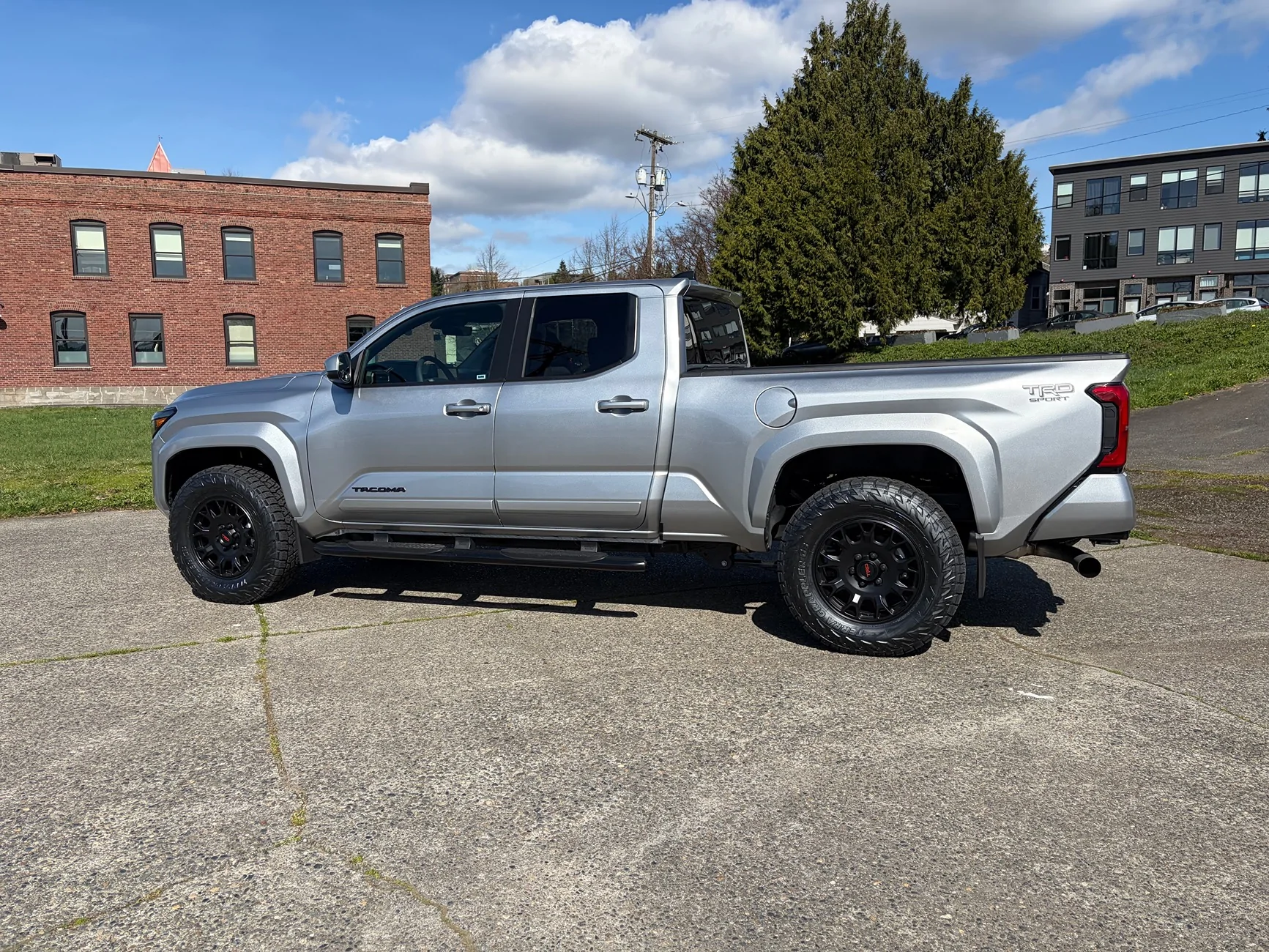

in this photo you can see the rake more

I’m going to do the 1” on the fronts just like you’ve mentioned. With the measurements I’ve gotten from front and rear, going more than 1” on the front will definitely make it nose high.
