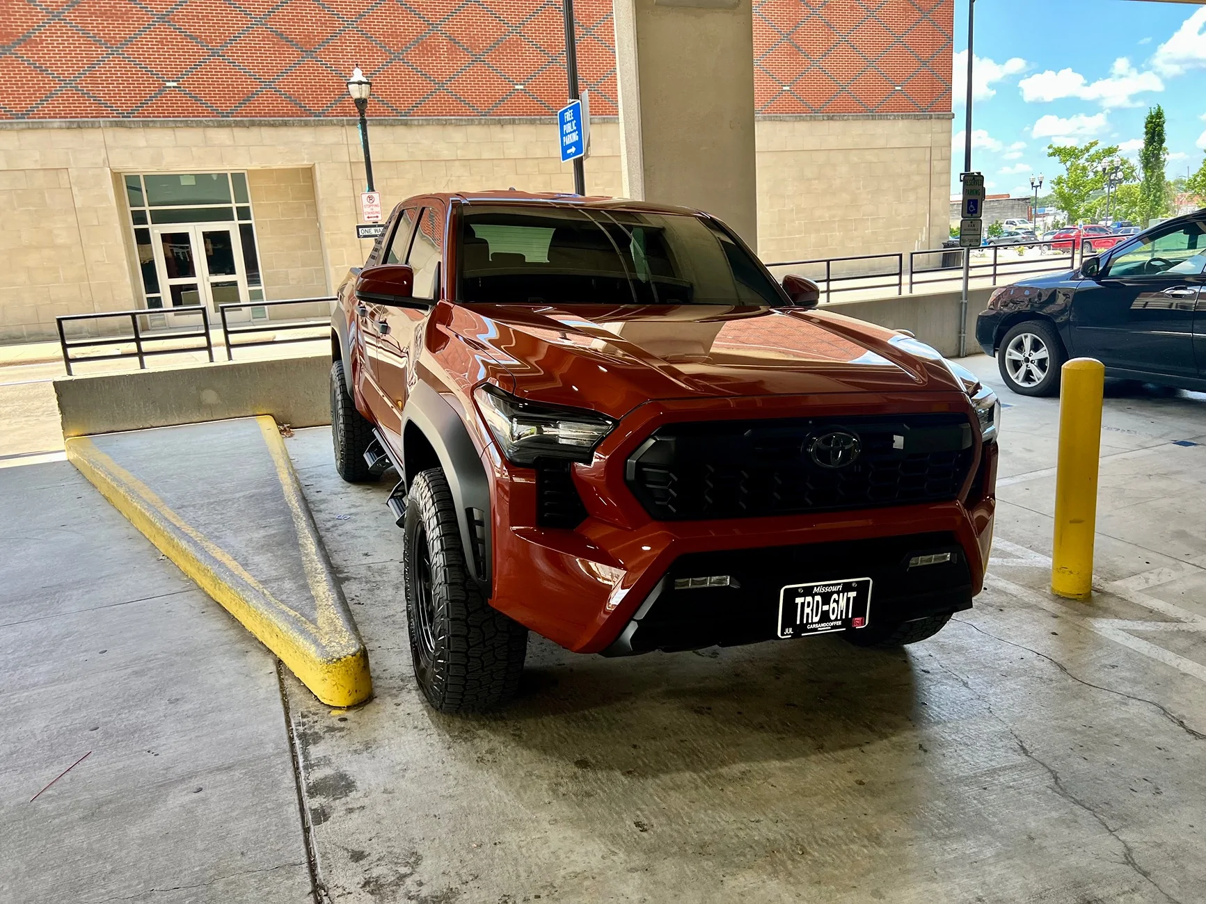

I am running +35 on mine, perfect amount of poke.
yea seems +25-35 is the sweet spot. Just hell finding what I’m looking for without having to make it a multi step process lol
