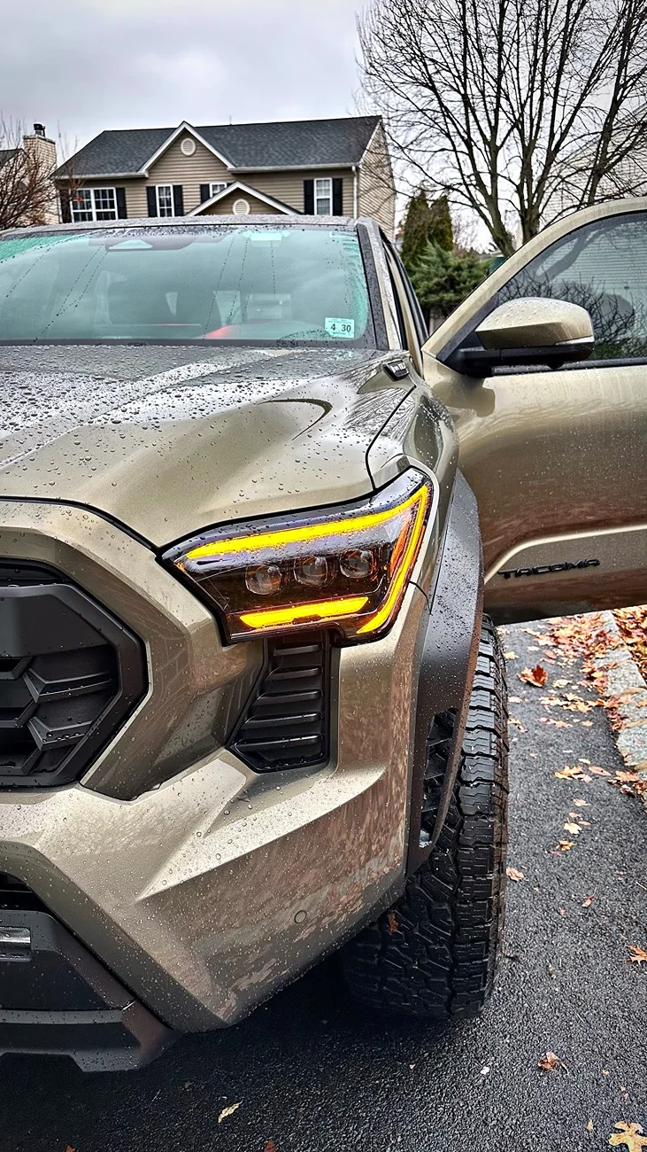

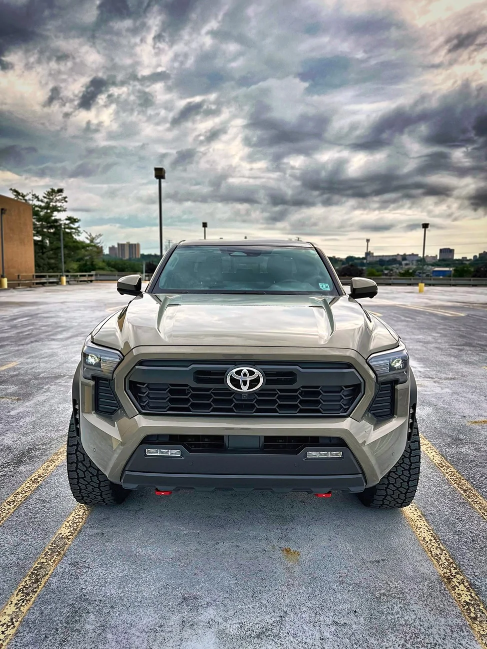

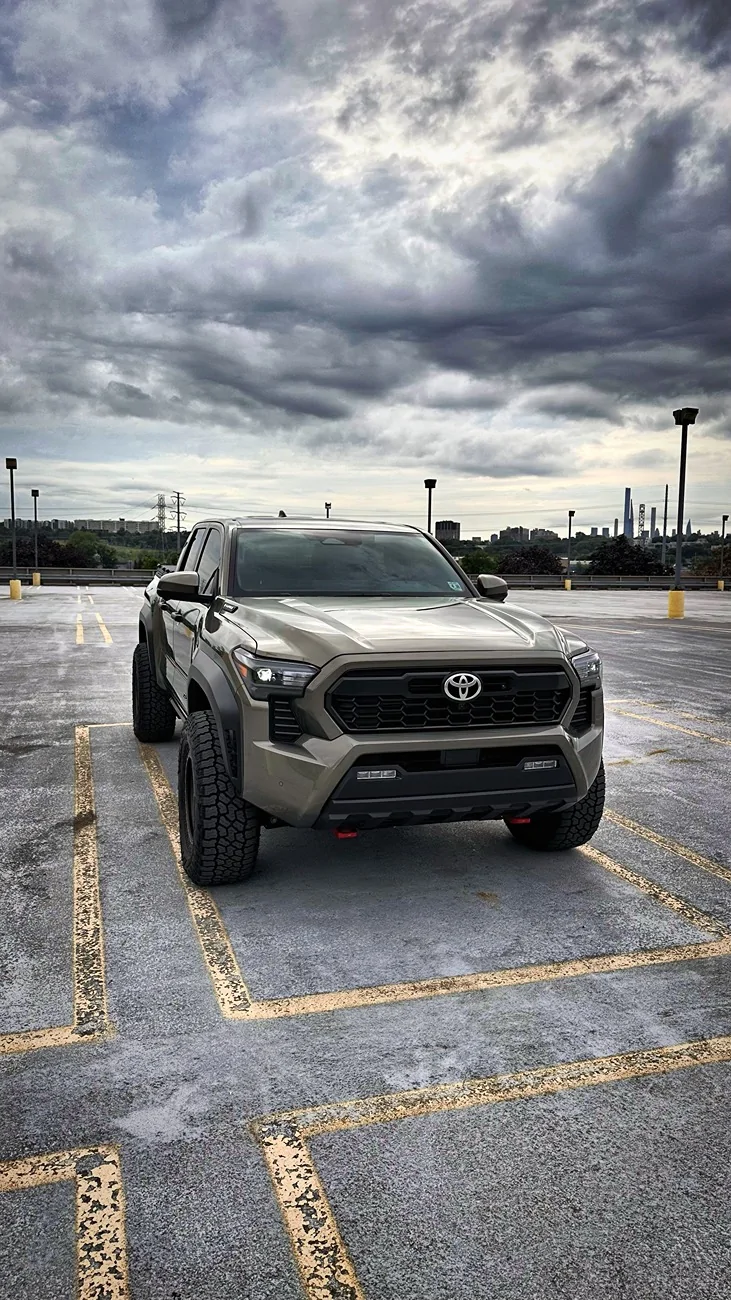

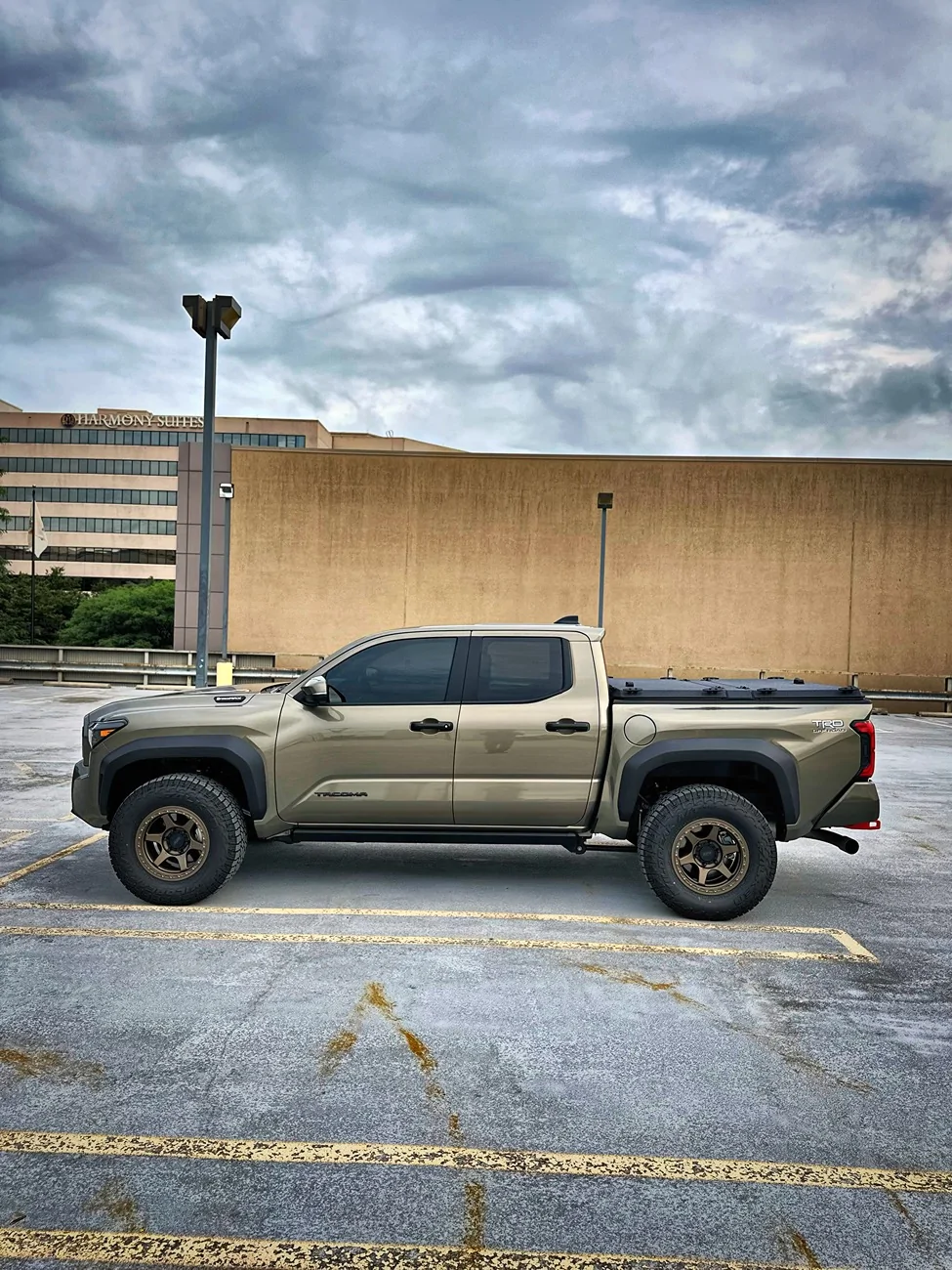

This is zero offset. Expect about 1.7 to 2 inches from the offroad fenders depending on tires (more aggressive treads will be even more poke). Mine is 285/70/17 on trd off-road hybrid stock suspension no lift at all. From what I’m reading the hybrid trucks are slightly more lifted than standard turbo engines due to the extra weight. I didn’t remove the crash plate and this is the reason I went with 285 size instead of 315. I’m not sure but you may need to remove the plate.
