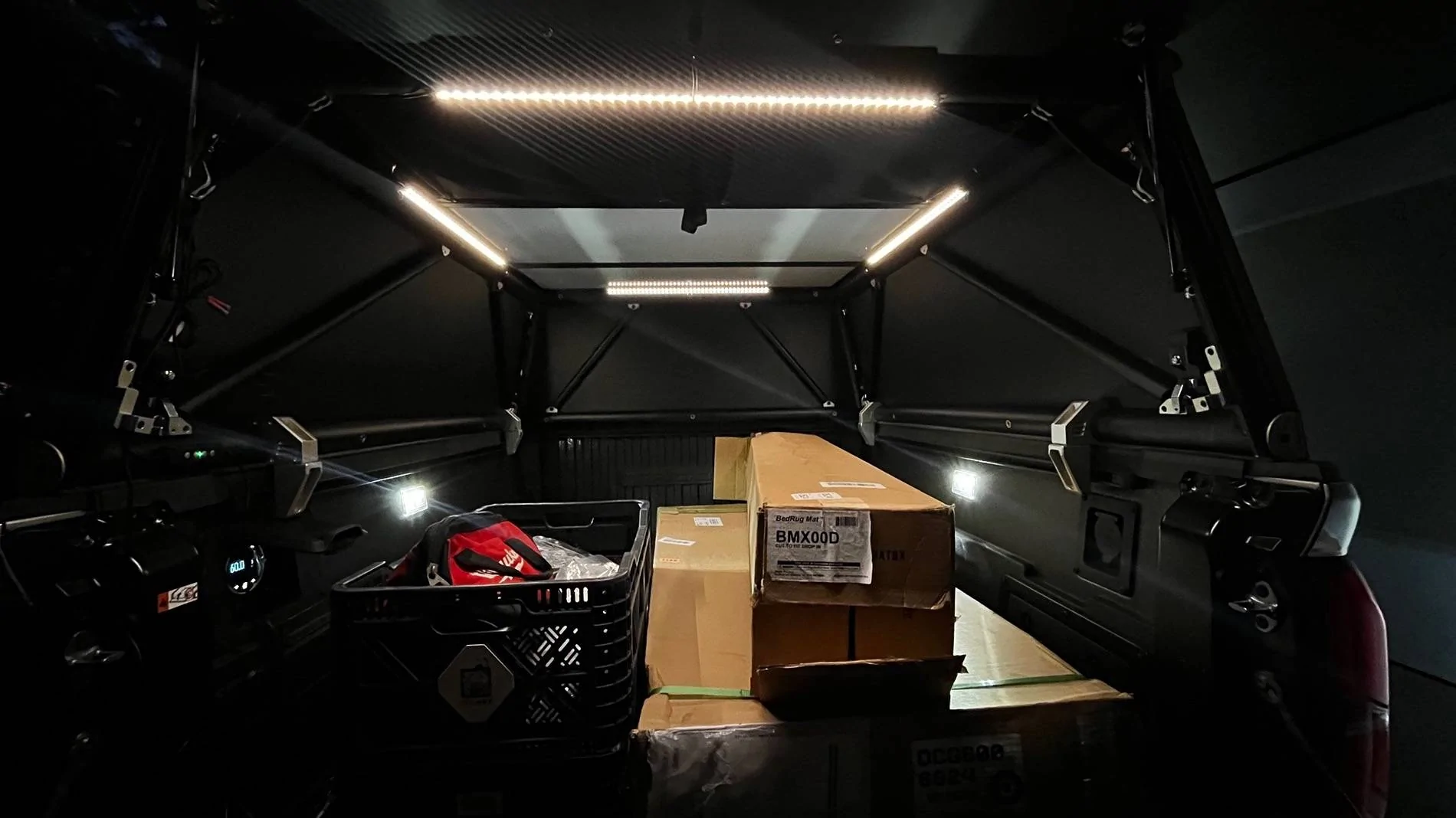

one final note on the power ports for the DC side: the compressor is powered by the main engine battery / but the power ports (12V & USBC) strangely enough are powered through the inverter / generator mode - discovered this by supplying power to my GFC lights & other scenarios. I think that mapping was a missed opportunity; the bed scene lights are main engine battery (Trailhunter), it would make sense to have a 12V bed port to run basic low-draw accessories such as lights off the main engine battery & avoid that periodic engine kick-on via generator mode. Tempted to reroute it down the road...
1st world problems. But all things being equal, a really great power suite on this rig.

Yep - accessory mode allows you to run the 12V ports without running the 120V inverter. So the mapping is more nuanced & thorough than ppreviously thought. One additional lesson learned was an attempt to run “accessory mode” for extended periods until main engine battery cut off (with theoretically enough reserves to restart). But what happened was I drained my engine starter battery and effectively stranded myself (albeit in the driveway). I trickle charged the battery w/my power station, but my truck coded w/errors for 1.5 days. So a word to wise: there’s an initial accessory mode cutoff/timer. That’s a warning to start the vehicle. You pull energy past that point you run the risk of stranding yourself needing a jump.

I have a quick disconnect option for my GFC lights, I can run them from 4 sources: the 12V power port (which is essentially accessory mode or (120v inverter mode) on the TH bed; also through the aux port 1 in the rear which shares a Baja Designs rear hitch pod light (aka accessory mode and/or 120v inverter generator mode, I wired the pig tail in the rear for these lights); can run them from a single Milwaukee battery with a ~$30 step down converter (18v to 12v) or my power station (camping trips). For most quick lighting situations at night the Milwaukee battery w/step down seems to be the easiest. Can leave the truck off and unload/load gear as needed.
