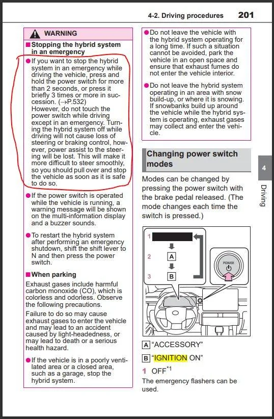

Does anyone know if the "EV mode" works on the Tacoma? Apparently you you hit the start button 2x (no brake), then foot on the brake and hit start a third time...then you can move the truck slowly in electric mode only. Also...if and when you are slow speed driving (parking lot, etc), and the engine shuts off...does it emit an artificial "presence sound" to the exterior?
I would try these things myself, but it's too cold right now for any of the hybrid features to truly enable normally
I was reading that earlier in the manual, isn't it to turn off hybrid mode instead?
