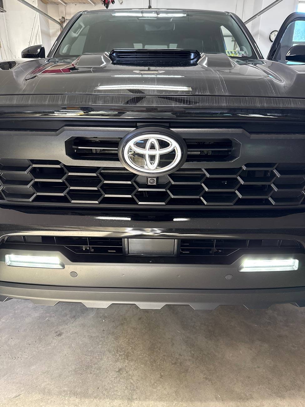

Yeah, i installed mine a few months ago. I like it.

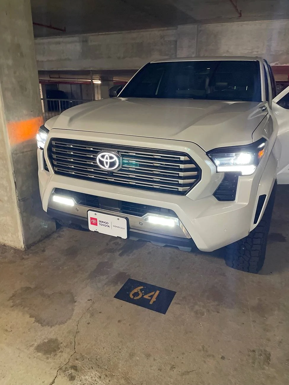

It's the turn signal bulb plug. Just unplug it, plug in supplied cable and replug the bulb. Fairly straight forward. I installed mine 2 weeks ago.

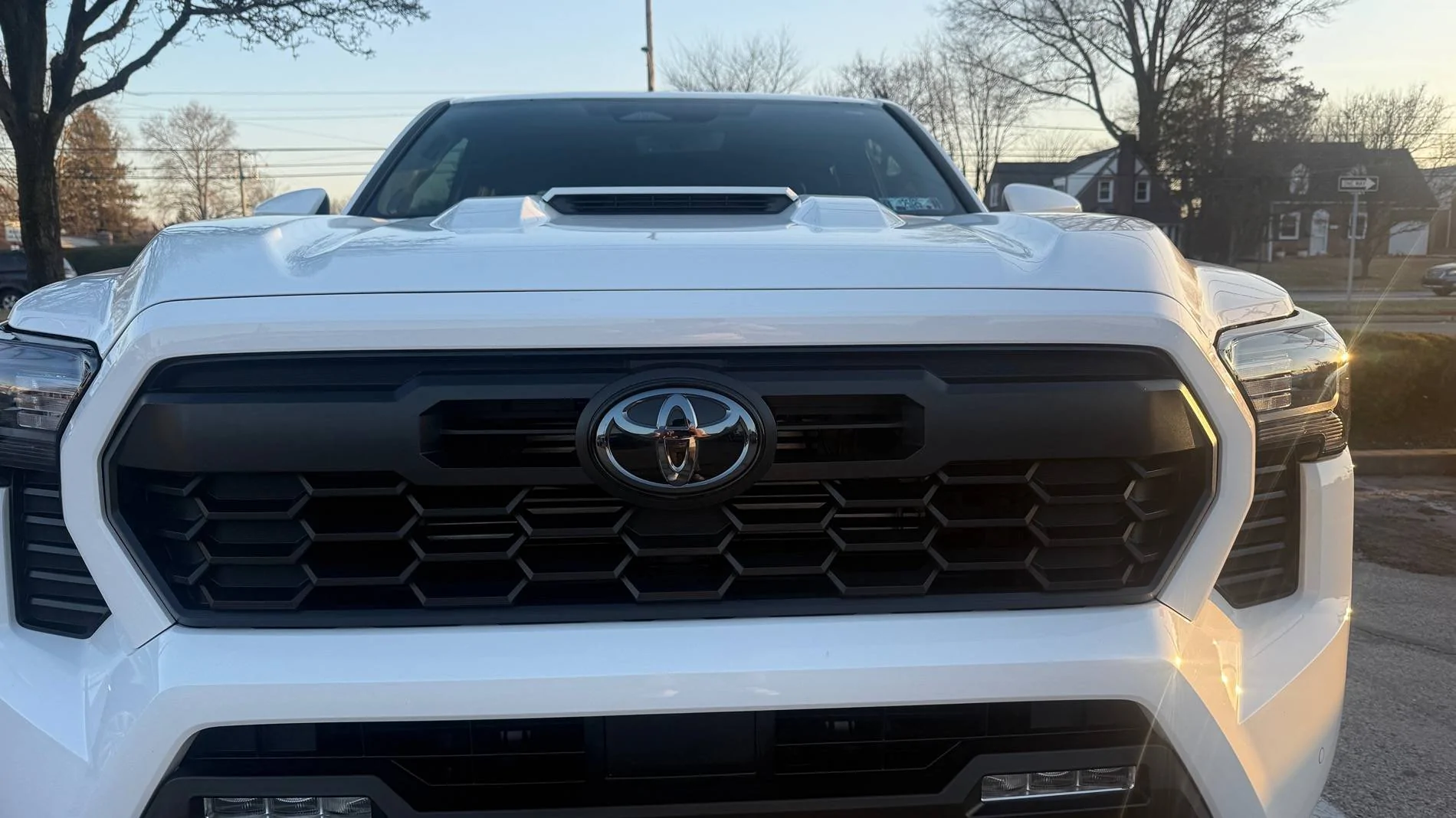

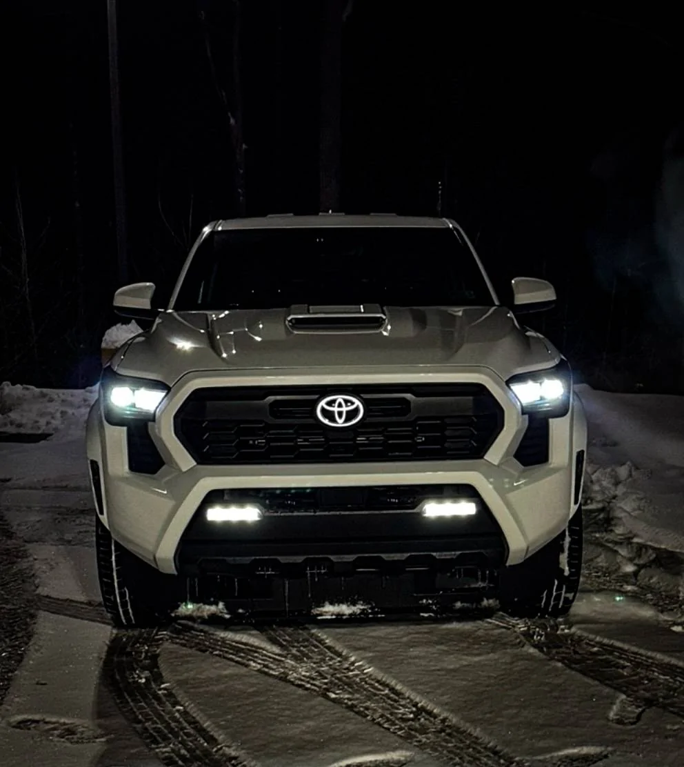

I have the illuminated OEM emblem on my black 25 TRD Sport. Everything is blacked out except for that emblem and I wish it was black also. Looking for an overlay that may cover it but allow for the light to pass through. I will take a pic of the emblem at night with the lights on.
2024 Tacoma Illuminated Front Toyota Emblem (PT413-35240) - anyone install on front grill yet? image
certified.lover.b
Feb 21, 2025
32
Pennsylvania
2024 Tacoma TRD Sport+
there's also a black chrome option, thats the one i went with and it blends in pretty nice.
