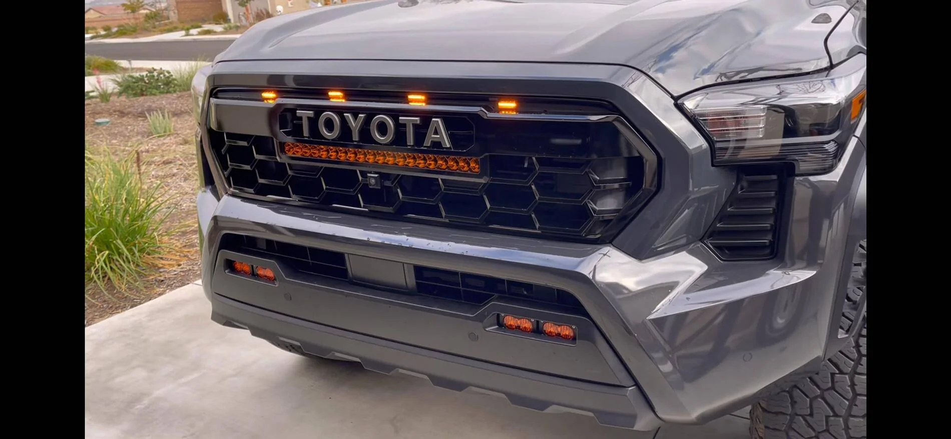

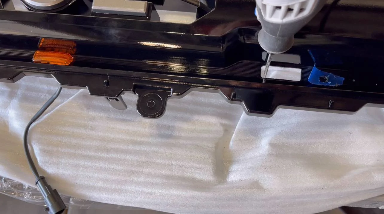

I finally received the TRD Pro grill after a 40 day wait due to back order. I did my research while waiting and decided to go with the Heretic light bar instead of the Baja or Diode. The Baja option you need to trim some plastic of the grill in order for it to fit properly, something I didn’t want to do in case I wanted to swap out the light bar in the future I needed all the grill mounting points to be uncut. The Diode bar is 18” inches, when installed it leaves a 1” inch gap on both sides which didn’t look OE to me. The Heretic light bar was an exact fit for the grill, no need to cut or anything. You can buy the brackets from Rave Off Road but I think they only sell as a kit not sure if they will sell only the bracket.

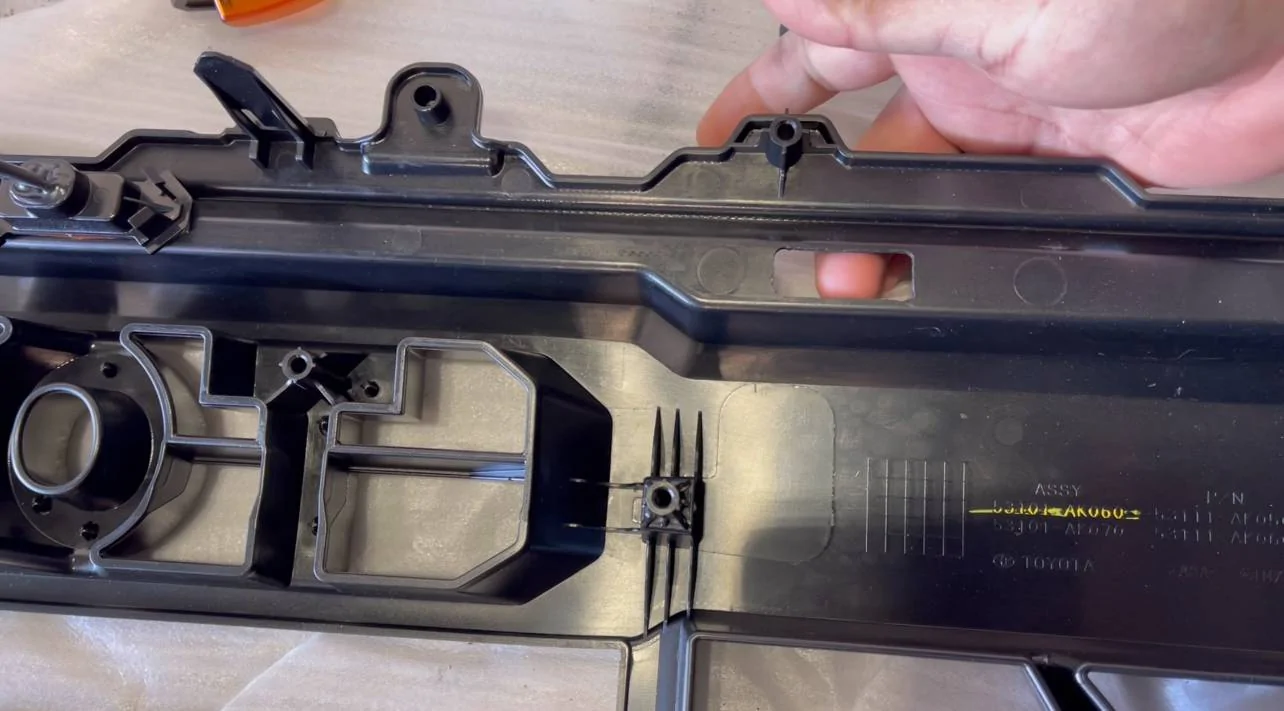

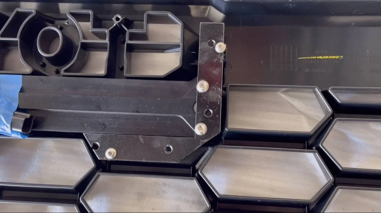

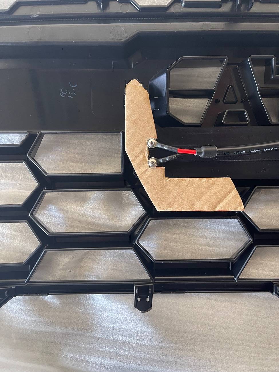

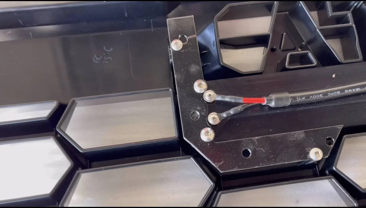

Light bar mounting

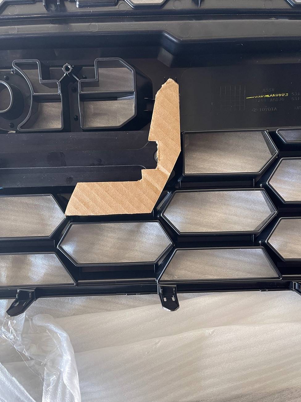

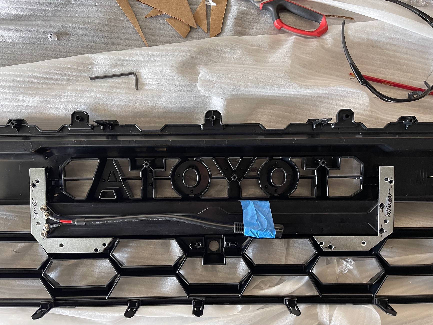

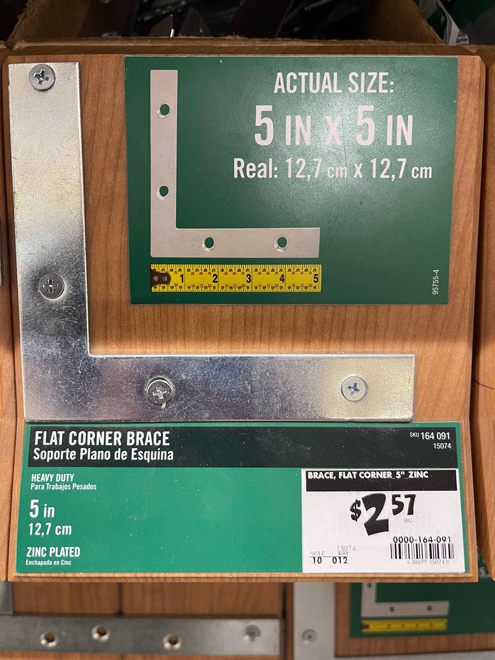

I decided to make my own brackets since the mounting points are pretty simple. I started with a piece of cardboard and began cutting until I was able to match all the mounting points from both the grill and light bar. I went to Home Depot and bought two 5 inch L shape brackets and cut them accordingly. I just sprayed painted them black to avoid rust and to give it a cleaner look and done.

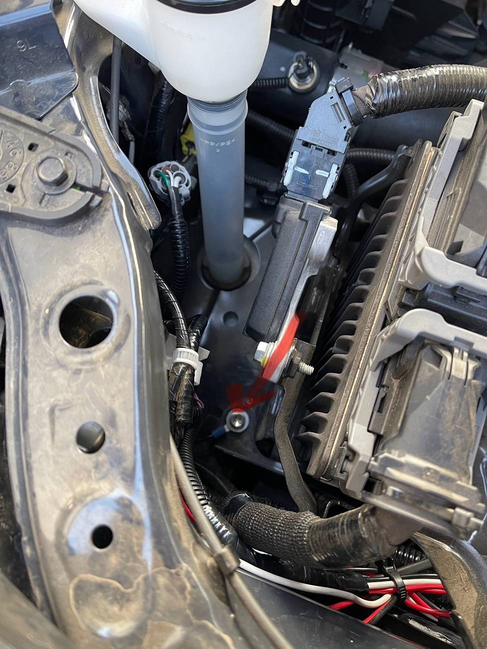

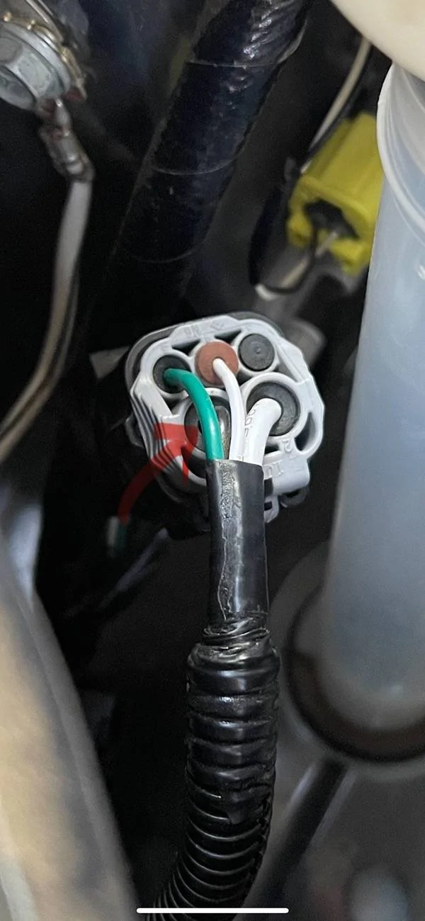

Light bar wiring
I wired the light bar into my factory 15 amp Aux switch. The factory pigtail is located next to the windshield washer fluid reservoir, it’s the all black cable within the pigtail. The light bar only had 2 wires a positive(red) & ground(black). I just had to connect the positive from the light bar to the black wire in the pigtail, then connected the ground from the light bar to a grounded screw nearby.

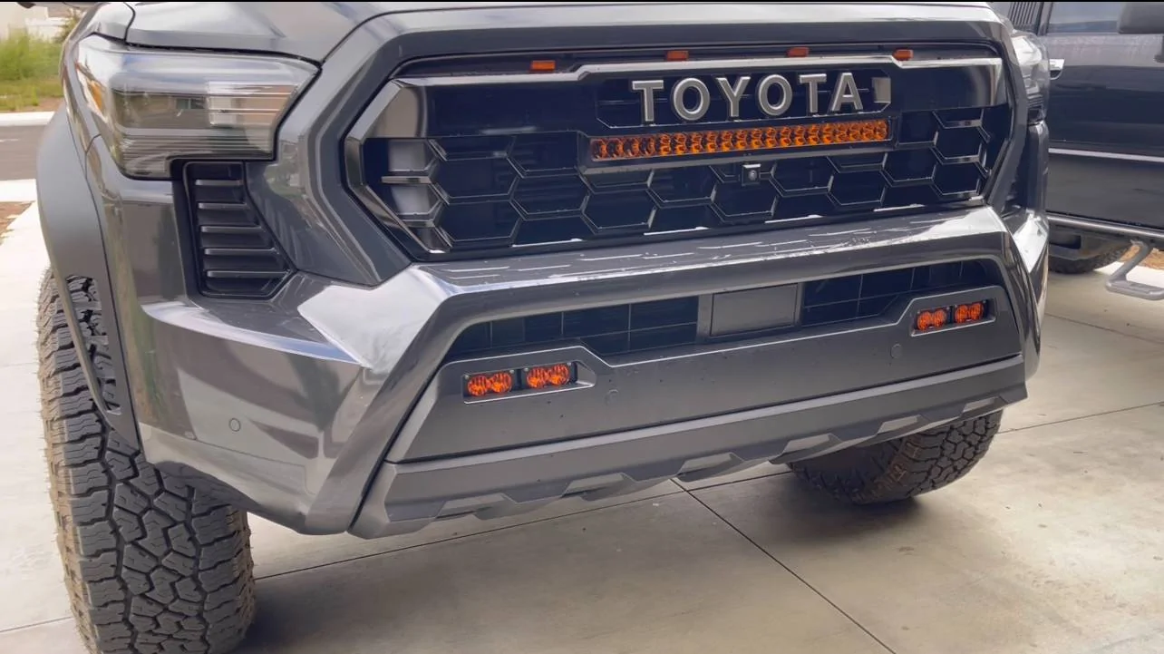

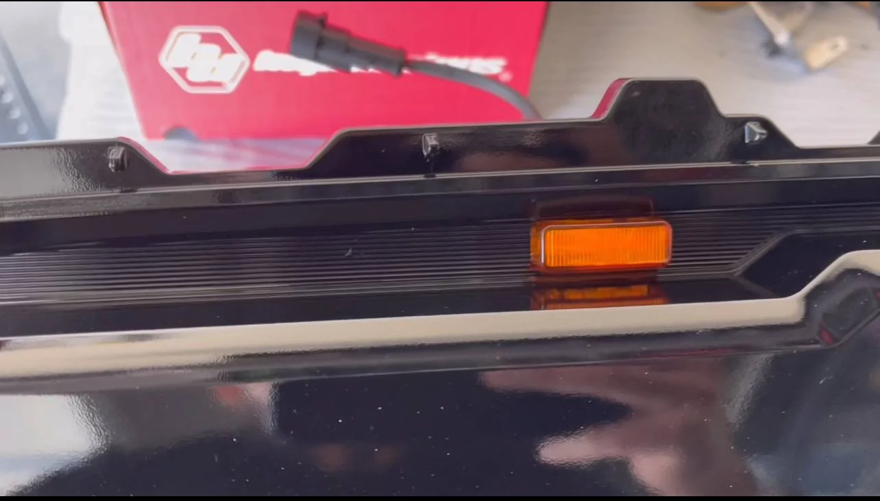

Baja S2 sport Baja S2 sport

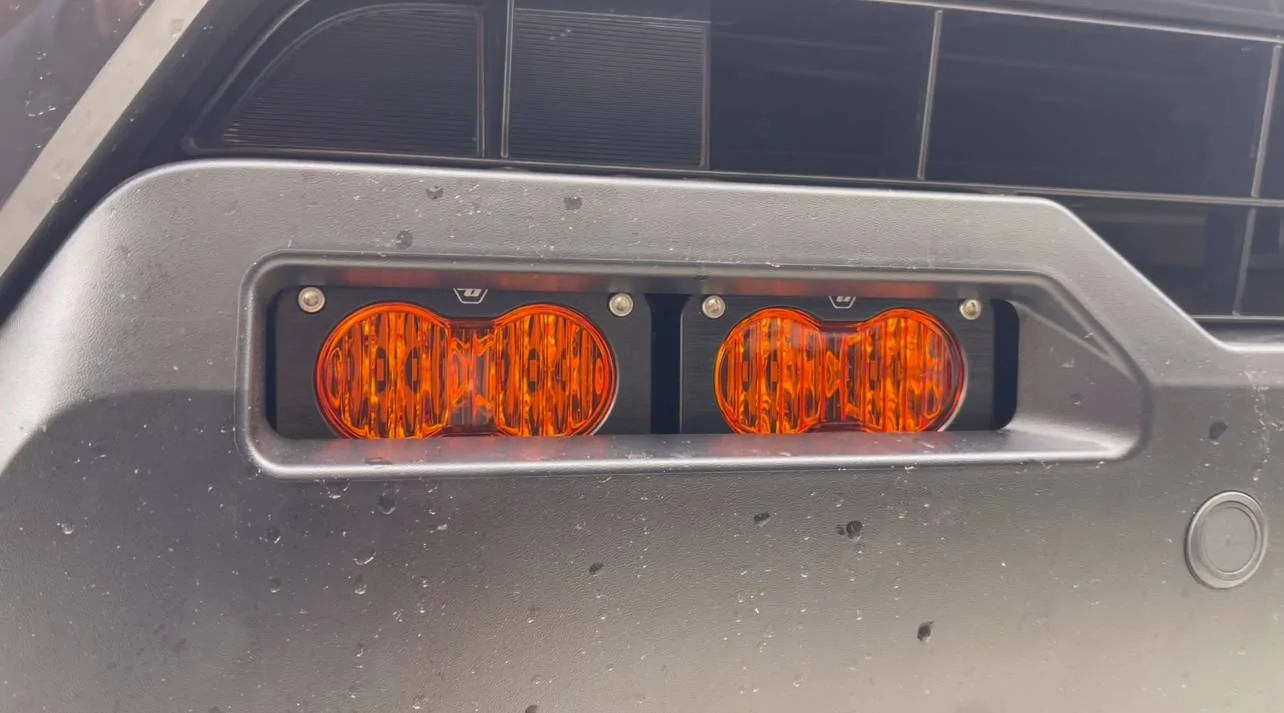

I decided to go with the Baja S2 sport because of the serviceable items and interchangeable lens. They were a bit frustrating to install because of all the assembly required since you pretty much need to assemble your own kit from the package Baja sends you. The wiring Baja provided made that part simple and easy. It all plugged into the original harness which your able to turn on/off the lights by using the original fog light switch.

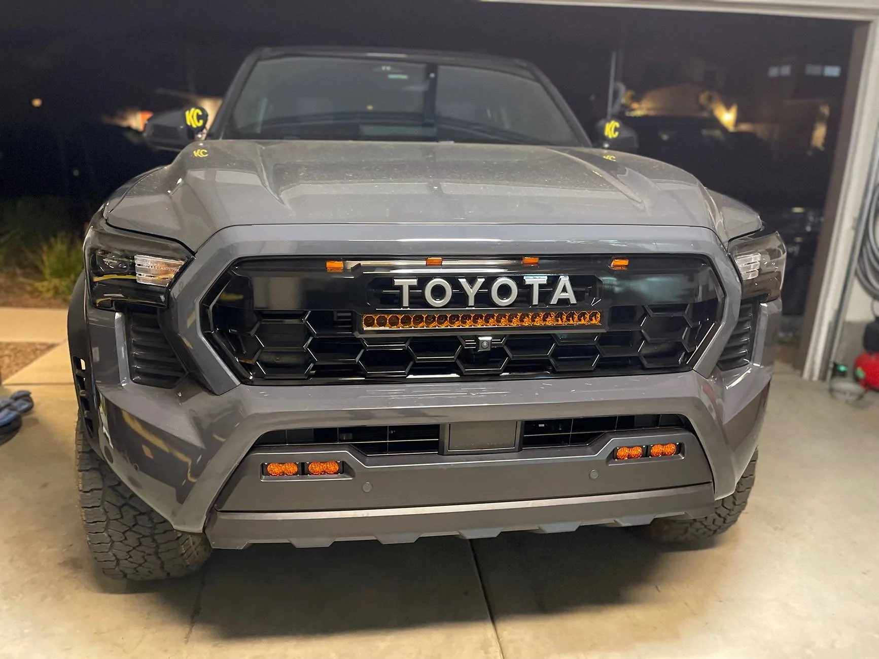

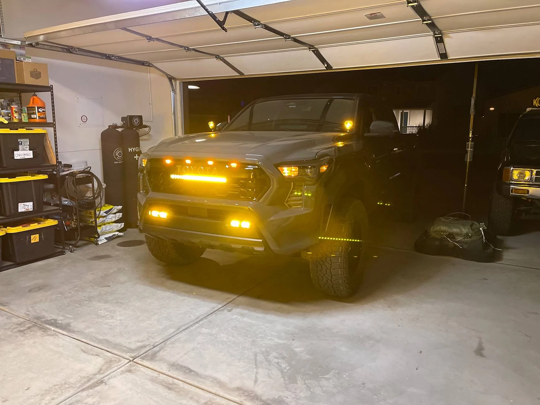

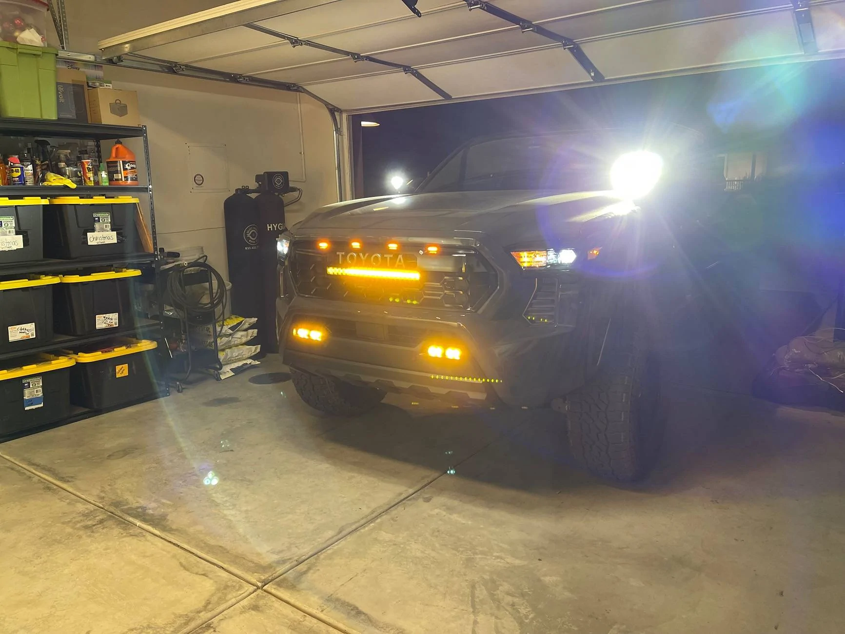

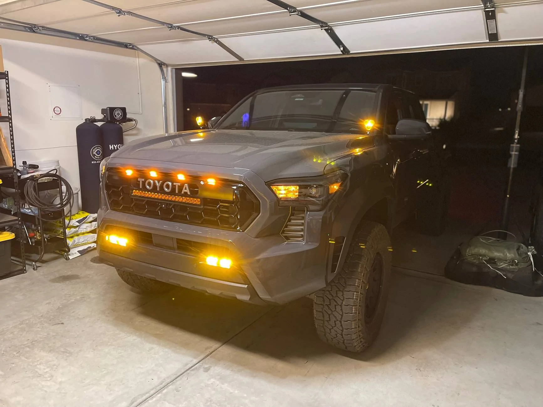

Outcome
2024 Tacoma Installed Heretic light bar, Baja fog lights & Raptor lights in 2024 Tacoma TRD Pro grill IMG_6011
2024 Tacoma Installed Heretic light bar, Baja fog lights & Raptor lights in 2024 Tacoma TRD Pro grill IMG_6039
2024 Tacoma Installed Heretic light bar, Baja fog lights & Raptor lights in 2024 Tacoma TRD Pro grill IMG_6013
2024 Tacoma Installed Heretic light bar, Baja fog lights & Raptor lights in 2024 Tacoma TRD Pro grill IMG_6016
2024 Tacoma Installed Heretic light bar, Baja fog lights & Raptor lights in 2024 Tacoma TRD Pro grill IMG_6021

Did you use the factory pigtail (the things in the bag) or did you cut the harness wires you are showing? Also the thick white w/ black stripe is a ground wire in the harness. Is it better to ground to body vs using the harness ground wire? I'm still trying to learn about these AUX harnesses for future projects.
Yes I did use the pigtails that came in the bag, it makes the install easier & cleaner. Unfortunately I used all the 3aux switches in the truck. Any other add ons will have to be ran the old school way or I might just run one wire to the cab for an Auxbeam switch panel. The harness you saw was from the KC lites, I had to run them to the same pigtail. The pigtail ground is good but you still need to ground every individual accessory to the chassis to make sure you have a good connection at the nearest bolt closest to the accessory. If not you would have to run the ground wire from every accessory and connect to the thick white w/black stripe cable in the pigtail. What I did was grounded the thick white w/black cable from pigtail and grounded it to the frame. All the accessories were also individually grounded to the chasis near them.

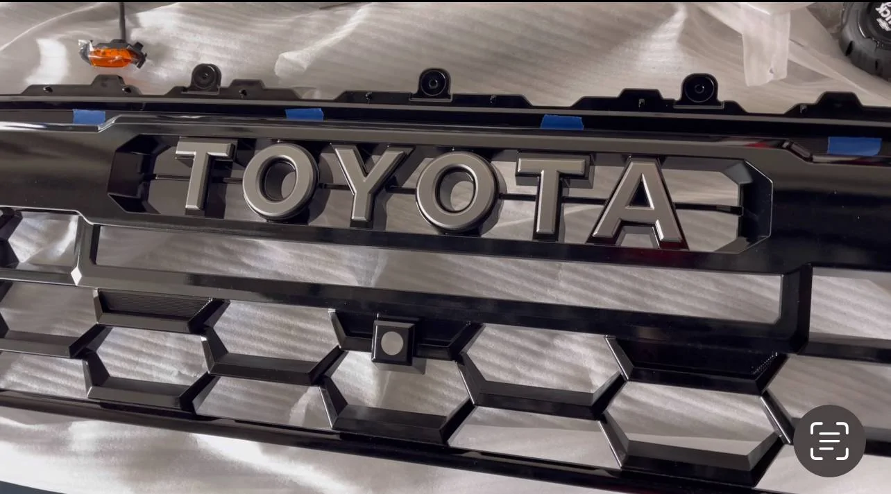

Hey @UndergroundTRD. Did your model have the front face camera? Mine doesn't. Looking for a solution to plug up the hole with something that looks good. Obviously you remove the heretic, metal mounting brackets right (found on the sides of the light bar)?
I would buy a used camera works or not and plug that hole. No better way to cover it than a camera, nobody would question it and it’ll look factory. I did remove the side brackets from the light bar.

2024 Tacoma Installed Heretic light bar, Baja fog lights & Raptor lights in 2024 Tacoma TRD Pro grill IMG_6227.HEIC
A buddy of mine printed a plug for that camera hole……
Would you/your buddy be willing to share the printing file? What type or filament was used? I’m new to the 3D printing world.
