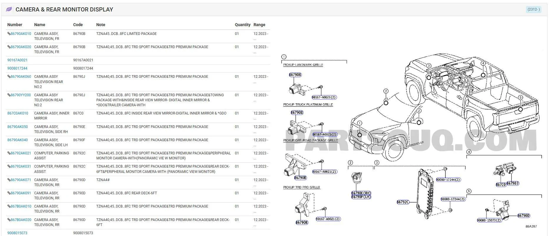

Thank you so much. I already have the 14 inch screen. I found the camera parts but as I look at it, I will also need to update my grill, the rearview light/camera assembly, side mirror assembly just to name a few....
I forgot that the 14" JBL system could be included without the Premium Package!
Now the big question is which wire harnesses your truck has. This could be much easier than I thought.

I'm looking into adding the Multi-Terrain Monitor (MTM) system to my 2025 Tacoma and wanted to see if anyone has gone down this path already.
My truck has the JBL audio package and the 14" display, but it did not come equipped with MTM. I recently installed a TRD Pro-style grille and noticed what appears to be the factory connector for the front camera already present behind the grille.
After digging through wiring diagrams and parts catalogs, it looks like the camera ECU/module that receives the camera feeds and sends them to the display may use the same part number across multiple trims. If that's the case, I'm wondering how much of the MTM infrastructure is already present from the factory.
My next step is to verify whether the wiring for the mirror cameras, rear camera, and center console camera switch is already installed.
