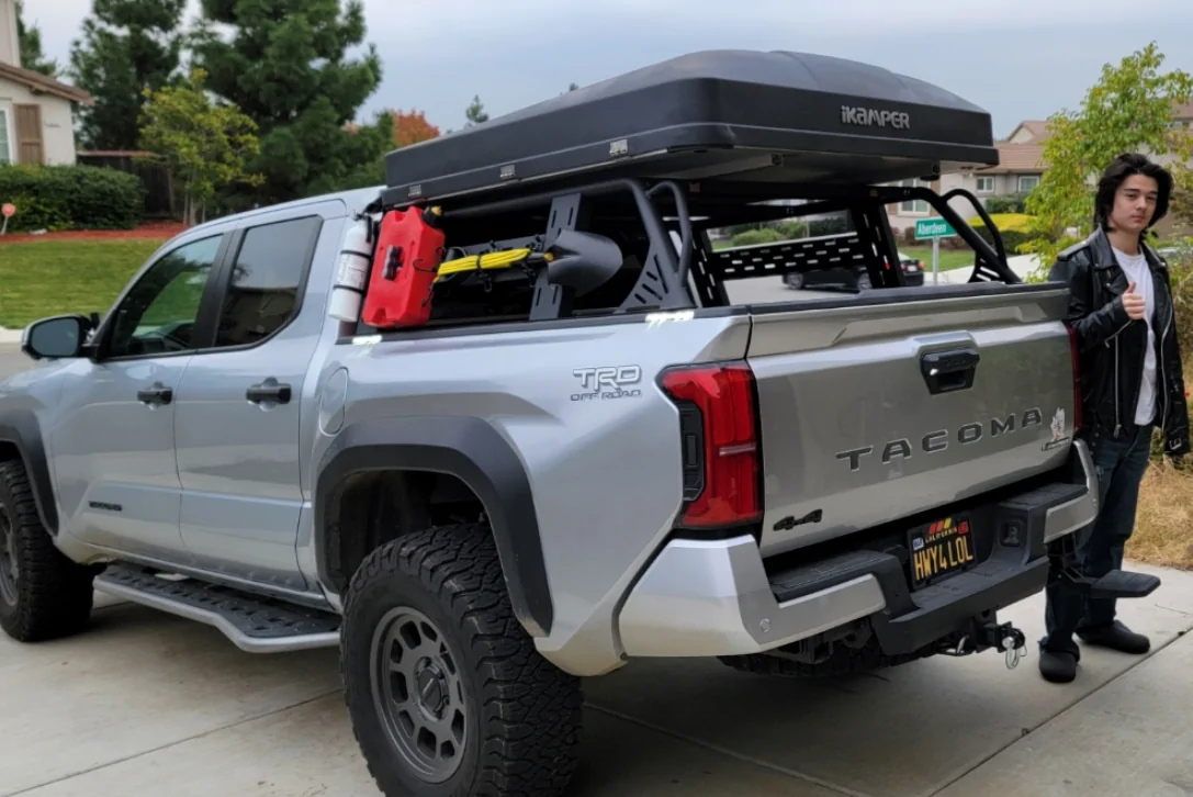

Hey all,
TL;DR: wondering if this is normal for an RTT up on a rack in the back, as viewed from the rear bed cam:
More detail:
I just got a great deal on a like new iKamper 3.0 Mini ($2k!) and was very excited to get it attached to my (yes, cheap) bed rack. It went up fine, and I've laid in it with my son (16 years old, not sure exact weight, but slim) and I (240 lbs) and it feels very solid. I'm not afraid it's going to collapse or anything, and the rack says it's rated for 500 lbs dynamic and 1000 lbs static. I take these values with a grain of salt, since it's clearly a cheap rack. To be honest, I've been very happy with the rack, and think it looks and works fine. Yes, I could spend $2k and get an Kuat Ibex or whatever, but I've spent so much already on the truck I'm trying to save some dollars on the accessories.
2024 Tacoma Is this a normal amount of "jiggle" for an RTT? (see video) 1765388306934-ji
" Crafted from premium heavy-duty steel plate, this rack is exceptionally sturdy, capable of supporting 1000 pounds of weight when statically distributed and 500 pounds when in motion. It features a textured black powder coating for corrosion resistance and long-lasting durability. "
The RTT now completely blocks my rear bed camera, which sucks, but I was a bit shocked the first time I popped the camera on and noticed the tent bouncing around what feels a bit aggressively.
Previously, I had some rifle cases up there and did not notice this bounce:
2024 Tacoma Is this a normal amount of "jiggle" for an RTT? (see video) 1765387800253-1r
Now I've got the RTT up there:
2024 Tacoma Is this a normal amount of "jiggle" for an RTT? (see video) 1765387892986-pl
Any help or insight would be much appreciated.
Thanks!

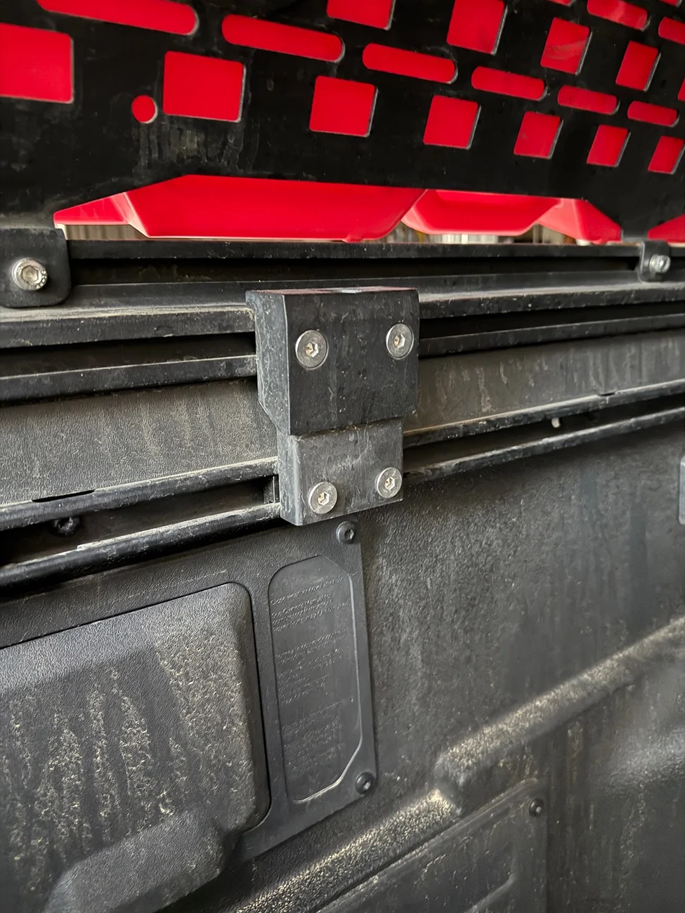

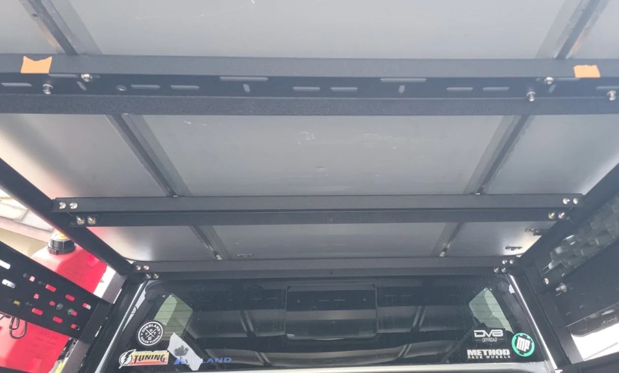

This is how the rack mounts:
2024 Tacoma Is this a normal amount of "jiggle" for an RTT? (see video) 1765558690997-3c

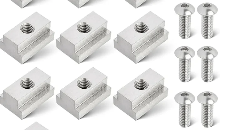

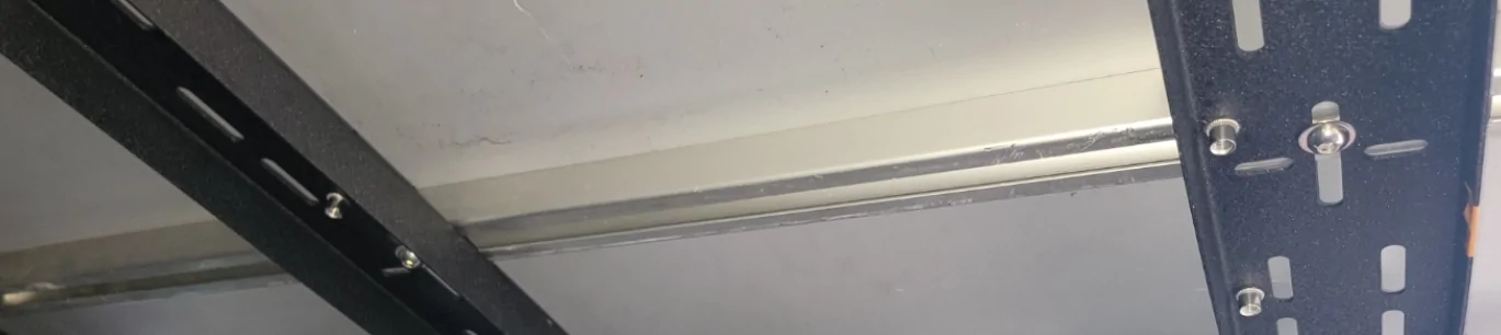

And the tent is secured to the rack via bolts and washer going directly into a t-slot bolt:
2024 Tacoma Is this a normal amount of "jiggle" for an RTT? (see video) 1765558743229-s2
2024 Tacoma Is this a normal amount of "jiggle" for an RTT? (see video) 1765558775527-or

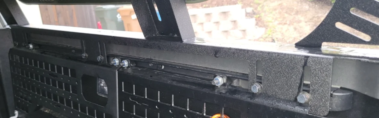

6 mounting points total:
2024 Tacoma Is this a normal amount of "jiggle" for an RTT? (see video) 1765558814945-l9

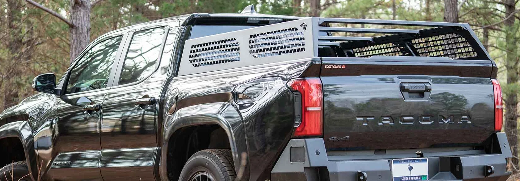

I'm not wild about how high up it is, shifting the center of gravity, I may get a rack that's lower in general, something like this:
2024 Tacoma Is this a normal amount of "jiggle" for an RTT? (see video) 1765558965230-s

The clamshell is secure, I can make the whole rack and tent shake (slightly) if I put a hand against the side of the tent and rock it.

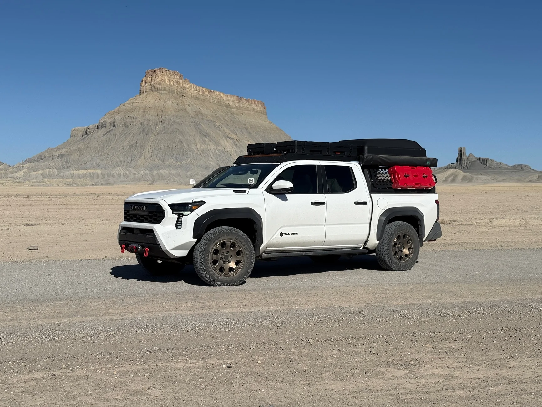

I wasn’t saying it was the clamshell of the tent. It’s the whole tent which is caught in turbulence. That’s why I was wondering if the tent wasn’t completely secure to the bed rack. But now you say, you can shake the whole thing, bed rack and tent. That shouldn’t happen. Well, you get what you pay for. I have a Kuat Ibex it doesn’t shake or move.

Yeah not sure I'm explaining it properly. I mean I can push against the side of my truck and make it rock, doesn't mean every bolt on the truck is loose. The bed is obviously separate from the cab, and I think the play between those two parts is what I'm seeing, plus the fact the camera (attached to the cab) is about 2 inches from what's being viewed (attached to the bed).

It's your rack flexing side to side, because it's a lightweight inexpensive rack that's mounted to the truck in a not very secure way.
I'd personally find a better rack. One that actually mounts directly to the truck, not to the tie-down rails (which aren't designed to take the weight of an RTT anyway).

The difference is that the Kuat clamps are pulling the lower horizontal rack bar down onto the top of the bed rails, which prevents it from flexing side to side on top of the rails. This connection will be much more rigid than the rack just sitting on the bed rails with no clamping force.
In addition, the Kuat rack (and other equivalent quality racks) will have a more rigid structure and flex less in general.
Lastly, any Tacoma running a RTT likely needs bed stiffeners. A flexy bed rack will exacerbate the bedside flex issue.
