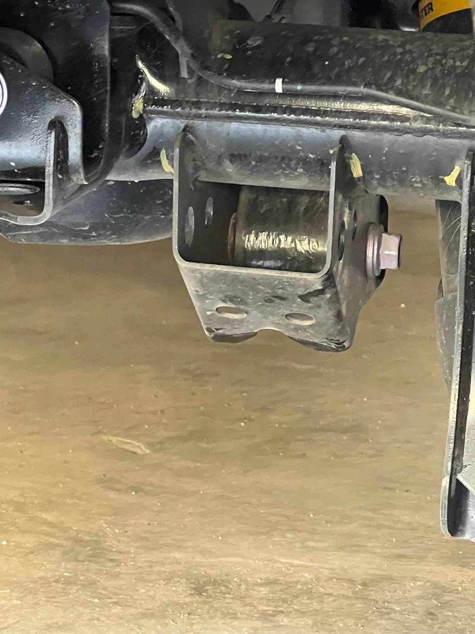

Guys I’m having a mild freak out. Discount tire jacked up my truck at a very weird spot from the back. See picture. I cannot tell where they jacked it up in the front but it looked equally cringe. Should I be worried? The metal in that spot does NOT look that thick.

Rear shock mount should be fine..I jacked mine up a few times on the same spot..It’s only picking one corner on the truck

In your picture @tacorancher the jack point is between the two paint marks on the right side. I wouldn't have used that bracket, but it does not look damaged to me.

I think it's the rear lower control arm mount. The shock mount is closer to the wheel. This mount is attached to the axle. It just doesn't look like the thin metal in that spot is designed to carry that kind of load. And now I am freaking out trying to determine if it's crooked. I cannot tell really.

But guess what... I am going to keep wondering if it is and I can't tell. That's a lot of weight!

@tacorancher Does it look like they did the same thing on the other side too? If they jacked up the rear from both sides that is less weight on each control arm mount. The back of a truck is a lot lighter than the front too, so that is even less weight on each side, assuming they put the whole truck up in the air to change tires.

They did the same on both sides. But it's going to bother me. It just seems wrong. The guys doing the work were utterly clueless humans. They had no clue what the dots on the tires even meant. It was horrifying.
