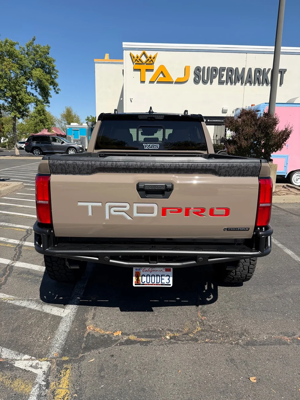

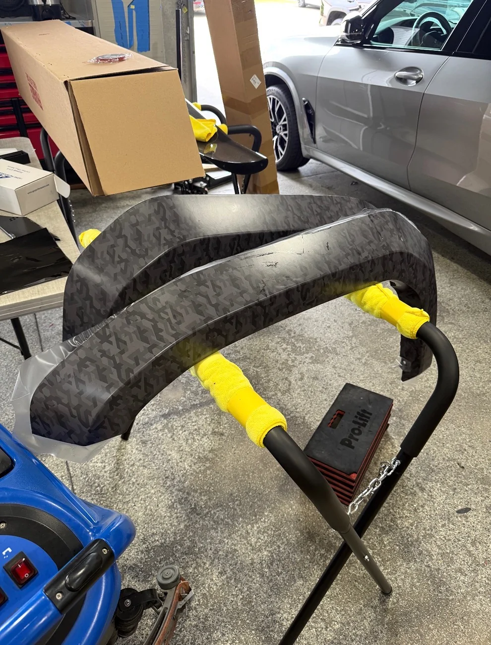

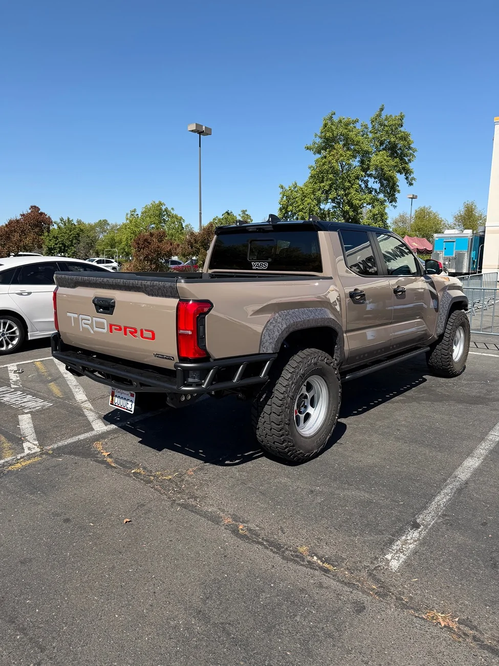

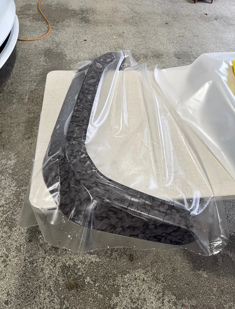

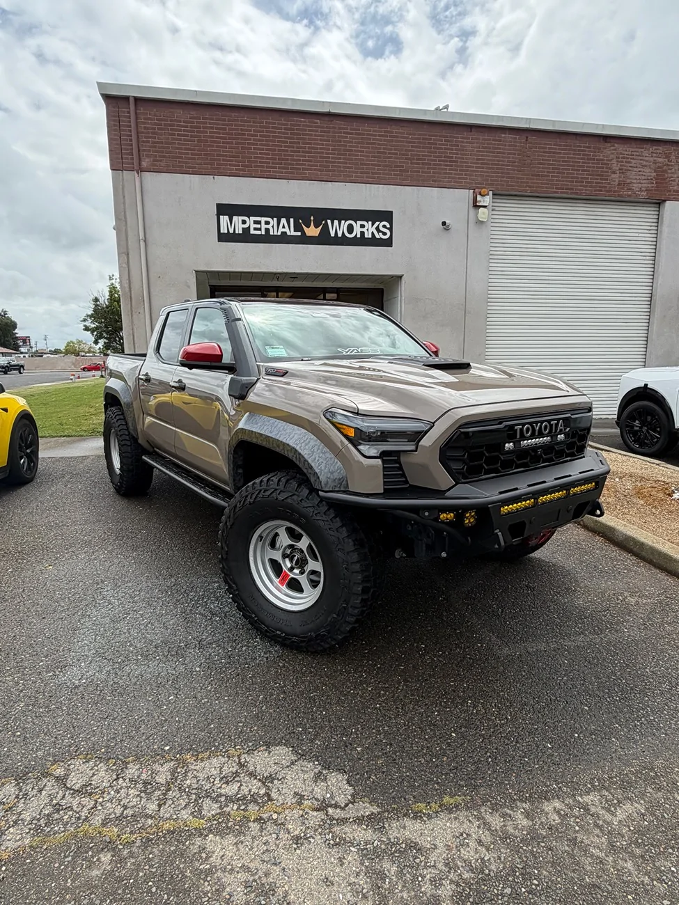

Went to my nearest car wrap and PPF installer at IMPERIAL WORKS in Sacramento, CA.
They wrapped my TRD Pro Flares and the black strip on my tailgate with TRD Pro Camo and put matte clear PPF over it to give it more depth.

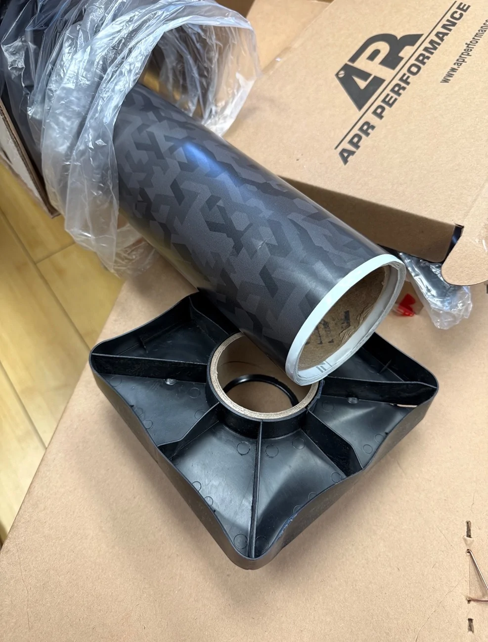

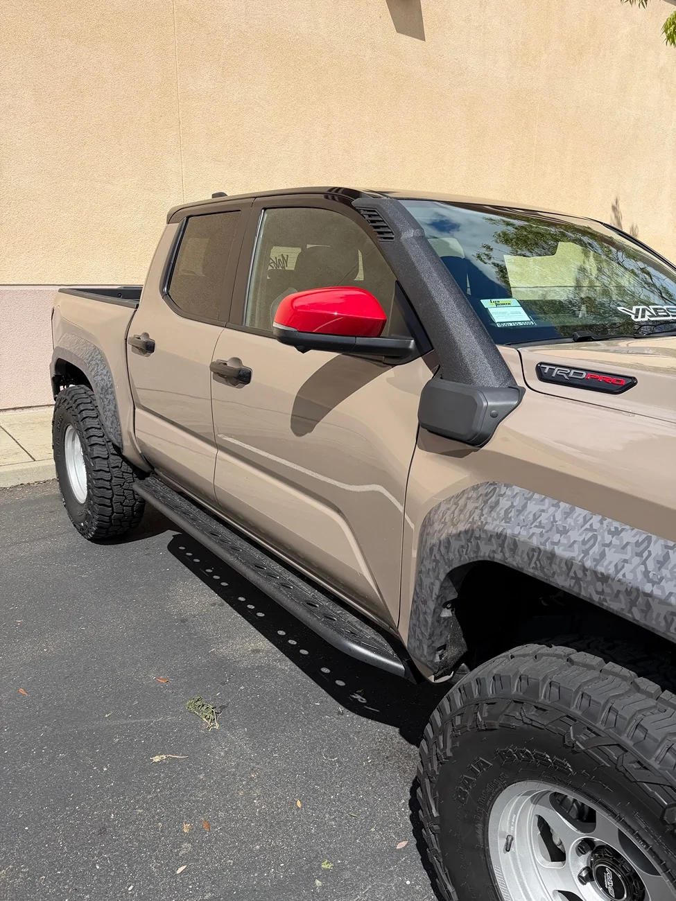

Finally installed the trailhunter snorkel on my TRD Pro with the assistance of procuring all of the parts necessary from brother @tipsyjam
Glad I was able to add the snorkel and dump exhaust pipe from the Trailhunter.
Now I have that “TRD Trailhunter Pro” special

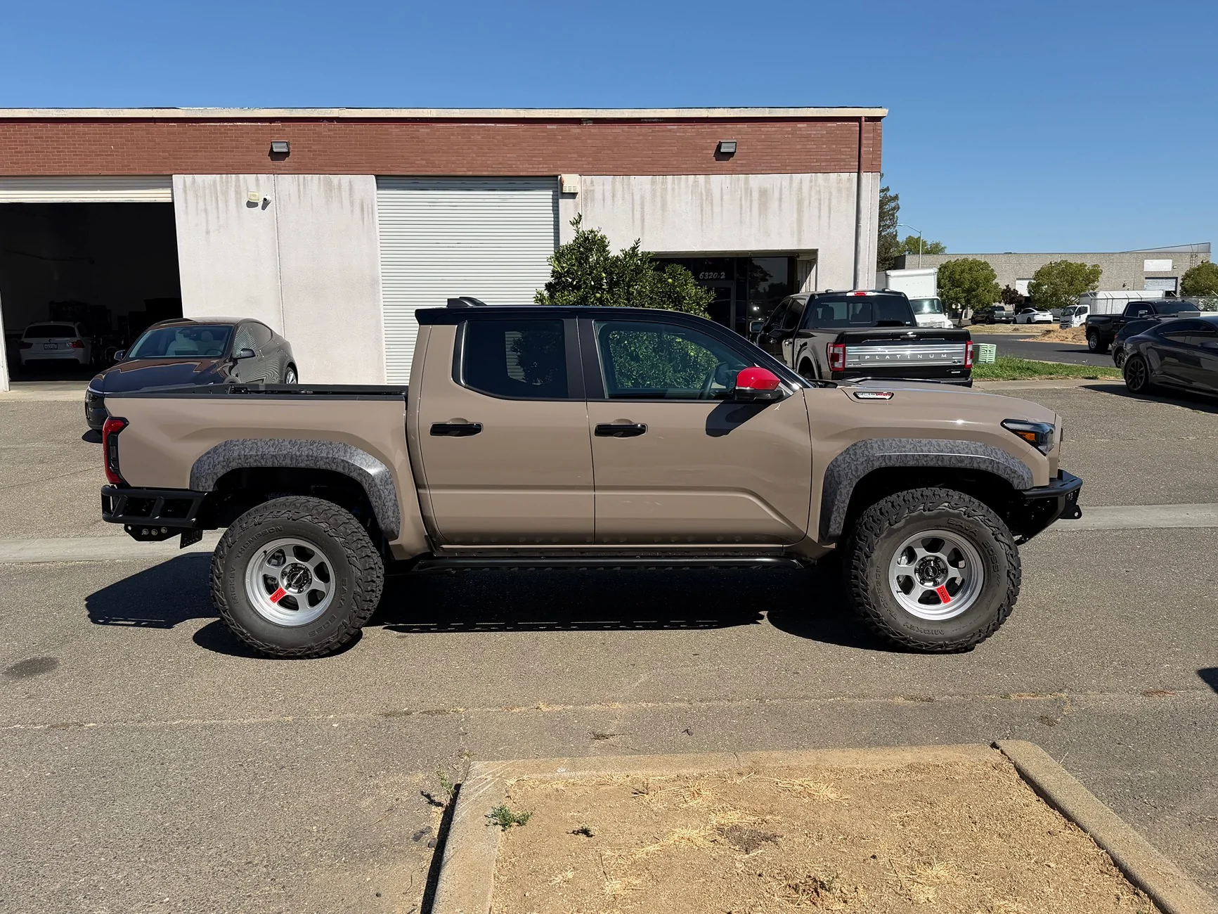

Before I did the Trailhunter Snorkel…. Forgot to document a few items I had done also.

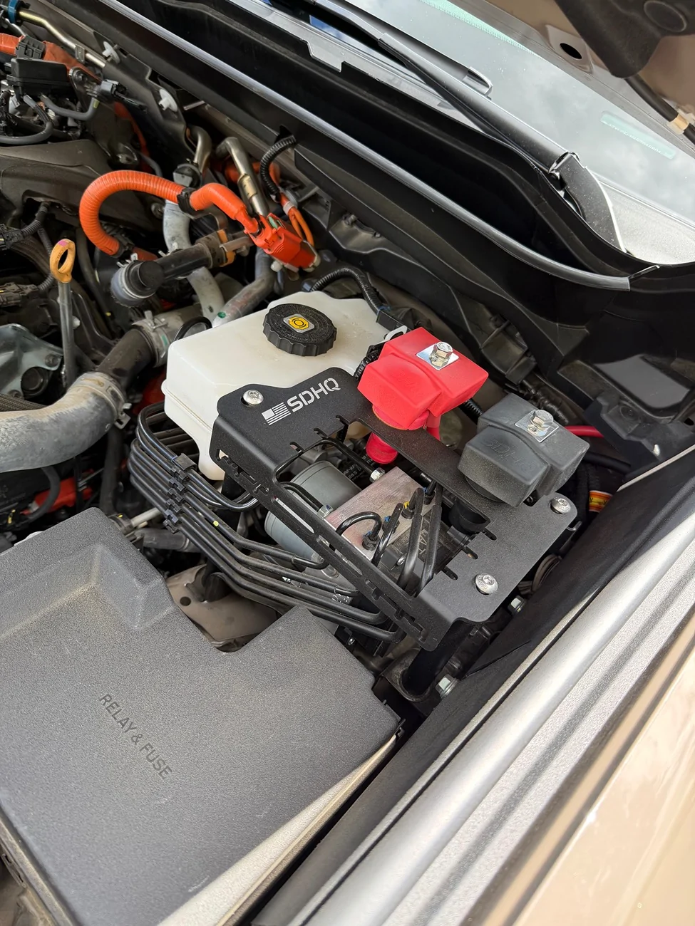

First of all….. added the SDHQ Power Solution Kit since I had a Hybrid. The battery for accessories is located in the passenger seat behind the drivers door. Very inconvenient.
The SDHQ Power Solution Kit brings the battery terminals from the battery underneath the passenger seat into the drivers side of the engine bay.

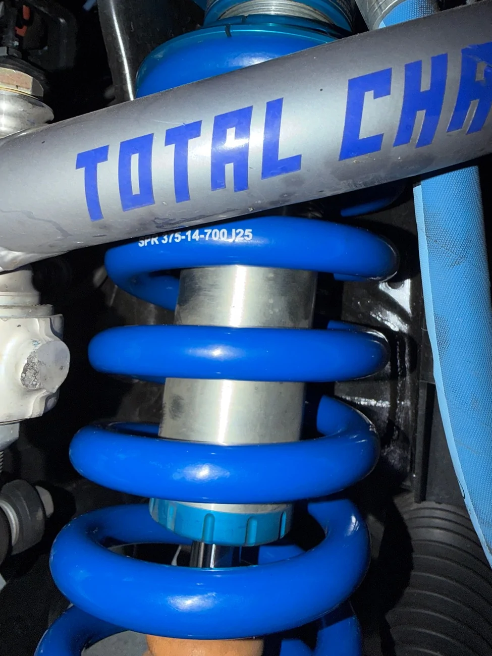

Next …. Since I had a weight issue in the front with the hybrid engine, front bumper, winch, under armor skids, and rock sliders causing a hard rake…. I had to be change the 500lb standard springs in my 2.5 kings mid travel to 700lb. Raised it back to just about level
And lastly replaced the 35 inch tires to 37 inch tires
