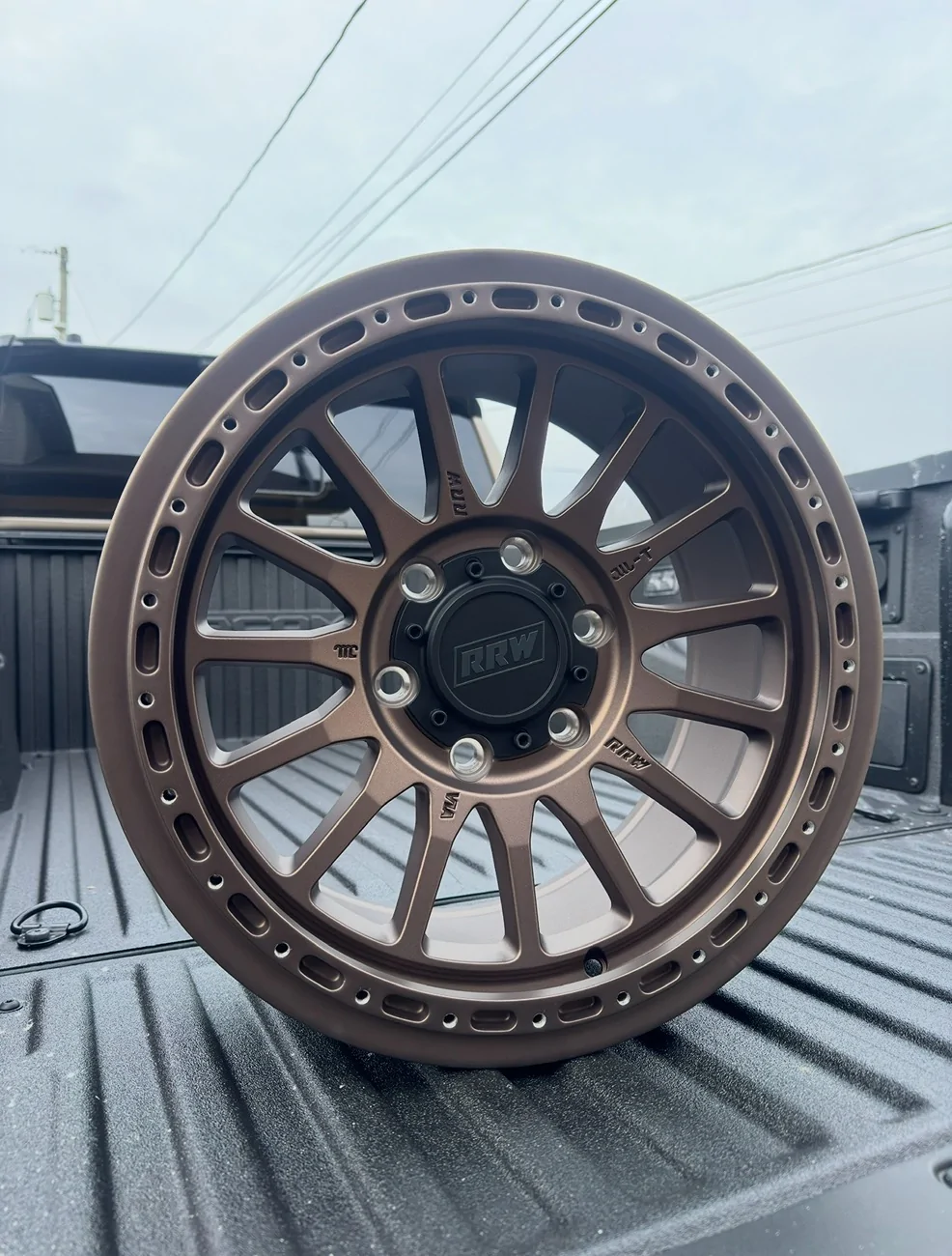

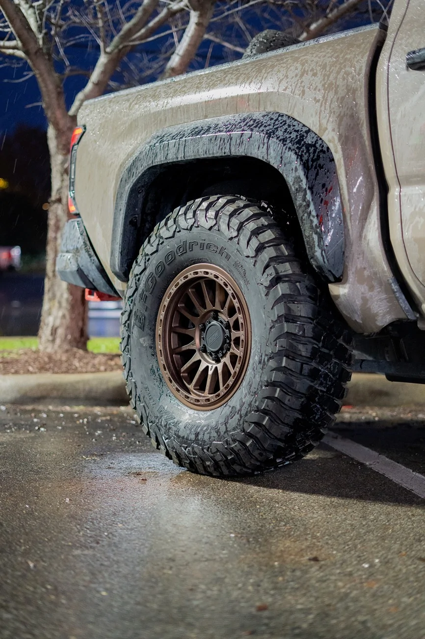

Wheels just got delivered. Going to finish trimming both sides & take it to get them mounted.
Can’t go wrong with RRW….. this was my second choice of wheel…. Best looking and weighted wheel for the money IMHO

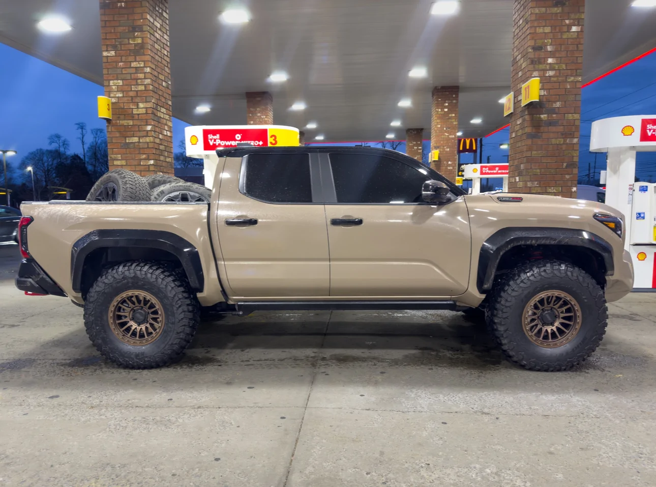

So was there any issues after you cutting and taking the crash bars out with +25 offset and 37s?
Still on stick TRD Pro suspension correct?
The only place I'm rubbing ever so slightly is at full lock turning left. There's a bracket on the inside of the drivers wheel well that I think is for the sway bar disconnect. I'm going to have to either trim it down or relocate it. Without that there there, there's zero rubbing issues for on road driving. I'm going to take it to a local shop on weds and cycle the suspension to really fine tune it.
Cool….
Gdluck….. looking good

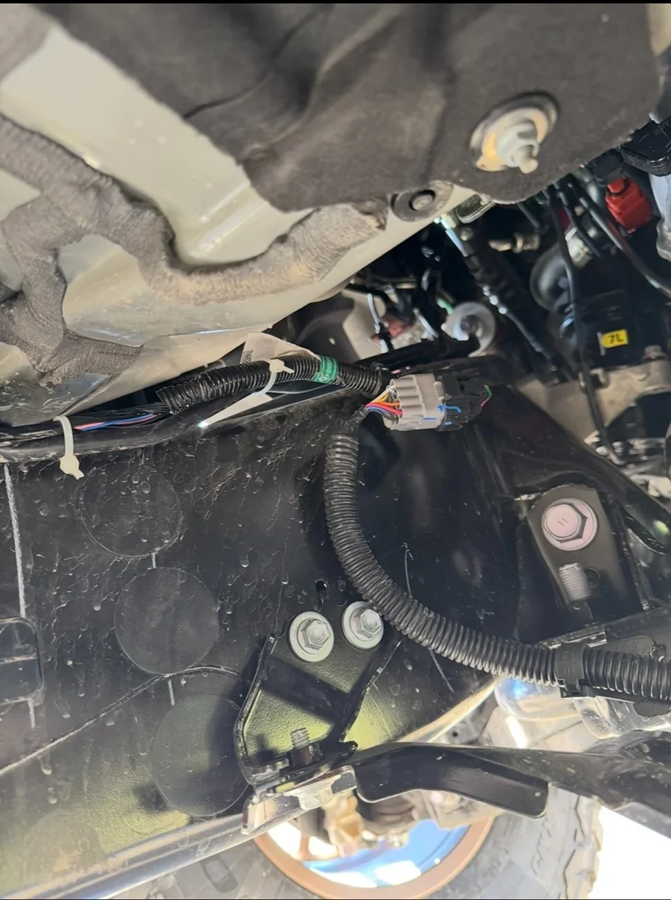

After driving for an afternoon, I was able to figure out what I was rubbing on. It was the Sway Bar Disconnect Bracket harness. I ended up relocating it behind the frame as pictured below. It was a pretty simple process to do. You can read about it here.

Battery under the seat? Is that the same in all new Tacoma's?
