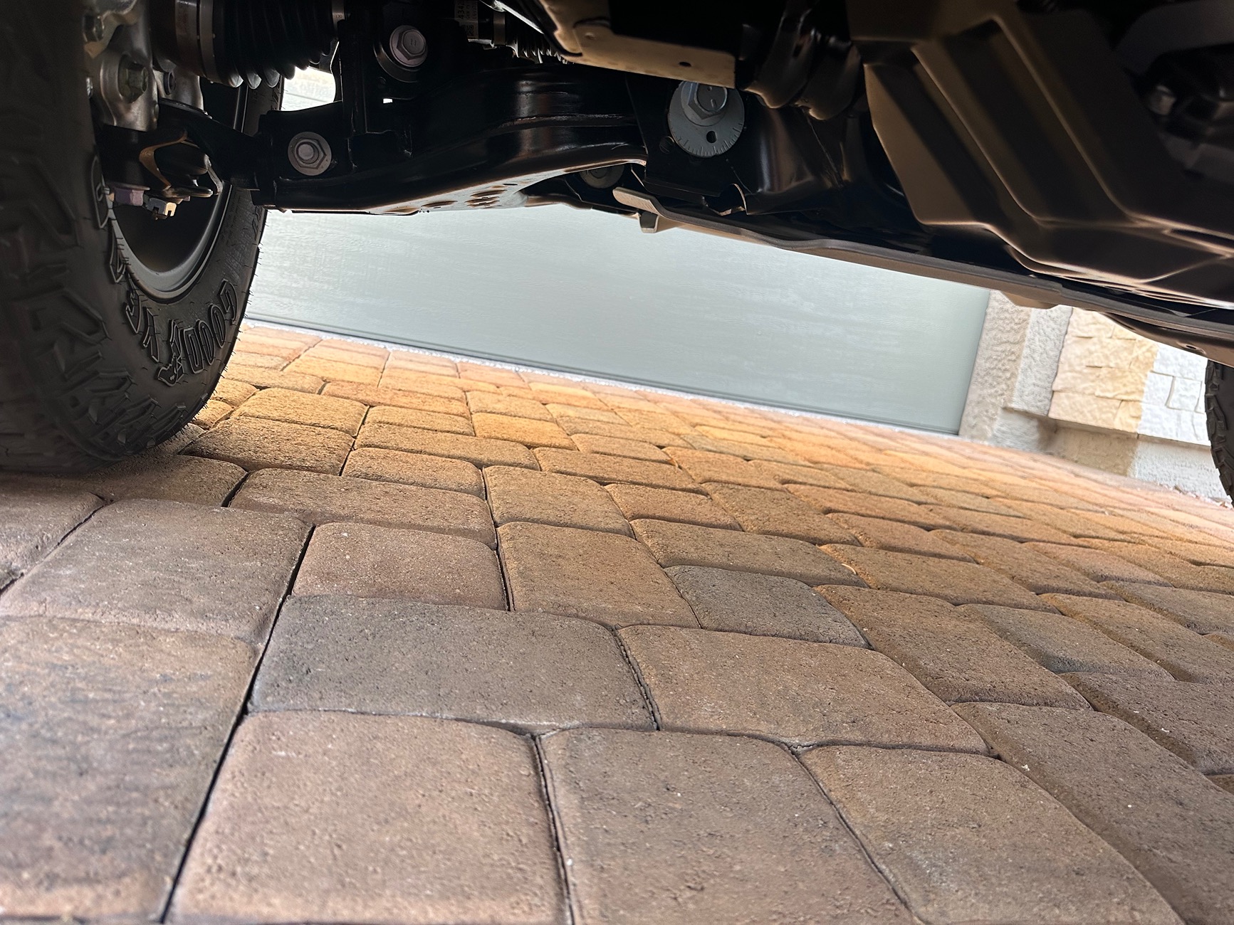

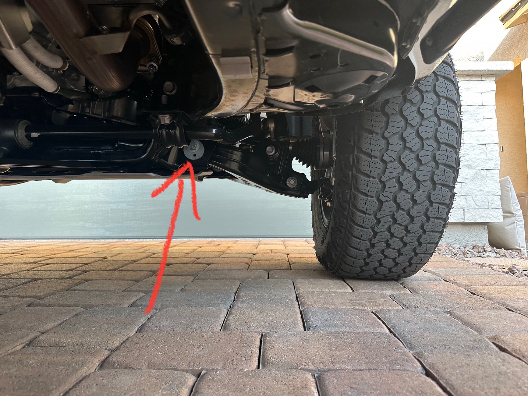

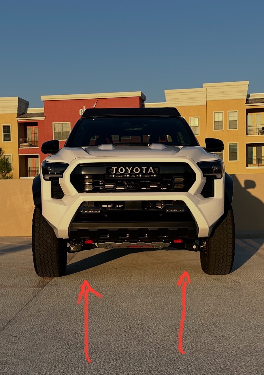

Here are some photos concerning the “lean”.
the first photo is the frontal view, which you can see the whole vehicle is leaning on the driver’s side. This is evident by looking at the lower control arm that is more flat on the driver side compared to the passenger side.
the second and third photo is better look at the front control arms from the rear point of view. What do you guys think is causing this? Could it be that silver bolt thing that I circled in one of the rear view? Or would it be due to broken parts in suspension? Tire pressures the same for all four. Any answer is appreciated.

Guys, quick updates.
so I dripped my vehicle off at a toyota dealership to address the suspension leaning issue. What I was told is that there have been two customers before myself that complained the exact same issue (leaning on front driver side) and that Toyota has told dealerships to wait x number of miles and times before making any adjustments. The reason is because these vehicles are ties down after being assembled in Mexico and transported to the US. So the vehicles need time to rise back up to the normal height. I honestly find this BS, especially for TRD Pros, which are designed for baja with stronger suspension set up. I believe the vehicles being tied down during transportation but I honestly think if the vehicles has not risen back to normal height by now I think something is broken in there. What do you guys think? And what part do you think is broken?
