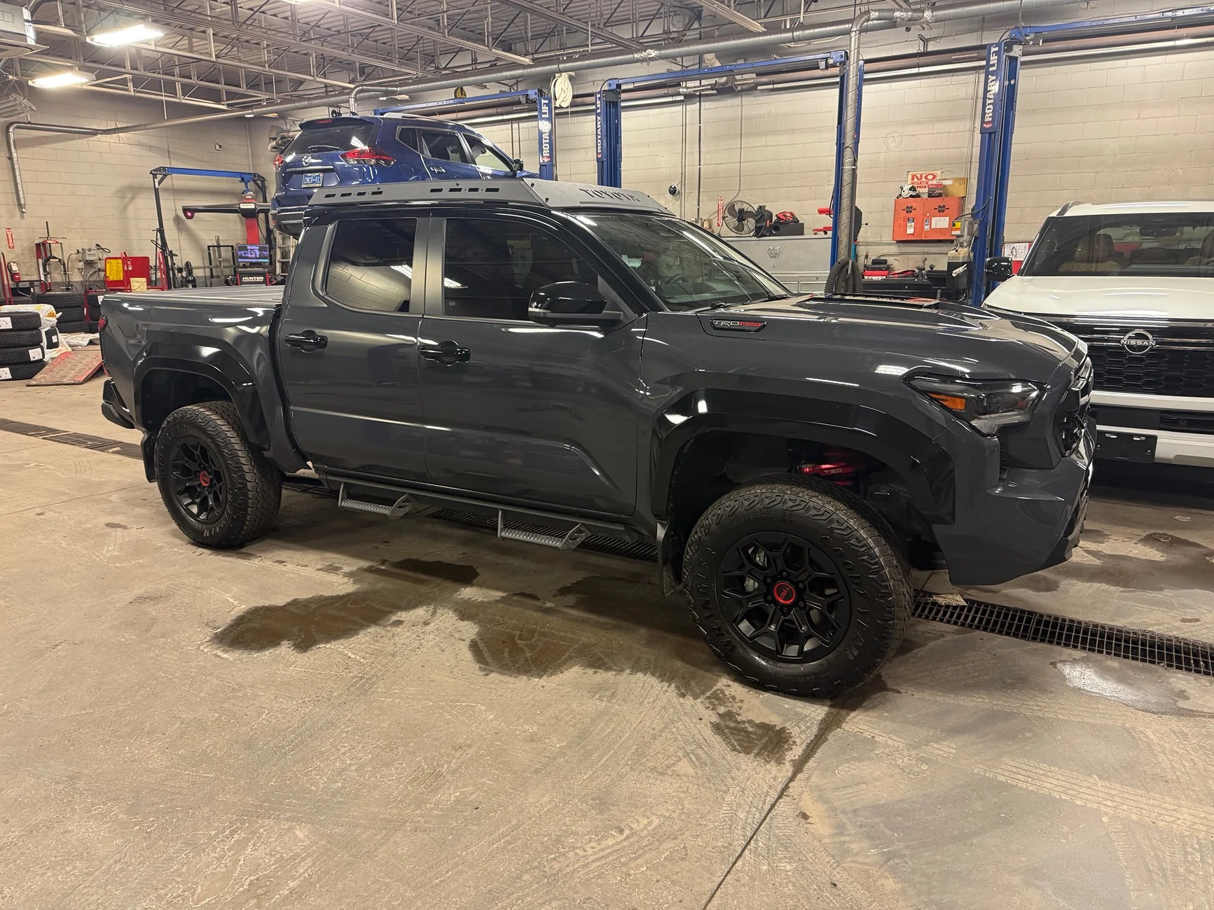

What is the largest possible tire I could go for my 2024 trd pro on its stock 18” rims and ride height ? (willing to remove mud flaps and plates if needed)
Know this question has been asked multiple times for many trim levels but not seeing much about TRD pros .
Open to any insight and advice & would love to see other trd pros set ups especially if on 18’s . Thank you so much in advance and looking forward to connecting with the Tacoma community .

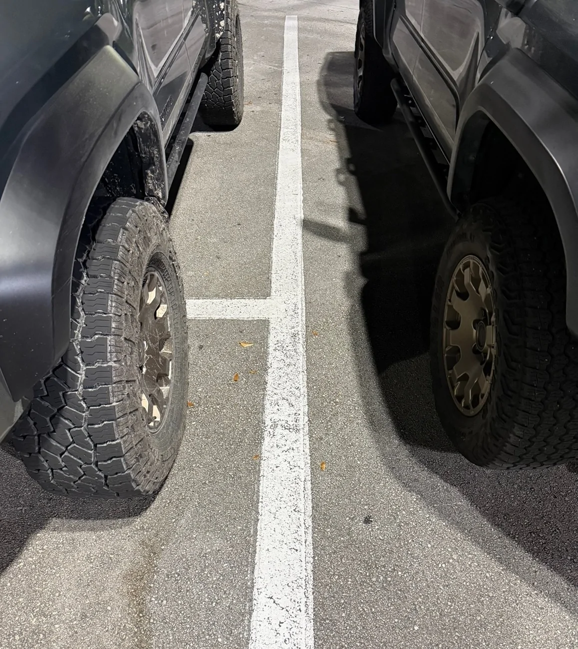

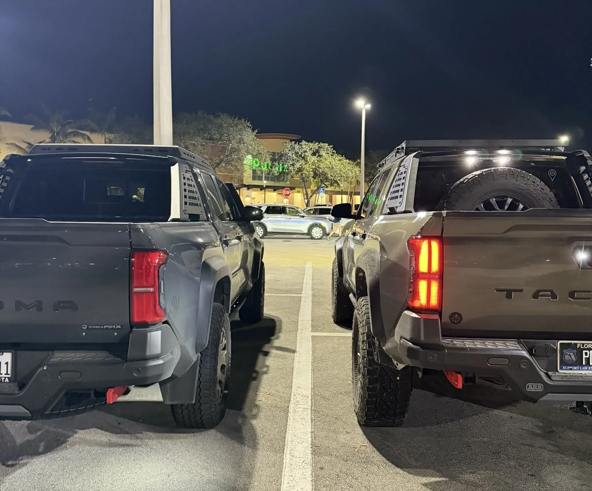

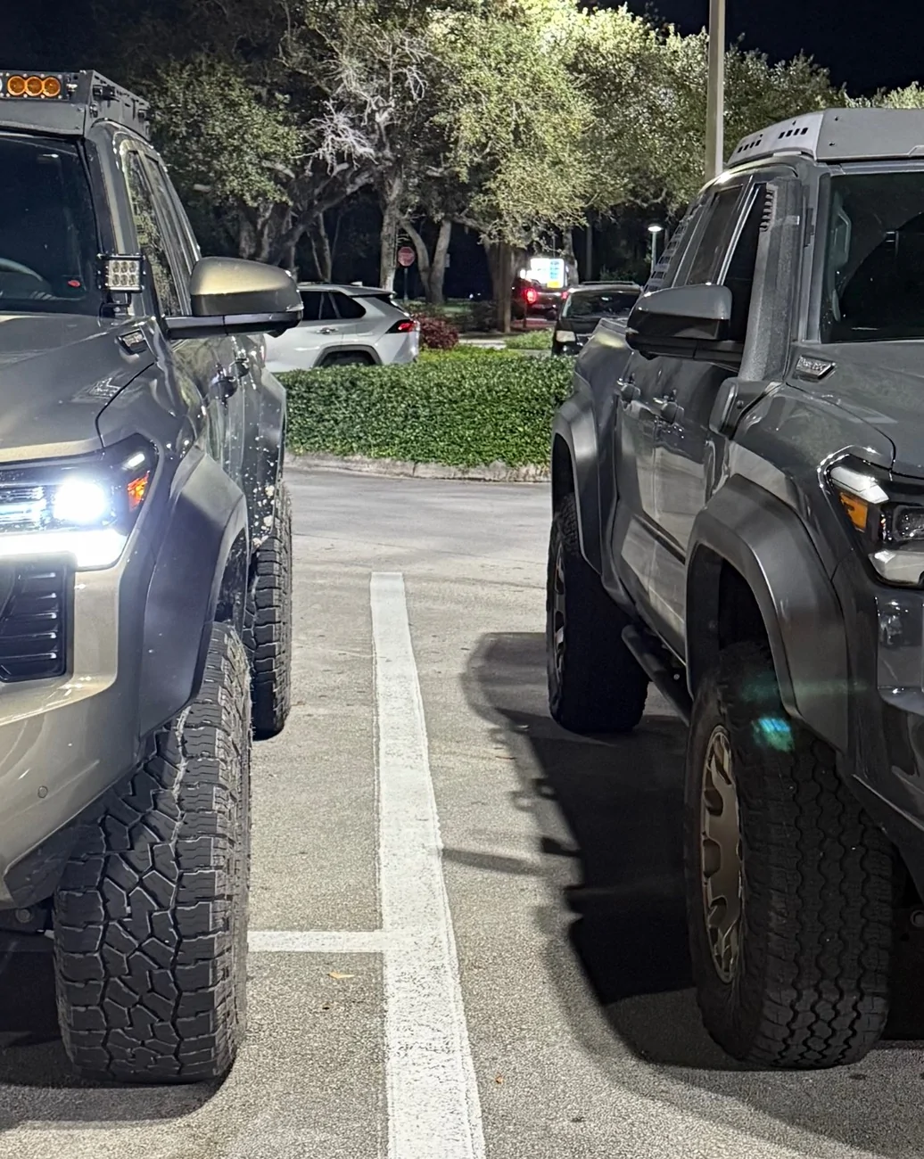

The TH and TRD PRO share the same offset so all that data in the other threads carries over.
In summary, largest tire you can throw on is 295/70s if you remove the crash bar and oem mudflaps. I still had tini tinrub until I moved up the caster slightly but that’s because I kept my ARK low profile flaps which consumed about 2mm of clearance. Once I lifted my TH another 1.5 inch from stock, caster back at nominal with flaps, no rub. 295/70 spare won’t fit under the bed.
I also initially tested 285/70s. No rub with everything OEM in place. 285/70 spare fits under the bed but just barely but wouldn’t trust the chain hoist holding that heavy wheel on bumpy roads.
Here is 295/70R18 AT4 e loads compared to stock tire size:

I ended up going with BFG K03 in size 285/70R18 on stock Trd pro rims . I did remove crash pad and mud flaps because I thought I’d need to for clearance but there’s plenty of room I could’ve left them on. Noticed jump in MPG but worth it for the look in my opinion . Ride I wouldn’t say is any rougher or louder than stocks either which I was worried about !
