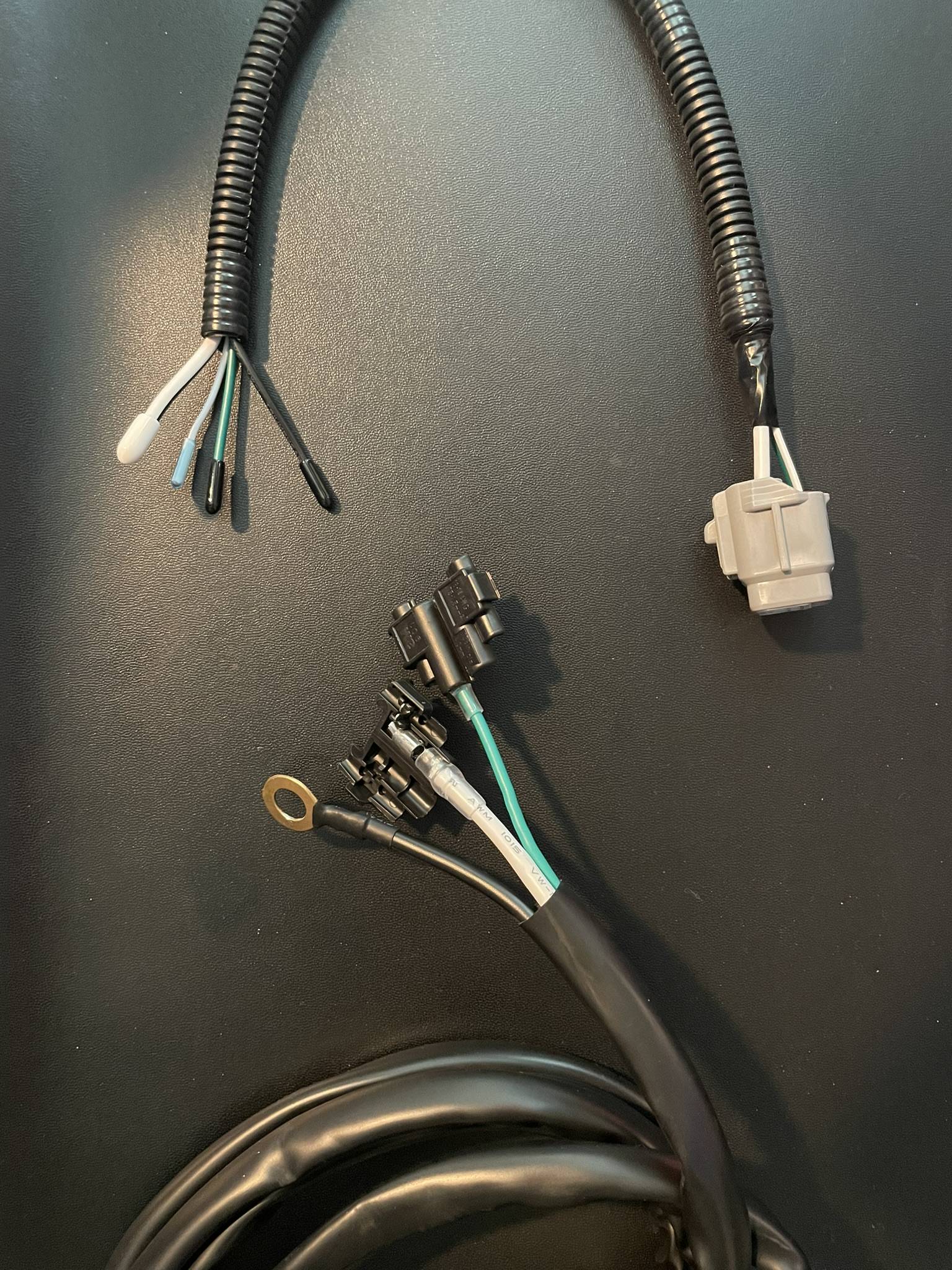

I got my Baja Designes S8 mounted on my roof rack and am ready to wire it up. Based on their suggestion, I got the upfitter switch from BD which is supposed to ease integration with oem switches. Looking at my pigtail and the BD harness it seems pretty straight forward but wanted to get yall to double check me before I hook it up. Is it as simple as thick white to to thick white, green to green, and black to ground in the engine bay?
Bonus points: The light bar also has a backlight feature. Not sure if I actually want to use but if I did would I wire the green lead to as second switch/pigtail? This was mentioned by BD but same as above, want to run it by you guys first.

So I talked to BD today and it turns out that the light bar draws close to 17 amps. Looks like the largest lead on the pigtail only supports 15. Is it possible to still to use the switch as "just a switch" and draw power from the battery directly instead?
Probably not–you'd expect to blow fuses.

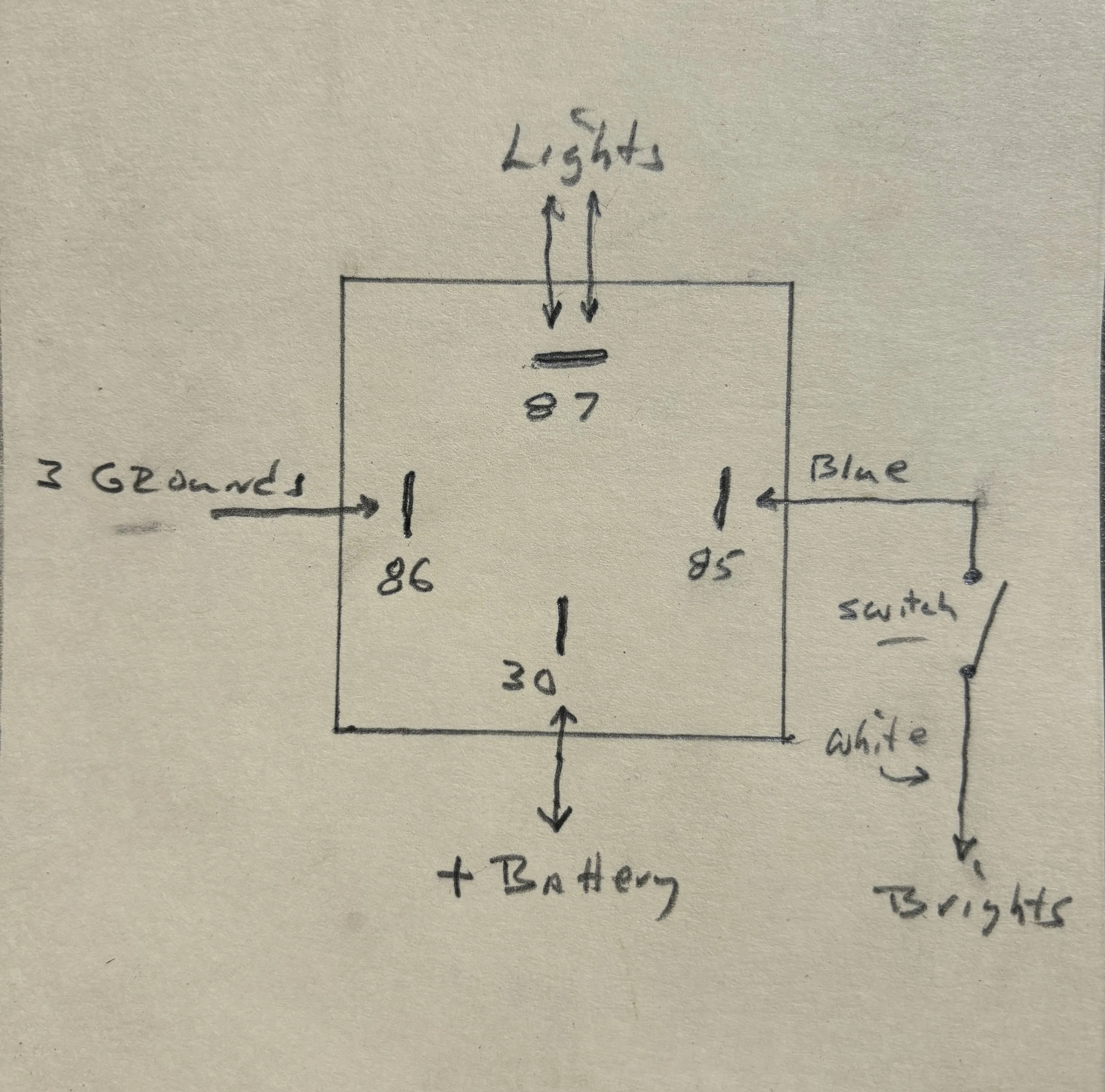

I bought the Cali ditch lights and wiring harness. I rewired the relay switch so I can control the lights using the bright-lever switch. You have to 1) engage the dash switch, and 2) push the bright lever forward.
I did the same thing with my 2016. If you don't want to go that direction, just hook the other switch light to the 30 post.

Connect the factory Aux switch to a relay that is wired between the light bar and battery. No need for two operable switches. Also, ground the light bar to the battery, not the relay
I think the previous diagram is showing that the relay will also need a ground to operate.

Definitely needs a ground to function.
I 2nd this. I don't like how Toyota used thinner gauge wires for 15, 10 and 5 applications, so I made a 25amp fuse/relay box for all 3 aux buttons and the lead that toggles the relay comes from the OEM Aux relays... works just fine plus allows you to safely run thicker wires so you can up the amperage.

Is this a similar setup to @Sagebrush?
Nope.
My system allows the driver to toggle the ditch lights (or light bar) using the dimmer lever. You have to use a relay switch for that.
