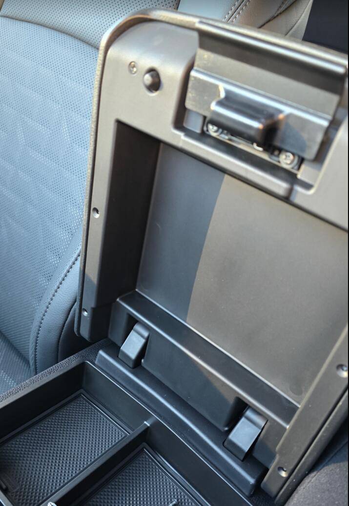

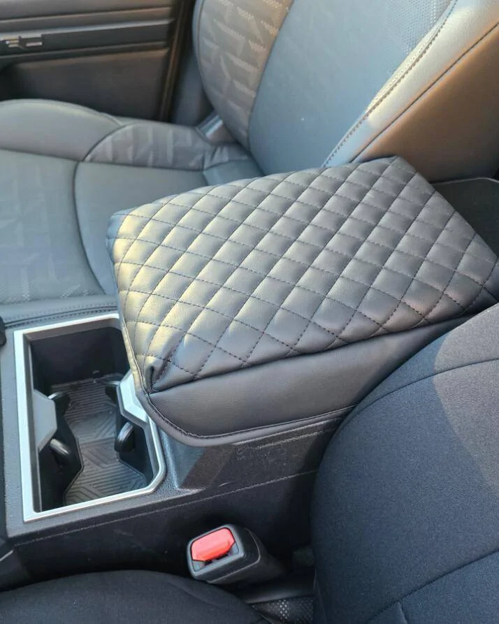

Not of much high importance so will just append these here.
1/8/24
1.
Installed a bunch of Amazon accessories for inside the vehicle.
2. 3D printed a drink cover.
Did you do the 3D printed rear drink cover yourself or purchased it? If you purchased it, can you provide a link for it please.

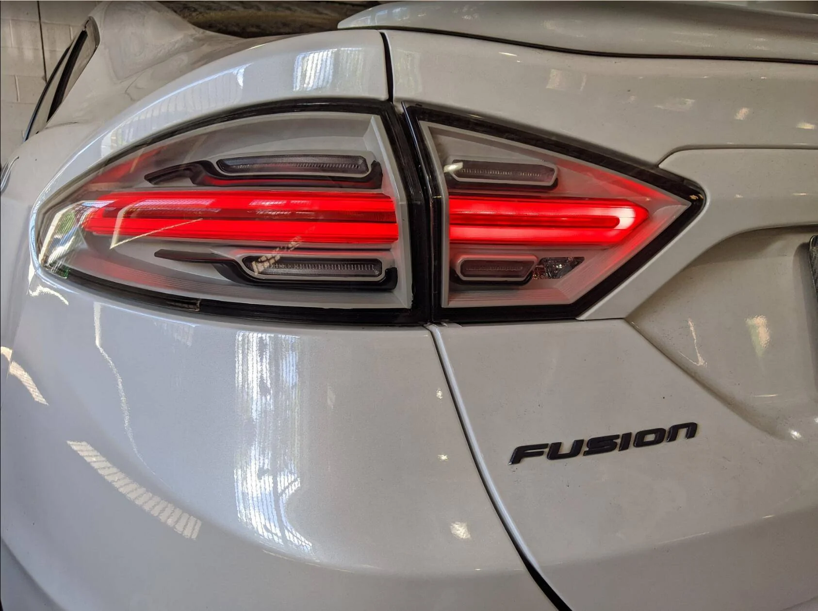

The red ones look like the way to go 100%. I’ve never been a huge fan of the all clear or dark look.
Yea, the only time i really like a full clear is when you paint match them and what not. Heres a set I did on my fusion.
Printed it. Ill make you one. Just give me a few days, got alot going on. PM me your address

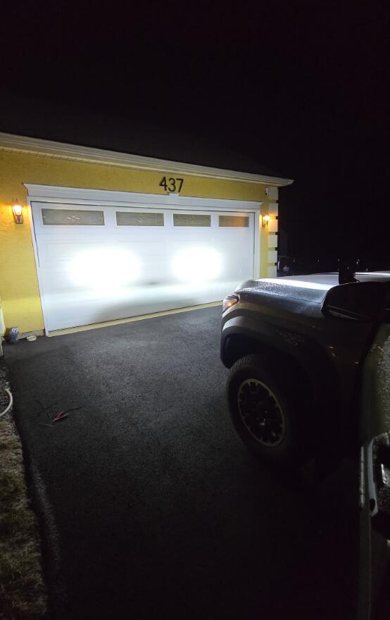

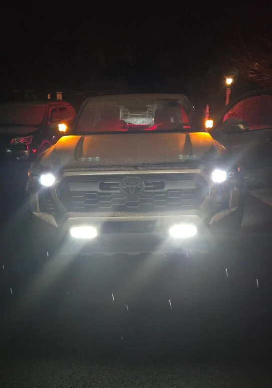

Installed Diode Dynamics SS3 Pod ditch lights. Created a quick wiring harness for now to Aux 2 and 3 buttons. Got tons of other lighting plans so will need to figure that long term wiring plan.

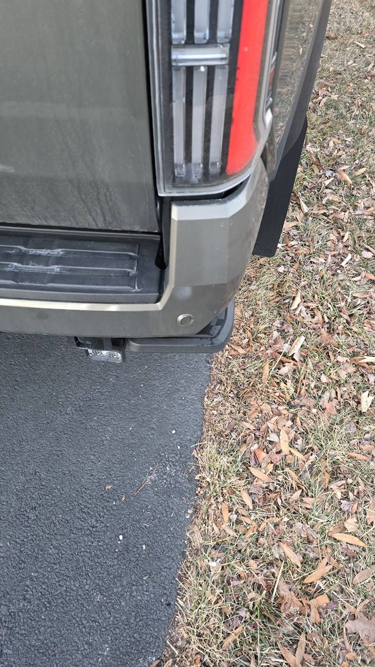

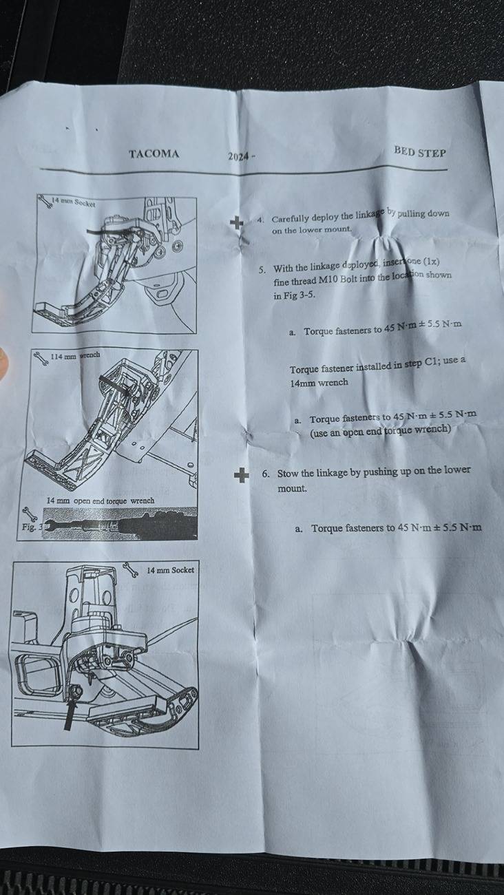

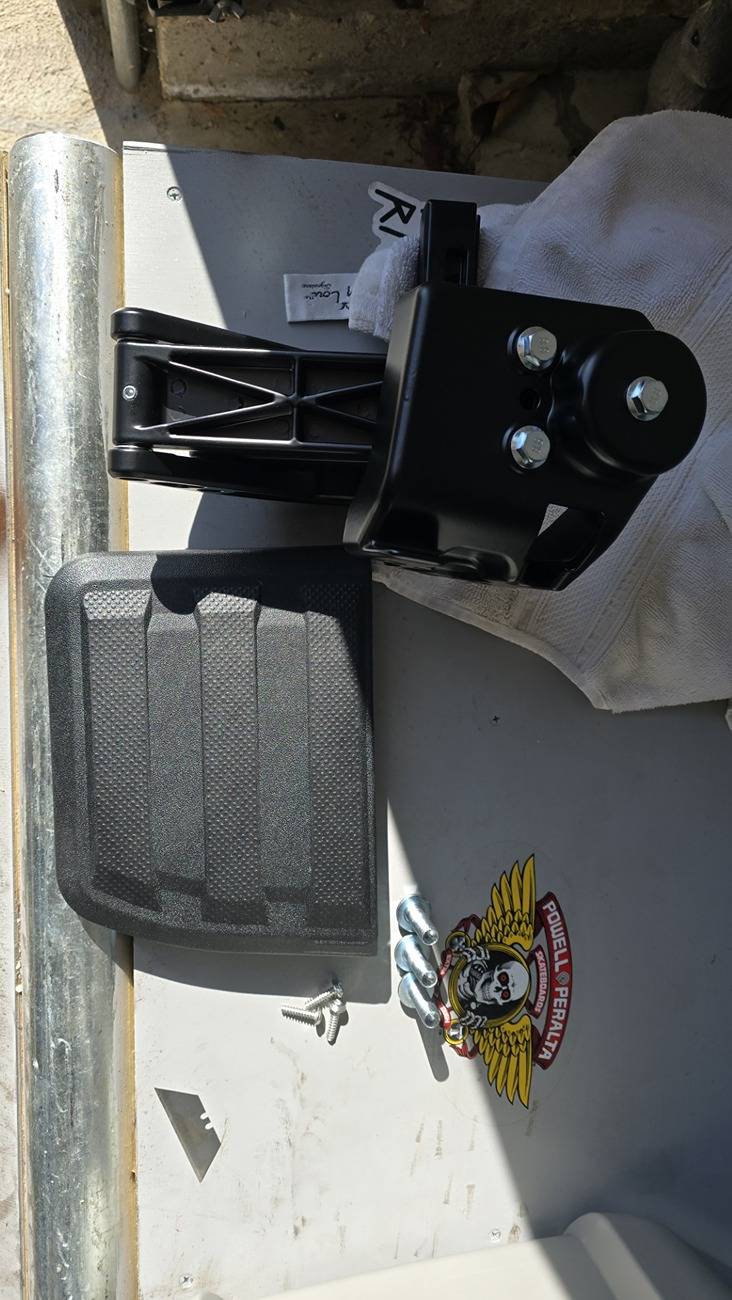

2/27/25

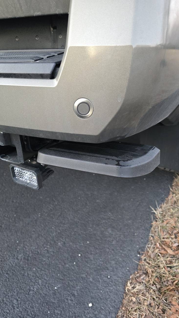

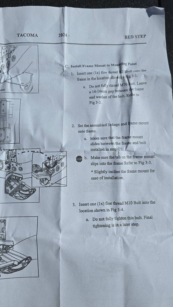

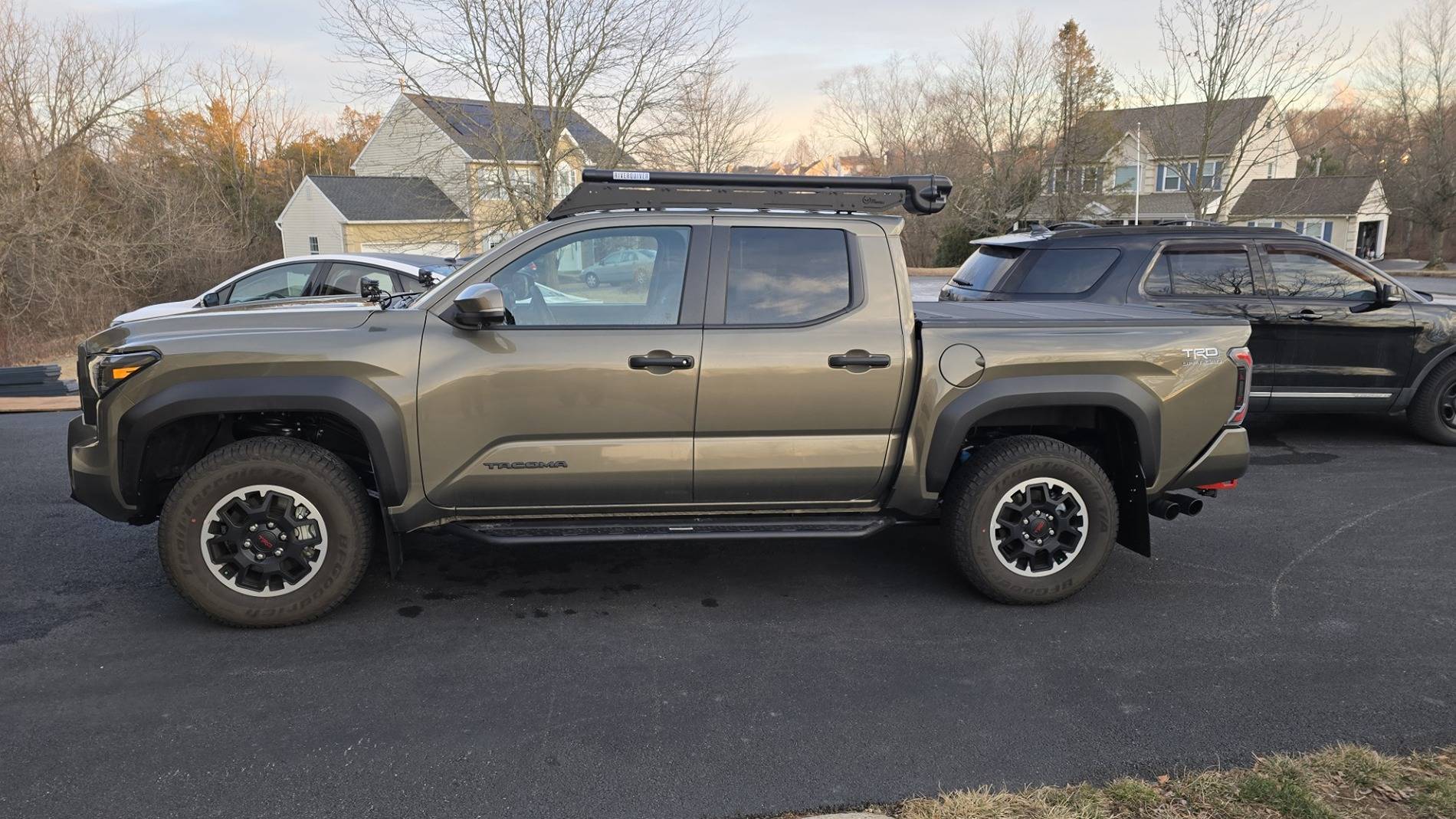

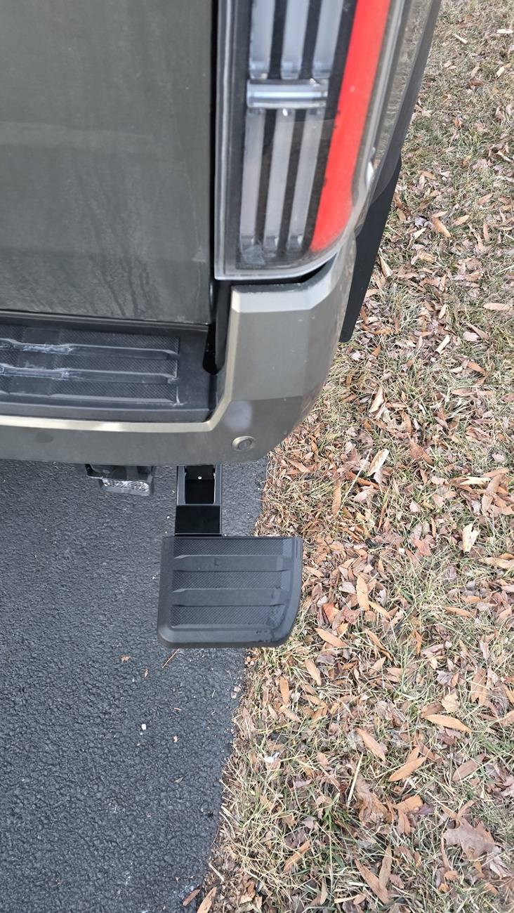

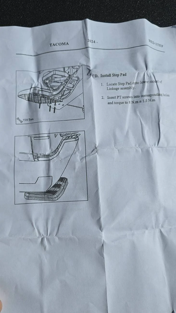

Installed bed step, $100 from Amazon. Had to remove the ARB recovery hook from the passenger side in order to install.

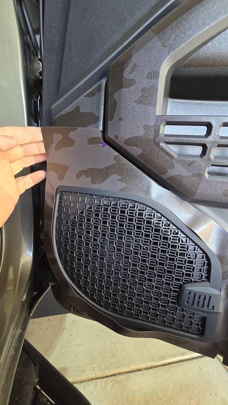

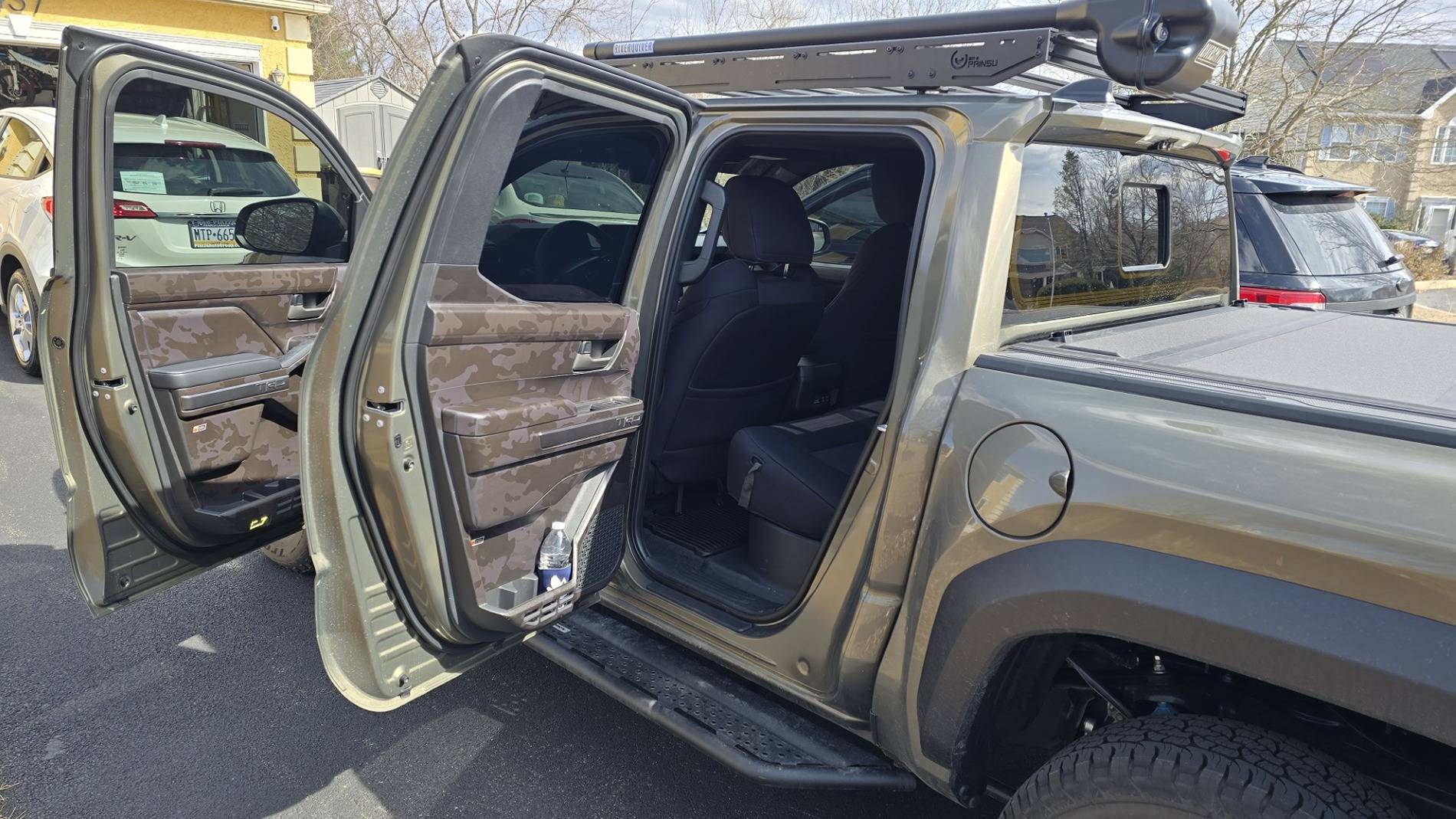

Finished install of TacoVinyl Door Skins. Had some quality to be desired. My only gripe is both the driver and passenger front doors had a fitment that seemed not correct for around the speaker. Also, they couldnt of NOT placed the piece number identifier(purple dot) OUTSIDE OF THE VINYL ???? This was done for every other piece on every other door except this one. Terrible QA \ design there.

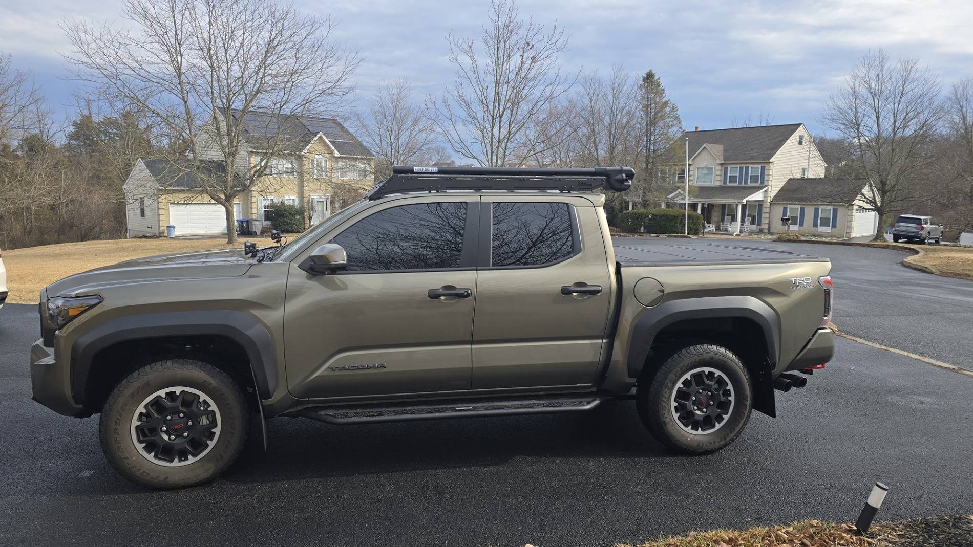

Finally got the much needed 15% tint done. The oem rear tinted glass read close to 30% VLT. So 35% was put on the rear and 15% on the front to get a close match in uniformity.

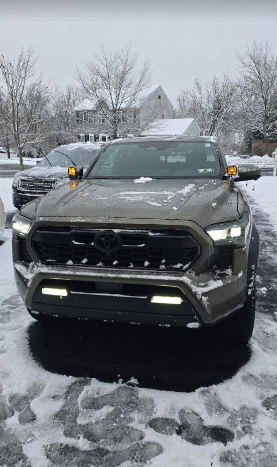

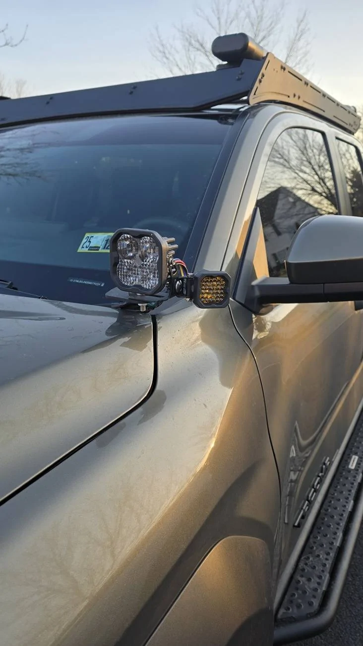

More ditch lights installed. SSC1 Pods in amber for more off to the side aux lighting.

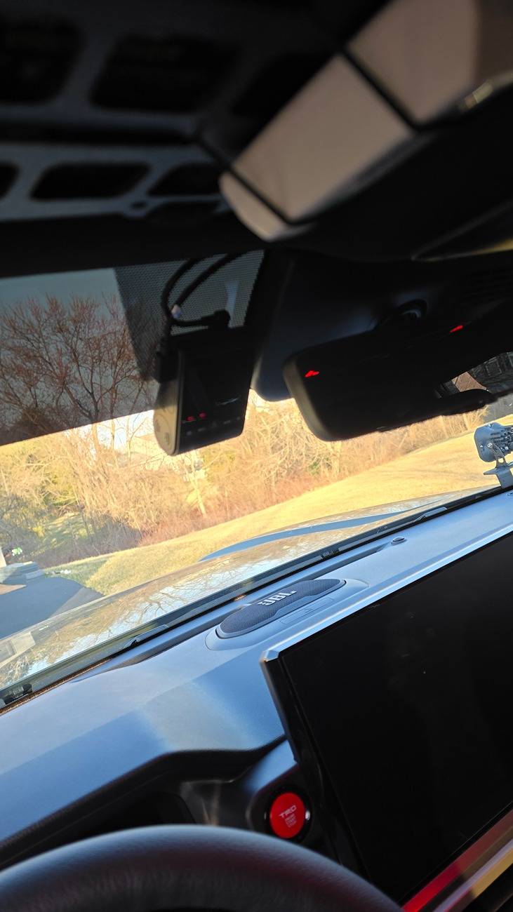

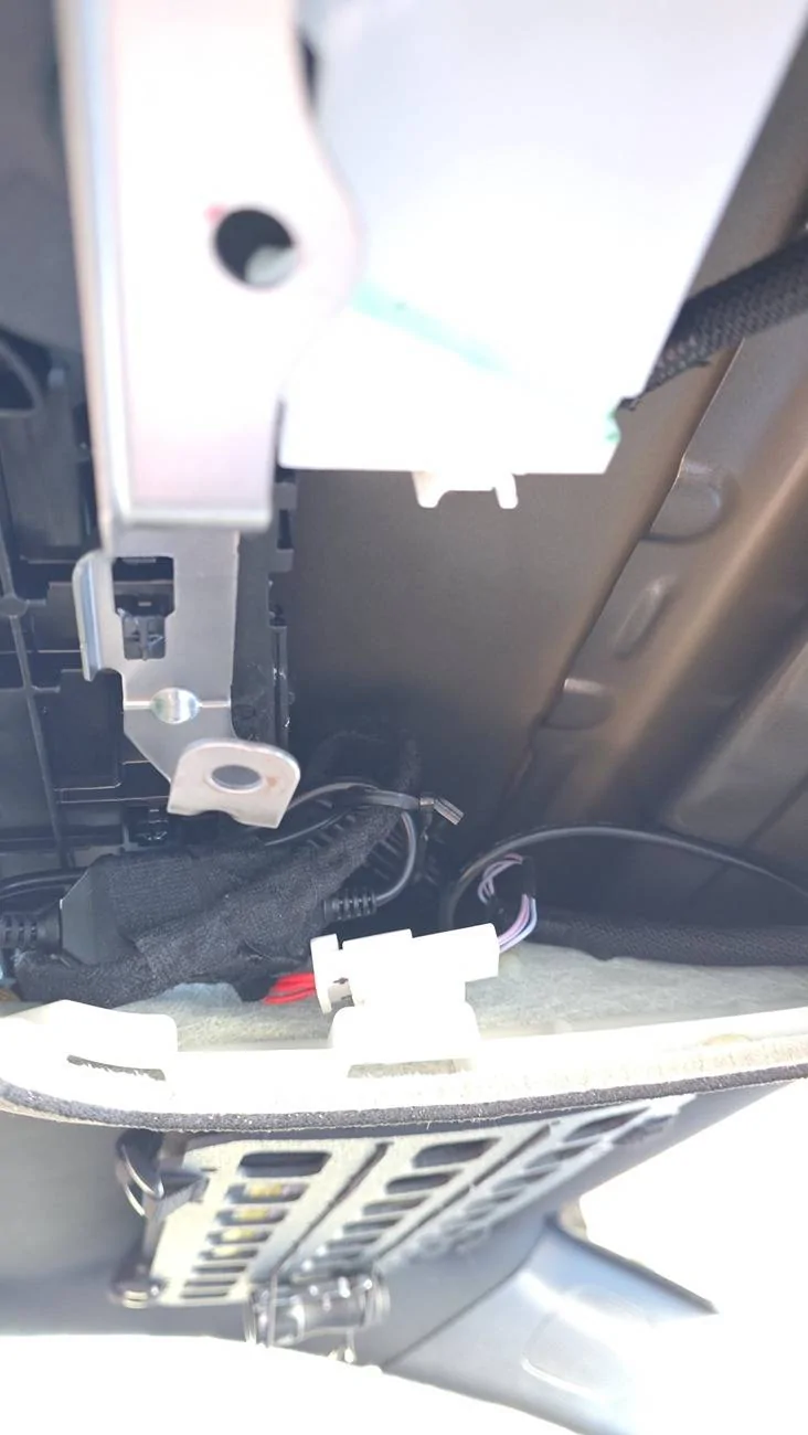

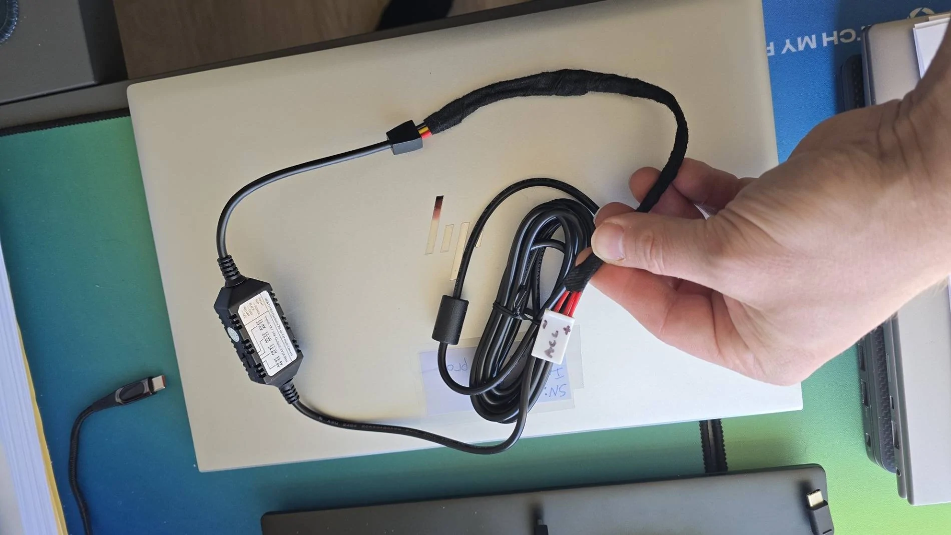

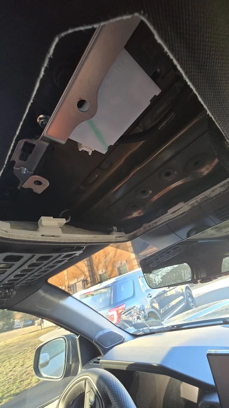

Installed Viofo A229 2CH cam. Leveraged the OEM dashcam connector up in the headliner for plug and play power. Got the hardwire kit and soldered on female oem pigtail for a plug and play installation of the camera. Ran the wires around the headliner of the car and about 20 minutes later, fully installed.
