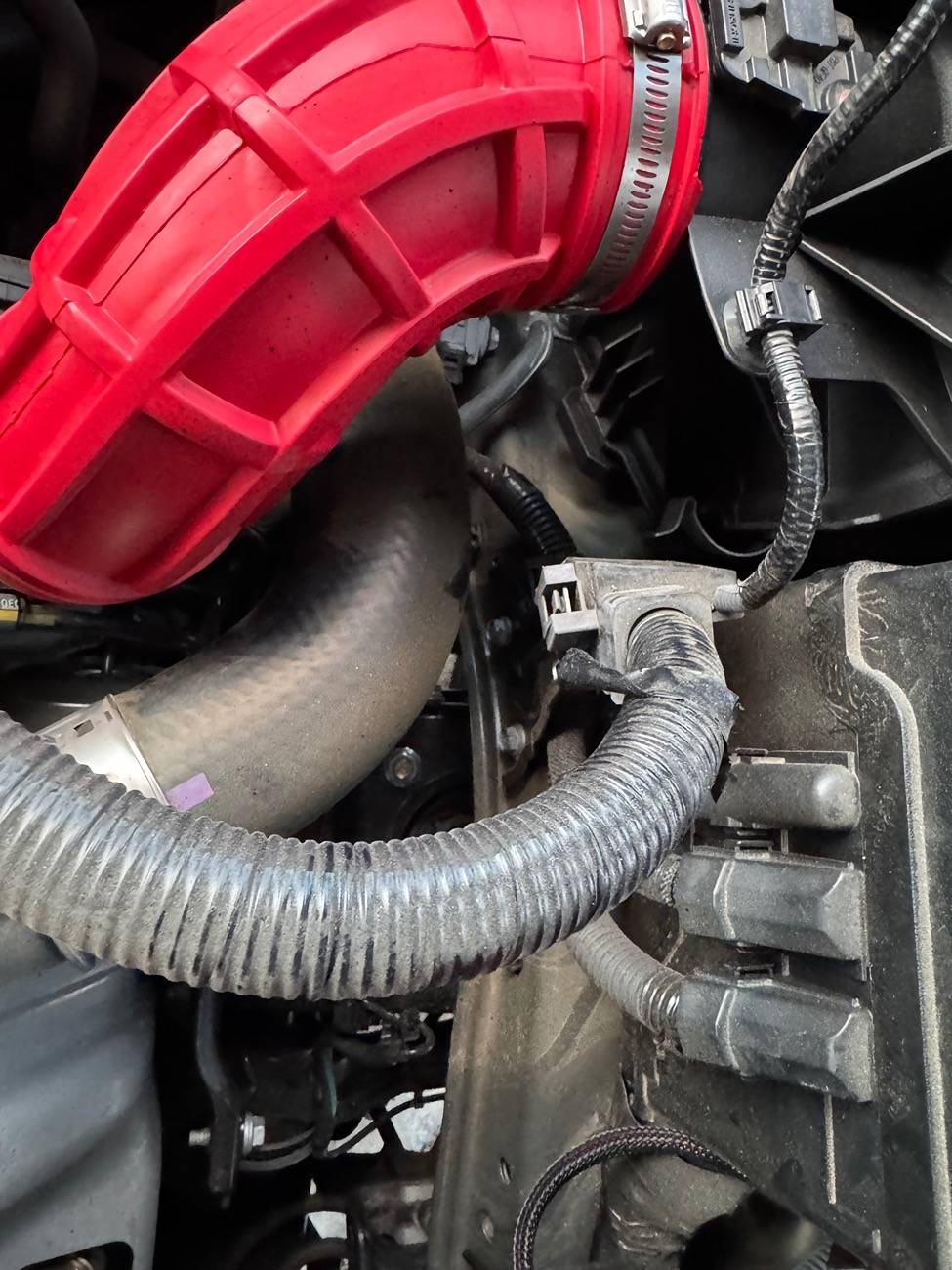

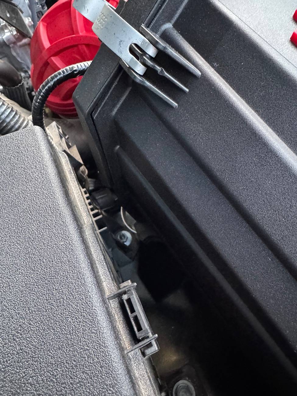

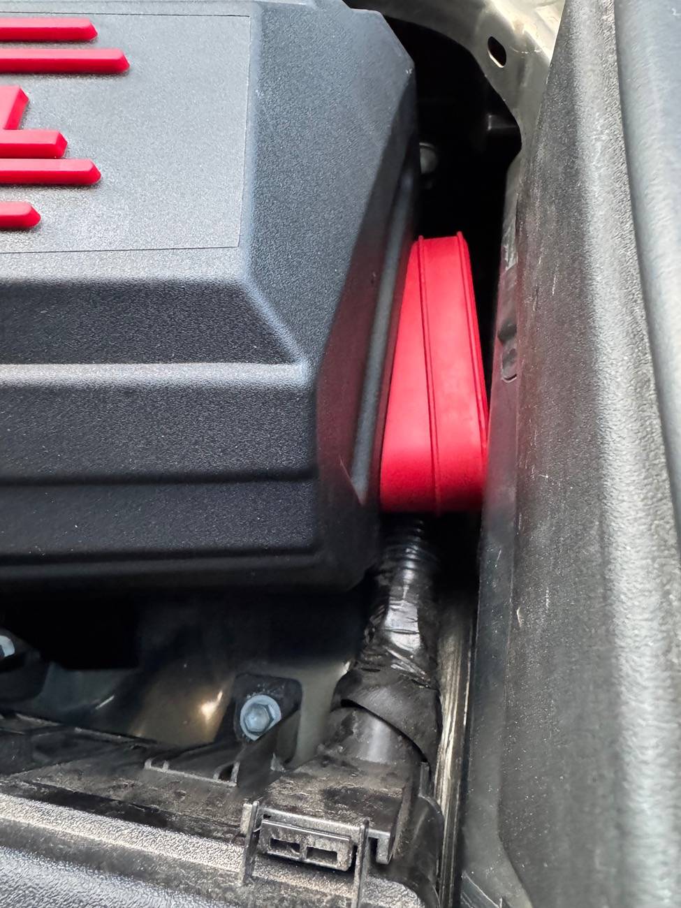

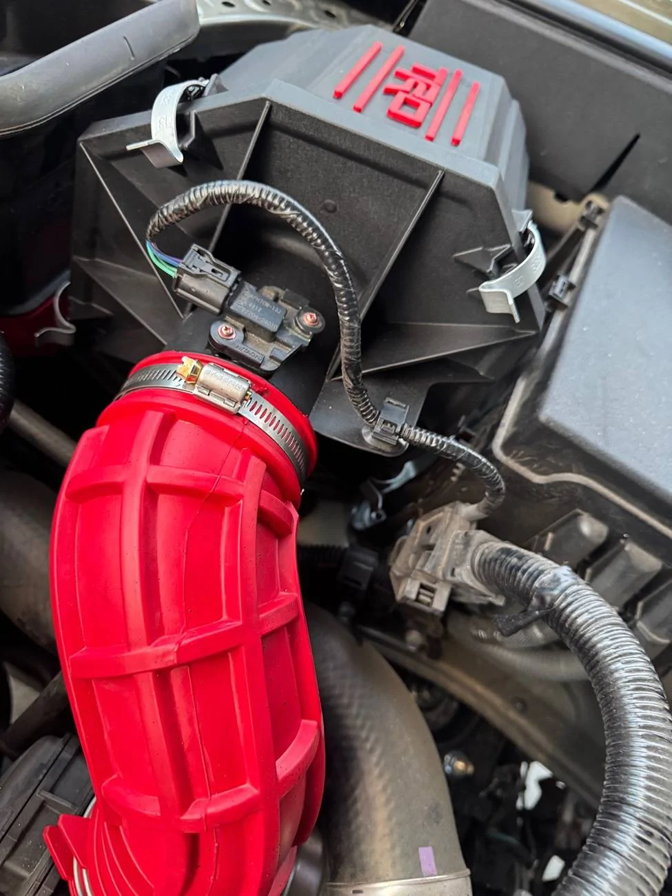

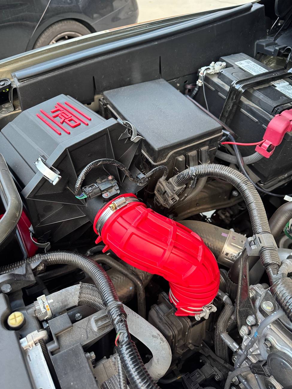

I just got mine in the mail today for my max OR any tips on install? Can you give any other pics from different angles ? Appreciate it
There are some videos on YouTube that show how to remove the air intake. This assembly is simple as well. Here are some other angles
Lmao my filter came in and I’ve been struggling to get clamp near filter on. I decided to do what you did lmfao

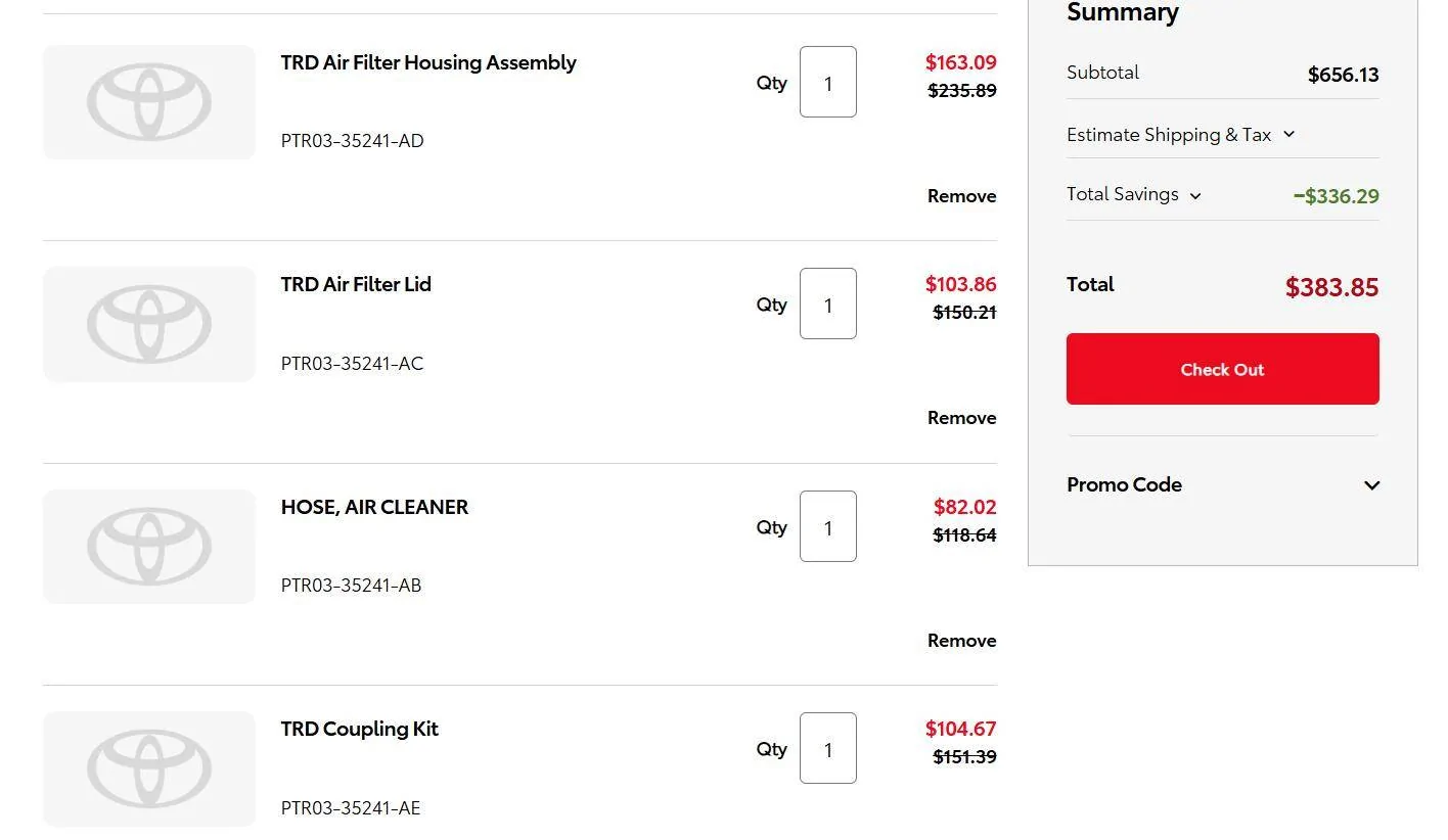

I found your thread while looking up part numbers. 4 of the 5 items are available with a discount from autoparts.toyotaofdecatur.com
It's the filter that isn't listed on their site, so I ordered those at parts.americantoyota.com
Hope it's all legit and the lead time won't be too long.

Can anyone that has bought the parts break out what is included with each component? I have the trailhinter airbox that is the same, but uses the port that routes through the high mount intake. This intake from the PRO has that red plug that plugs this port and has the red tube and the intake portion that connects at the front under the hood. I need those pieces and trying to determine how to get them/which components cover them...

I have all the parts except for the air filter, but I can confirm the TRD intake has a red boot that routes air from the fender into the airbox. The difference with the trail hunter intake is that the TRD doesn't connect to the high mount intake tubing, because it's not included. The TRD intake looks like it would also mount to the snorkel tubing if equipped.
The Part ID for this connection is PTR03-35241-AE.
The Red intake pipe from the airbox to the throttle body is PTR03-35241-AB
It seems the TRD Intake uses the same intake path as the other factory intake, but then adds a port to pull from the fender as well.
The Trailhunter intake then includes the snorkel system.
