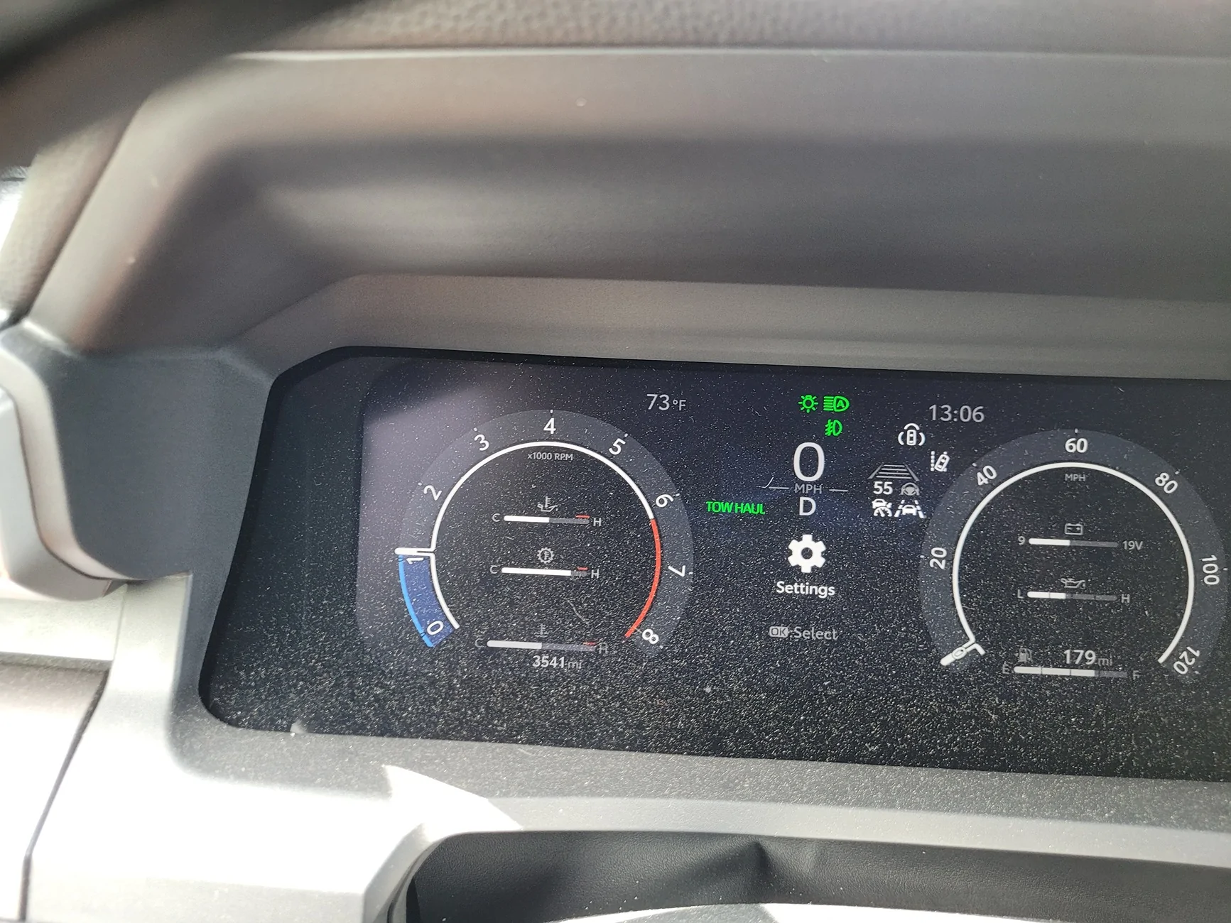

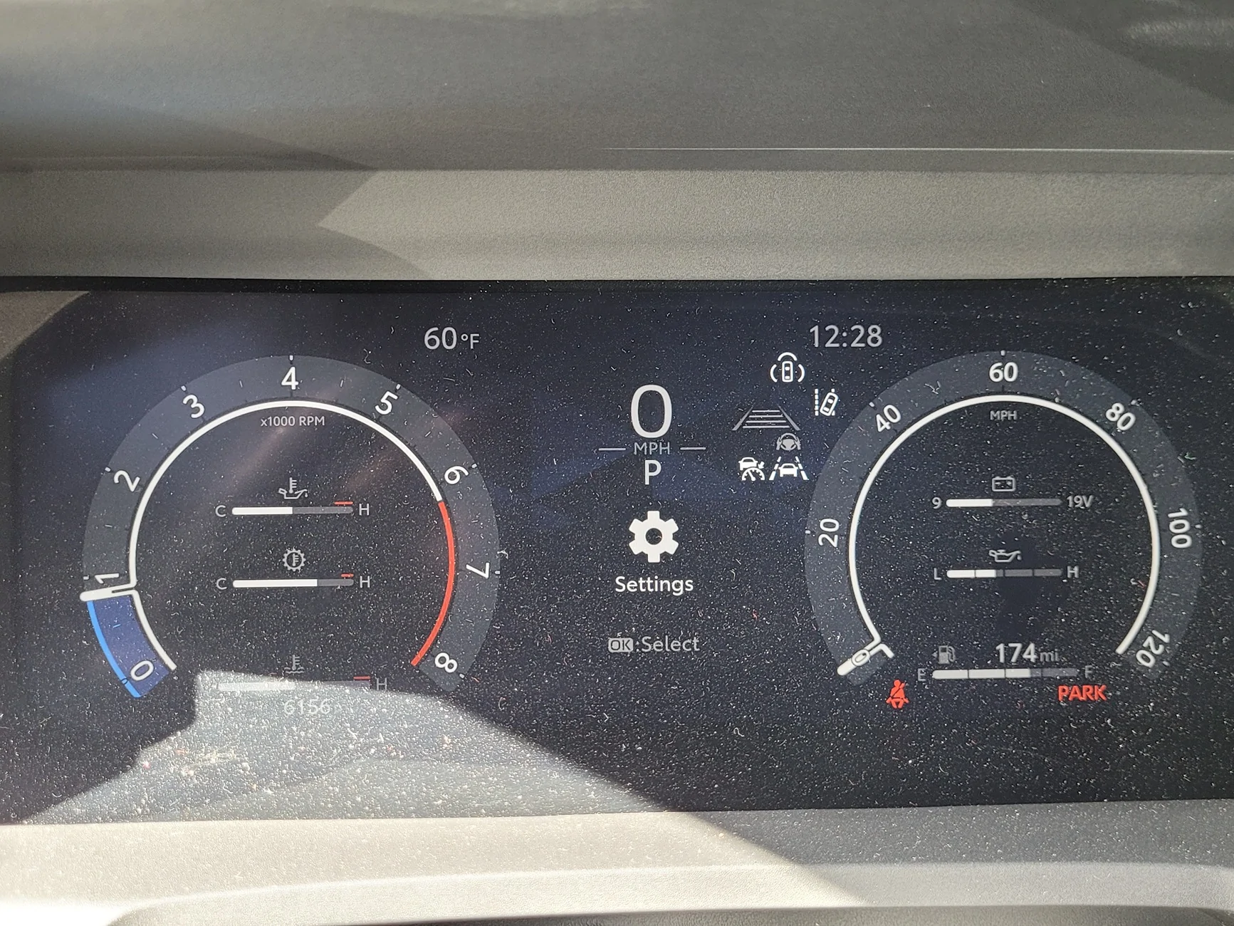

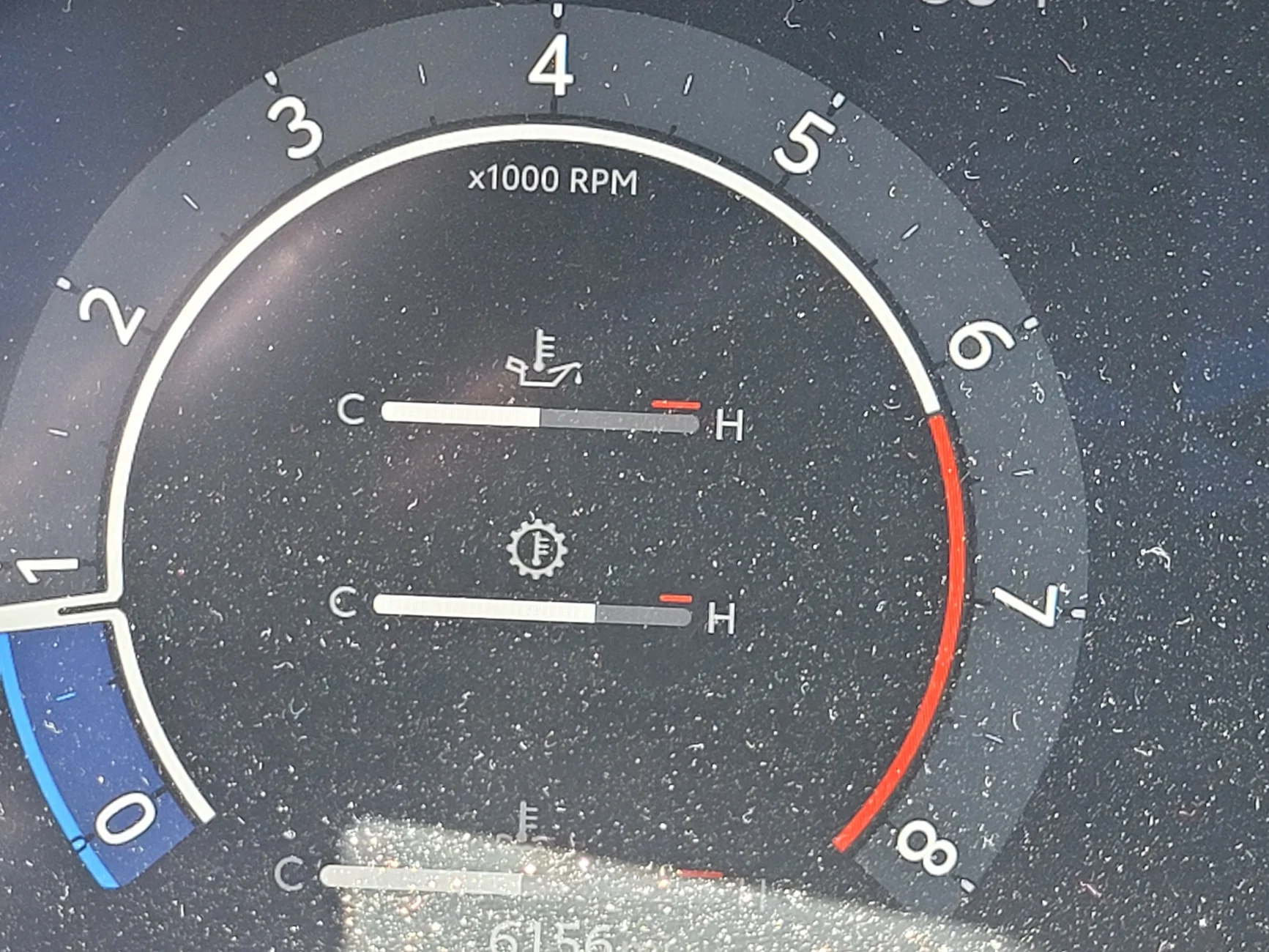

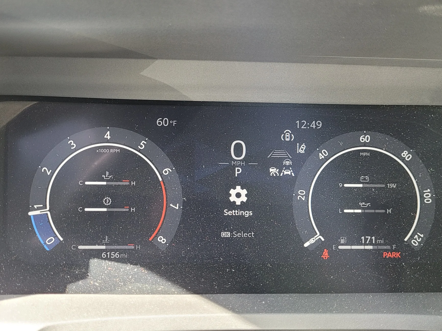

Now we drove up mt pack Monadnock which is much less severe but is still paved with multiple switchbacks and the transmission overheated again. It was a sunny 60F day driving up in drive in normal mode with extra light throttle not pushing the engine whatsoever with a 9 year old in the back seat. It took 21 minutes revving the engine in park to bring the transmission temps back down to the middle. If I could switch to 4low without the binding I would have, but these trucks don't allow disengaging the front hubs like the old trucks.
I'm going back to the dealership next week, but I don't know if this is a transmission issue, or programming issue, or cooler issue. The master mechanic said when he tested the transmission the temps spiked up quickly, but the fluid didn't look burned etc when I brought it in originally. I'm worried for obviously the life of the drive train, being able to use the truck for actual work, and to be able to bring my little one on these fun trips with the family. This was one of the big reasons we bought the trd offroad non hybrid model....

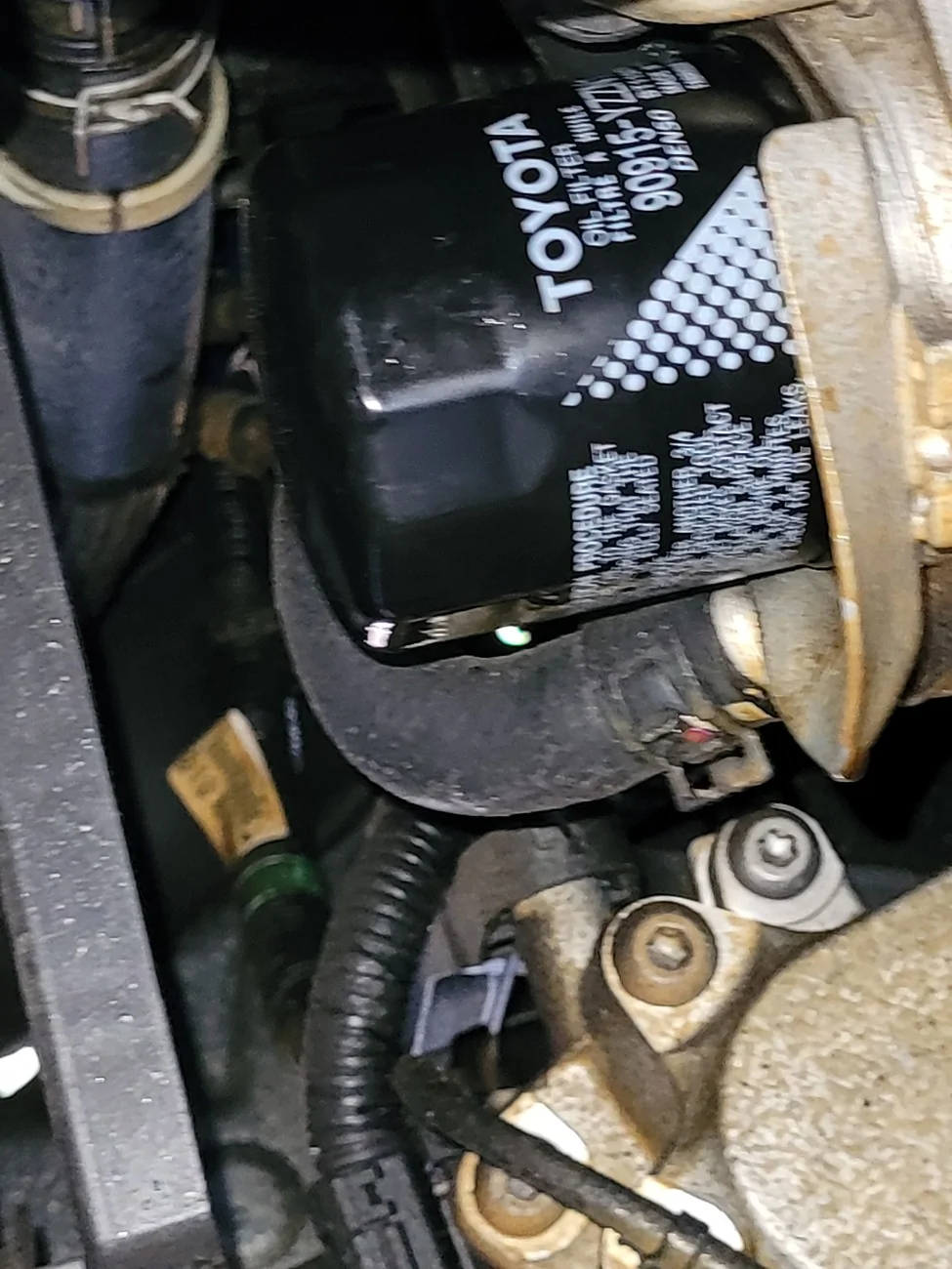

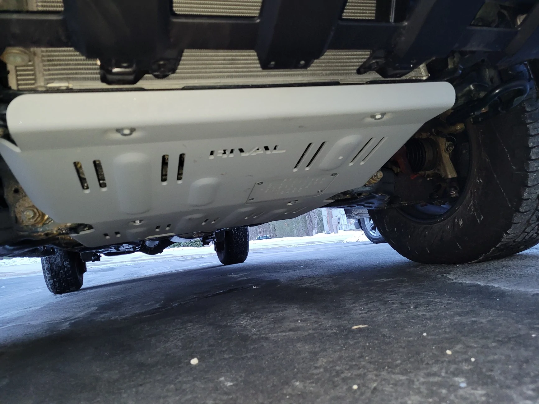

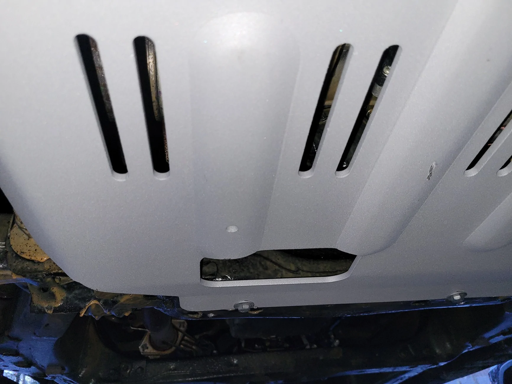

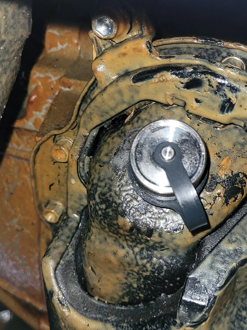

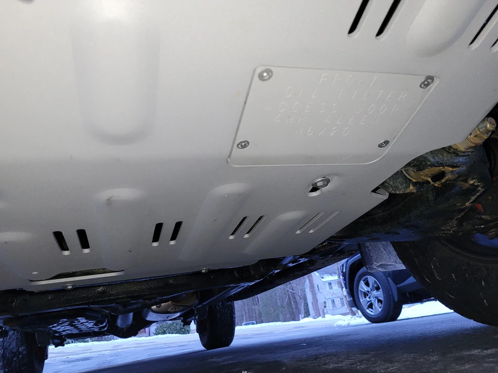

On a side note for anyone that has a skid plate. I have a rival skid plate with the oil filter acces door and a valvomax quick oil drain plug. I let the service writer know and gave them the drain adapter fitting for the 12 month service which includes an oil change. The service writer was skeptical of the drain system and said it might void warranty. They also watched the technician drain the oil with the adapter and remove the oil filter without issue. They said it didn't spill a drop of oil and they didn't have to pull the skid plate. Technician and service writer were both happy making it easier and faster for the staff. A big win all around...
