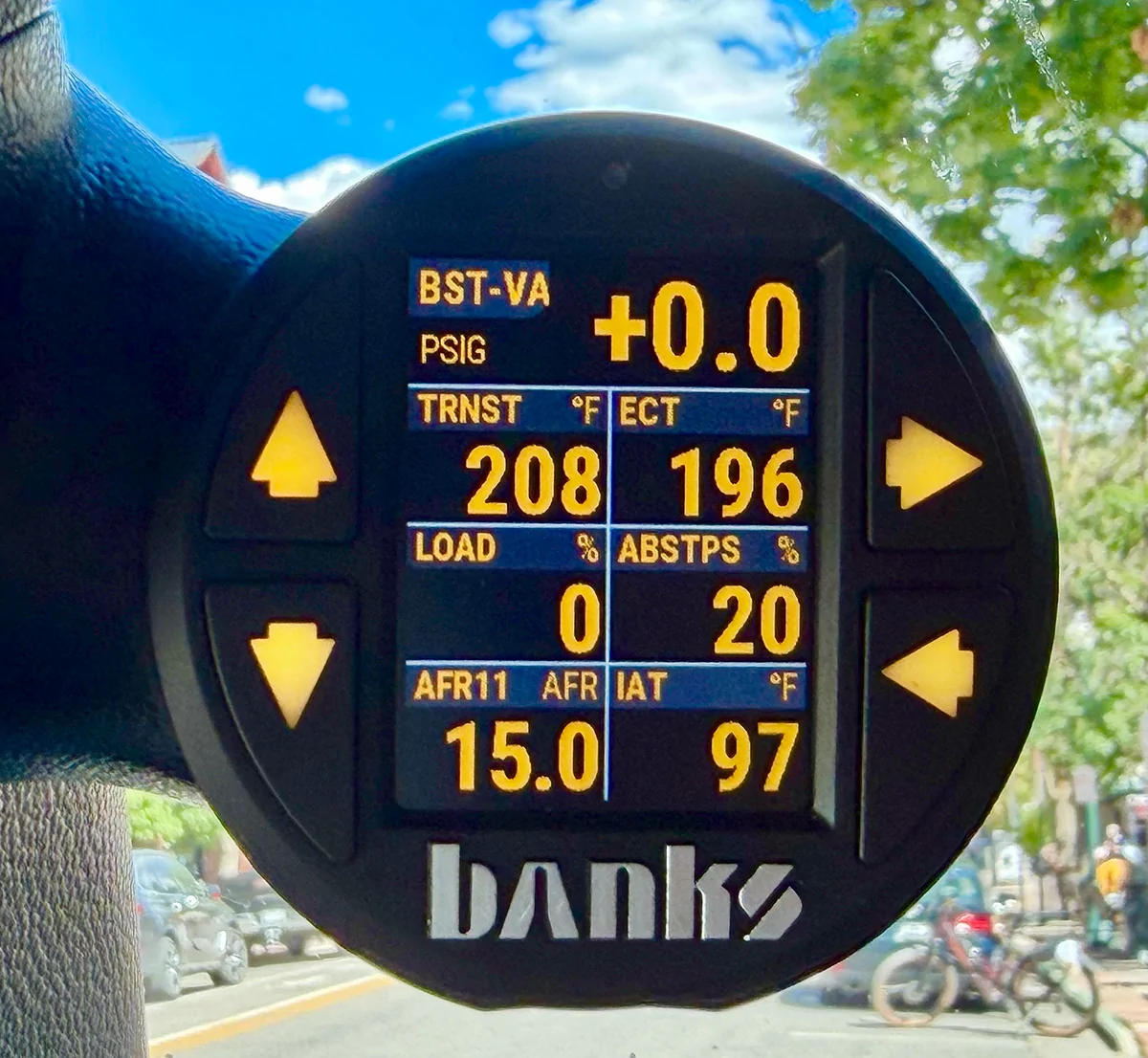

In my opinion and experience in owning several turbo and supercharged vehicles, having real and reliable gauges that go beyond the OEM ones are a must.
As I waited for my truck to deliver, I weighed the pro and con of the Scangauge III and the iDash and hands down, iDash is simply *the* way to go on these trucks. With the app it is super fast and easy to program and re-program any and all PID's into one of 5 different gauge readouts. Install was super easy and it is really clean in the gauge pod out of the way.
My only regret is not coughing up the extra coin for the data logging version since OTT is now talking about partnering with Banks and would logically use that feature for remote tuning adjustments.

Problem I see with the iDash is it only displays the 2.4 L engine. Not the Hybrid version. And I have a problem with a device that says it can display speed and velocity as velocity requires a direction..

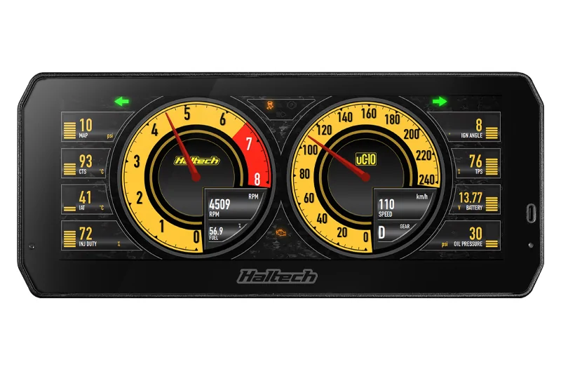

Ive been eyeing various guages like the idash myself. I was actually impressed by the guages Toyota provided in these trucks. Dummy and outright fake guages have been the norm for decades. Ford for instance was notorious for fake oil pressure guages in their trucks, which only requires around 10 psi to put the guage in the "normal" range.
But I still prefer hard numbers vs the vague guages we have. Id also like more customization in the cluster. Plus, I don't care for the aftermarket guages just hanging off of pillars or suction cups and the rest of that nonsense. Id love it if a company did customizable gui flashes on the cluster. Adding numeric scales to the guages along with style and color changes. I posted it before in another thread, but imagine if you could have a cluster that mimicked a Haltech cluster in a bronze oxide truck:
2024 Tacoma 2024 Tacoma Transmission Overheating on Long Climbs Off-Road 1000003152
