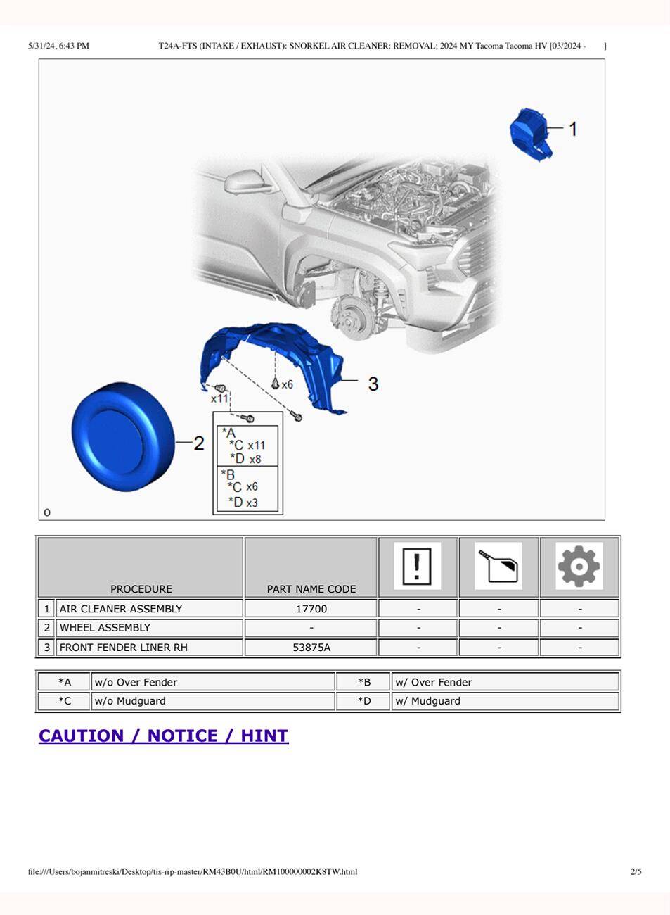

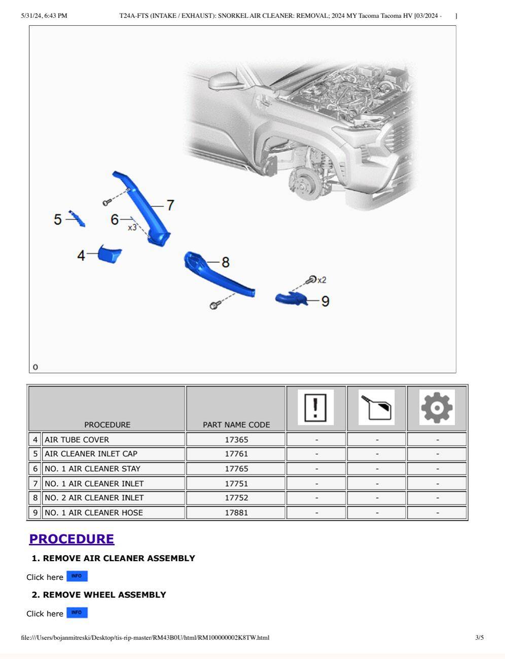

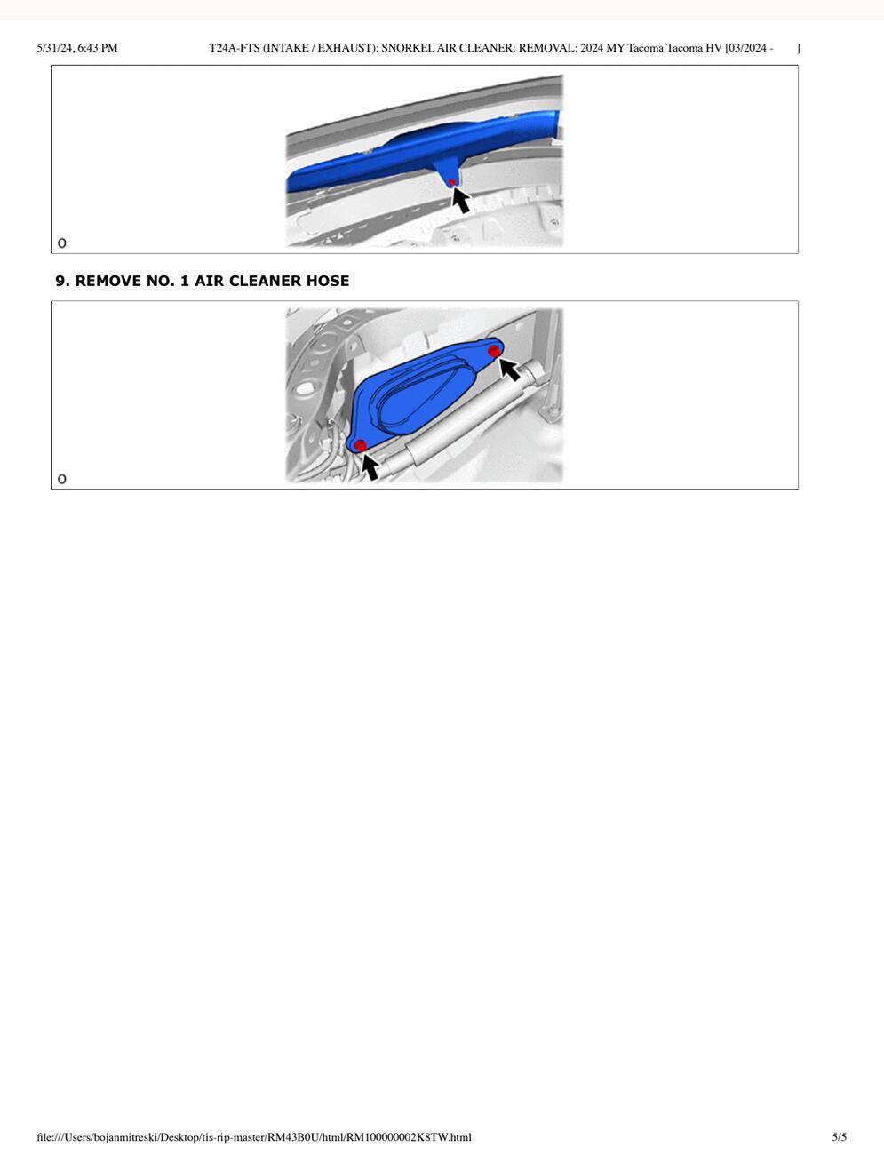

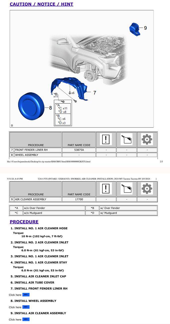

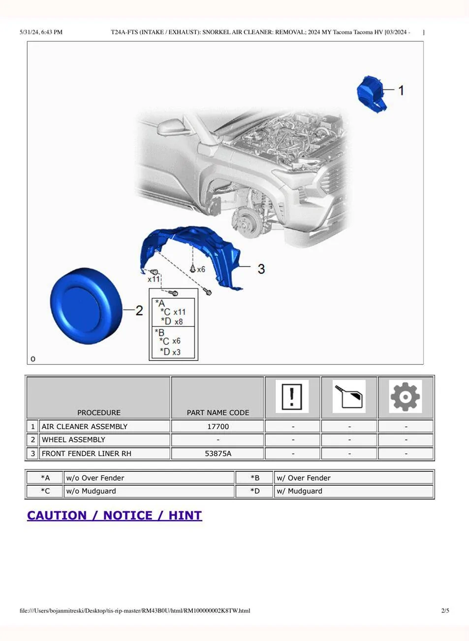

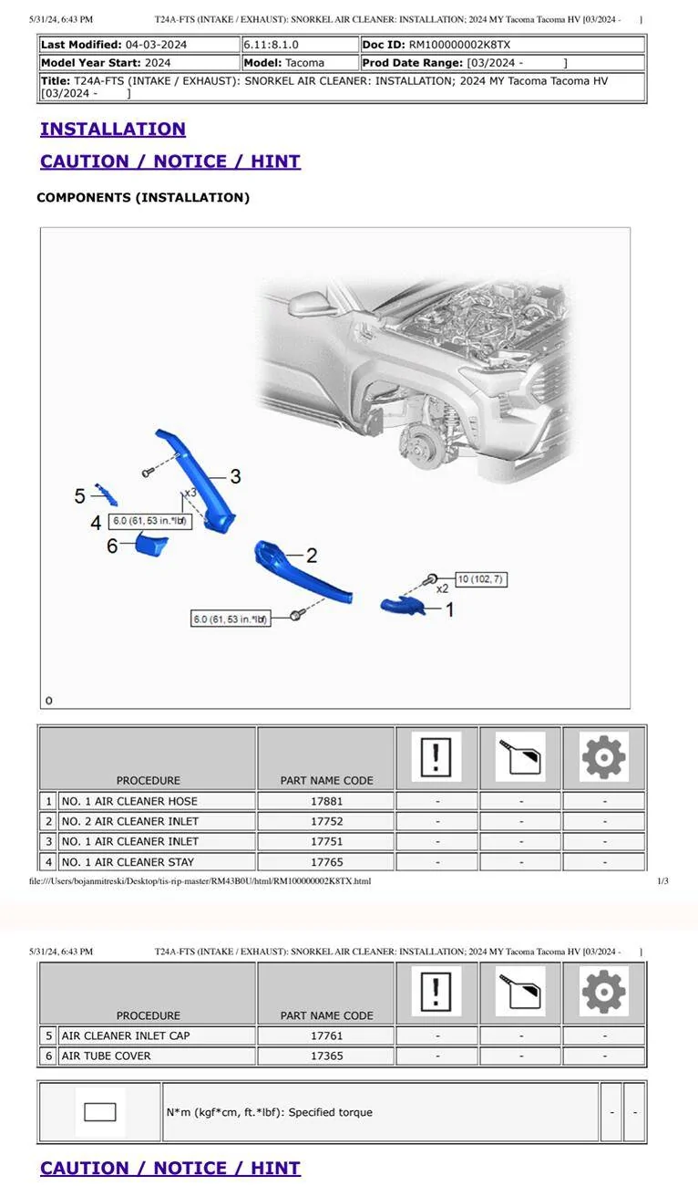

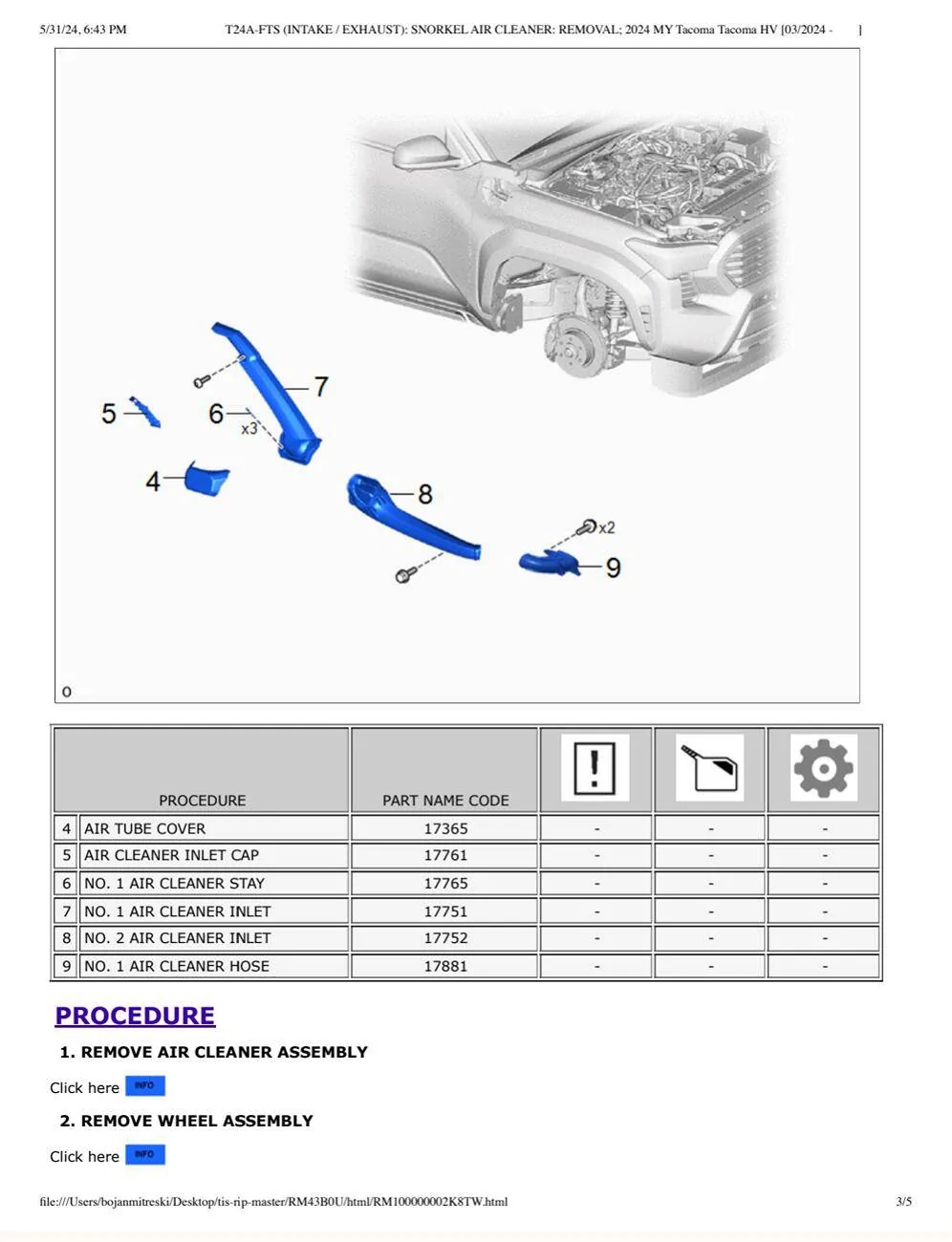

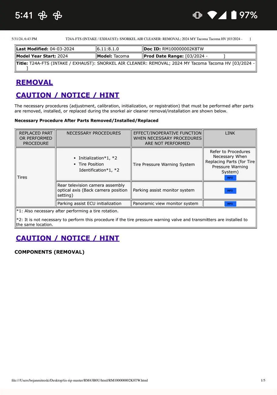

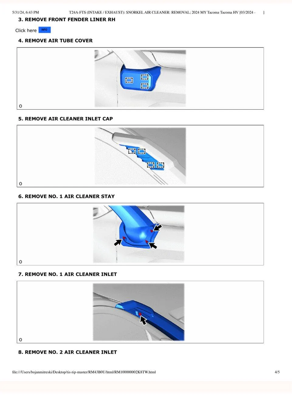

Do you know how to fully remove the snorkel, specifically the top mount where the intake meets the a-pillar? I'm planning to wrap the vehicle and need to temporarily remove it.

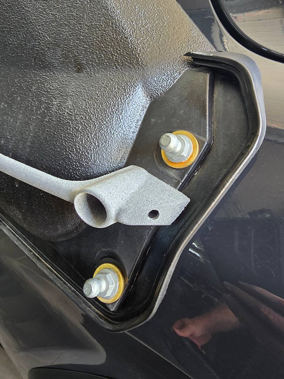

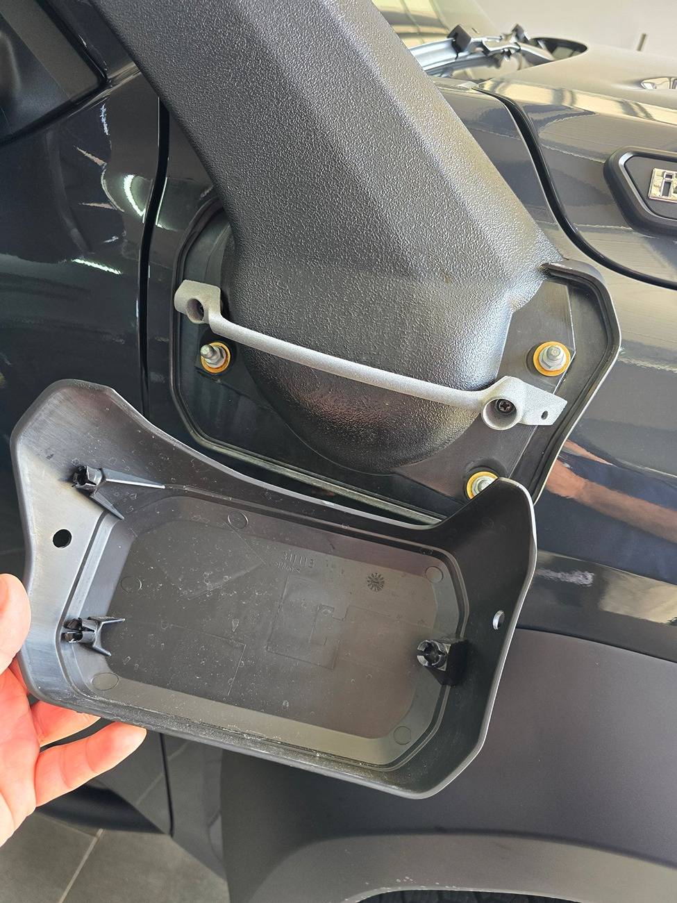

That doesn’t seem to be a very good solution to me.
Yeah I agree, but at least they changed it from how it was. So far it hasnt come off yet like the originals did.
