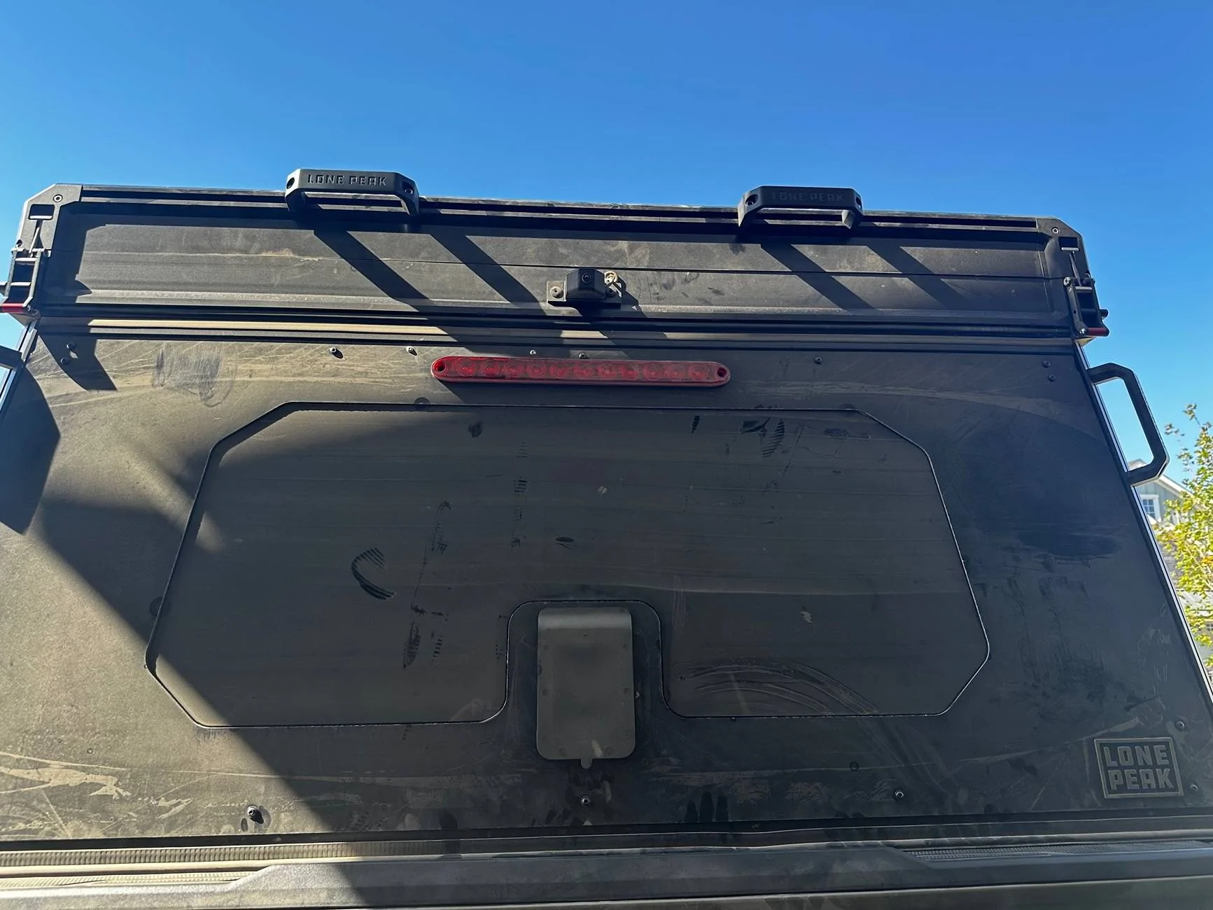

question for you about your 3rd brake light on your Lone Peak: how did they tie-in on your TH's brake light on the rear?
I did GG Offroad’s camera relocation kit and know exactly where the OE brake light connection is located but just curious if the guys at lone peak tapped in an easier location?

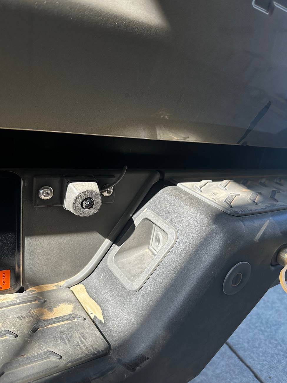

So LP didn't not wire the 3rd brake light. I had Juniper Overland here in Denver do all my interior buildout of electronics, water tank/pump, other lighting, etc so I asked if they would wire it and also mound my GG Offroad camera relocation. They did all that. The camera relocation already had the wires run and connected, but it just wasn't mounted yet. Unfortunately I'm not sure how they tied the brake light in. Here's a pic of where we mounted the cameras from the relocation.
The top one above the LP is the rear view mirror camera, and the one near the license plate is what used to be the "cargo camera". It didn't seem like it would be very valuable to see inside of the LP so I had them mount it by the license plate so that I can see what is directly behind me if need be. Not super necessary, but added an extra view.

thanks for that info - I’ll ask Juniper directly if they want to disclose how they routed 3rd brake lights.. I like the cargo camera location; debating doing some kind of roof mount view because I carry outriggers and long boards half the year.
does the your 3rd brake light bar on the LP ‘wash’ your rearview camera at all in that location? Nice crisp & uncolored video? No fuzzy halos from the red LEDs?

Nope, no issue with the camera. I hadn't even considered that, but yeah can't tell it's there. If you don't hear from Juniper I can ask them as well.

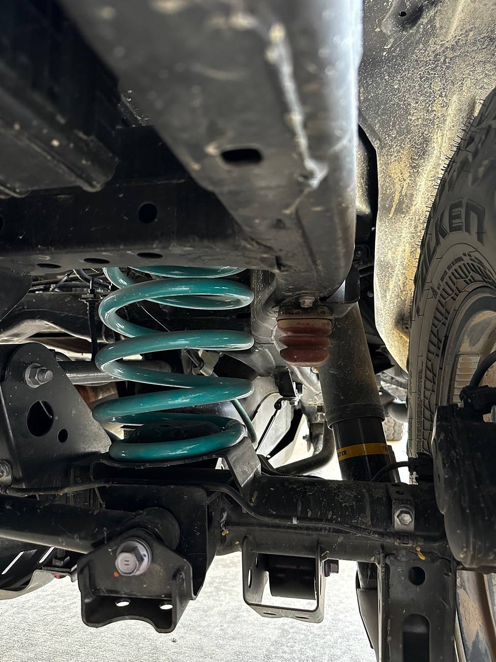

How do you like the Dobinsons? Did they keep the back of Truck at the expected height? Were they bouncy? I think you got this ...
  • C59-821V (30mm - 1.25") 880-1210lb Load
2ndGen2TrlHntr
2ndGen2TrlHntr
Alex
Nov 8, 2023
207
349
Denver, CO
2024 Trailhunter Bronze Oxide; 2018 Audi S5 tuned
Love them. Not bouncy at all, rides great, height is perfect. We did our first camp last weekend with all the new gear including the Dobinson's and it performed flawlessly with little to no sag. I have a couple pics below of the truck so you can get an idea of ride height in the back loaded up and the space between the frame and bump stop with the new Dobinson's.
