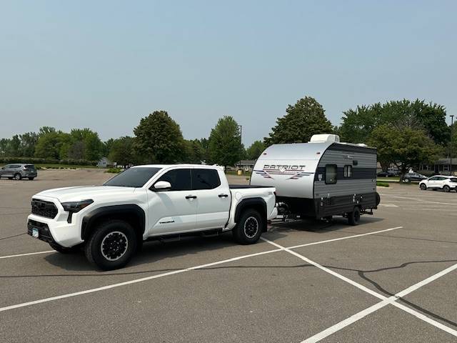

Reference photo. This is my new 25 Tacoma OR with a 4K camper, approx. 400lb tongue weight. I'm using a weight distribution hitch. I have approx 1.5" of rear sag and no lift to the front. The hitch puts the weight back down on the front so it doesn't lift. I could (and did while adjusting) dial out all rear sag but then I wound up with a drop to the front suspension which is no good.

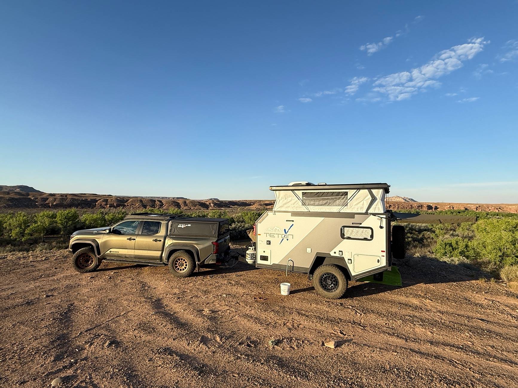

Just spent the past month towing a TetonX Hybrid (about 3500#). Towed great.. MPG sucked, around 10-12 MPG. BUT the back end sagged like crazy.. Was not expecting this much sag.. Now looking at airbags or stiffer springs. Not sure which.. The TrailHunter already has a pretty stiff ride and someone said their ride improved without loading with stiffer Dobison springs.. But the price has also jumped 10% in past month since I have been looking at them.. we put 4000 miles on trailer pulling from UT to TN..
Weight distribution hitch or Airlift bags. If you are able to use the hitch I recommend it as it retains proper front end weight distribution. Bags are also a great solution. You could go extra and do both.
Any questions on them just ask. Some may have been answered already but happy to help with any questions.
A 6k (or even 4k) Fastway E2 trunion bar would be perfect for you.
