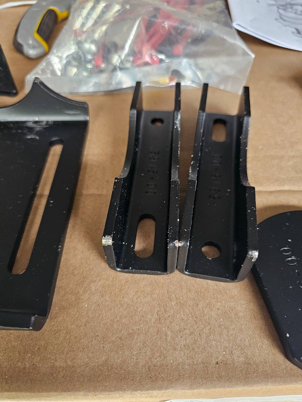

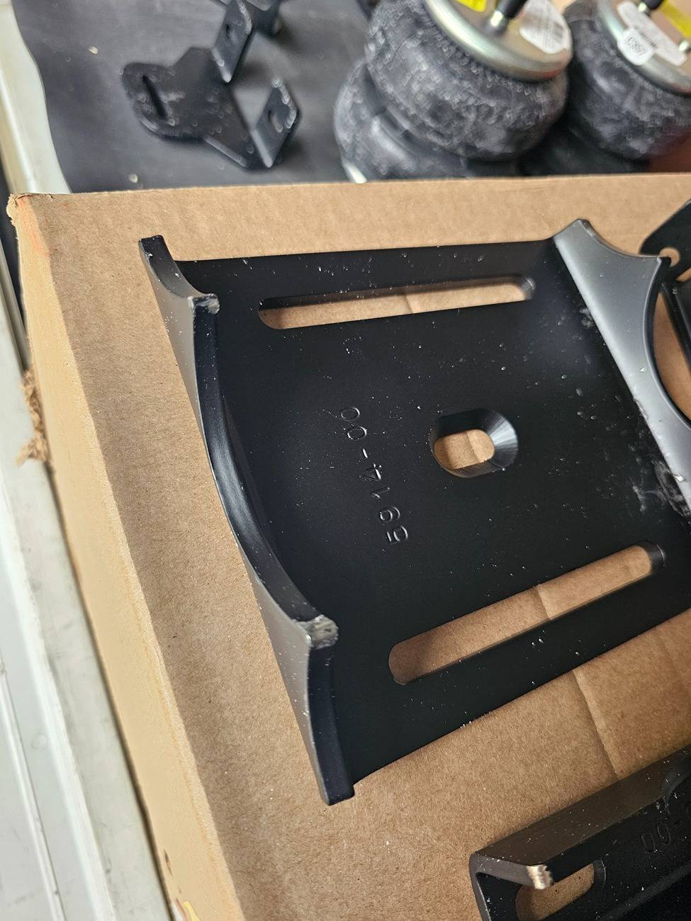

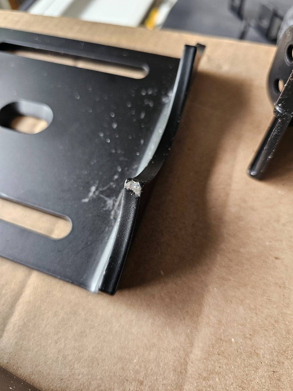

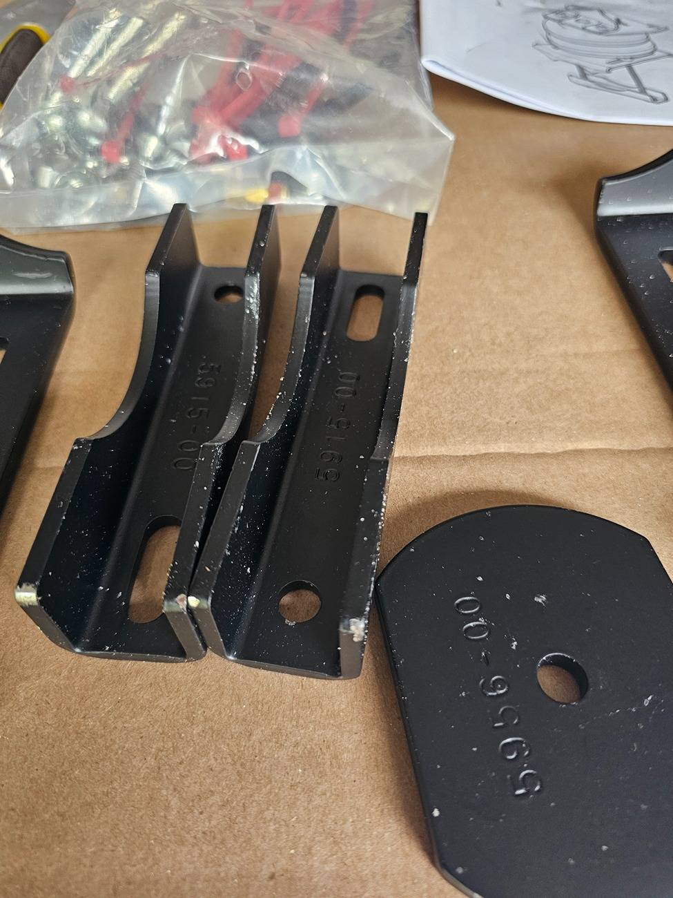

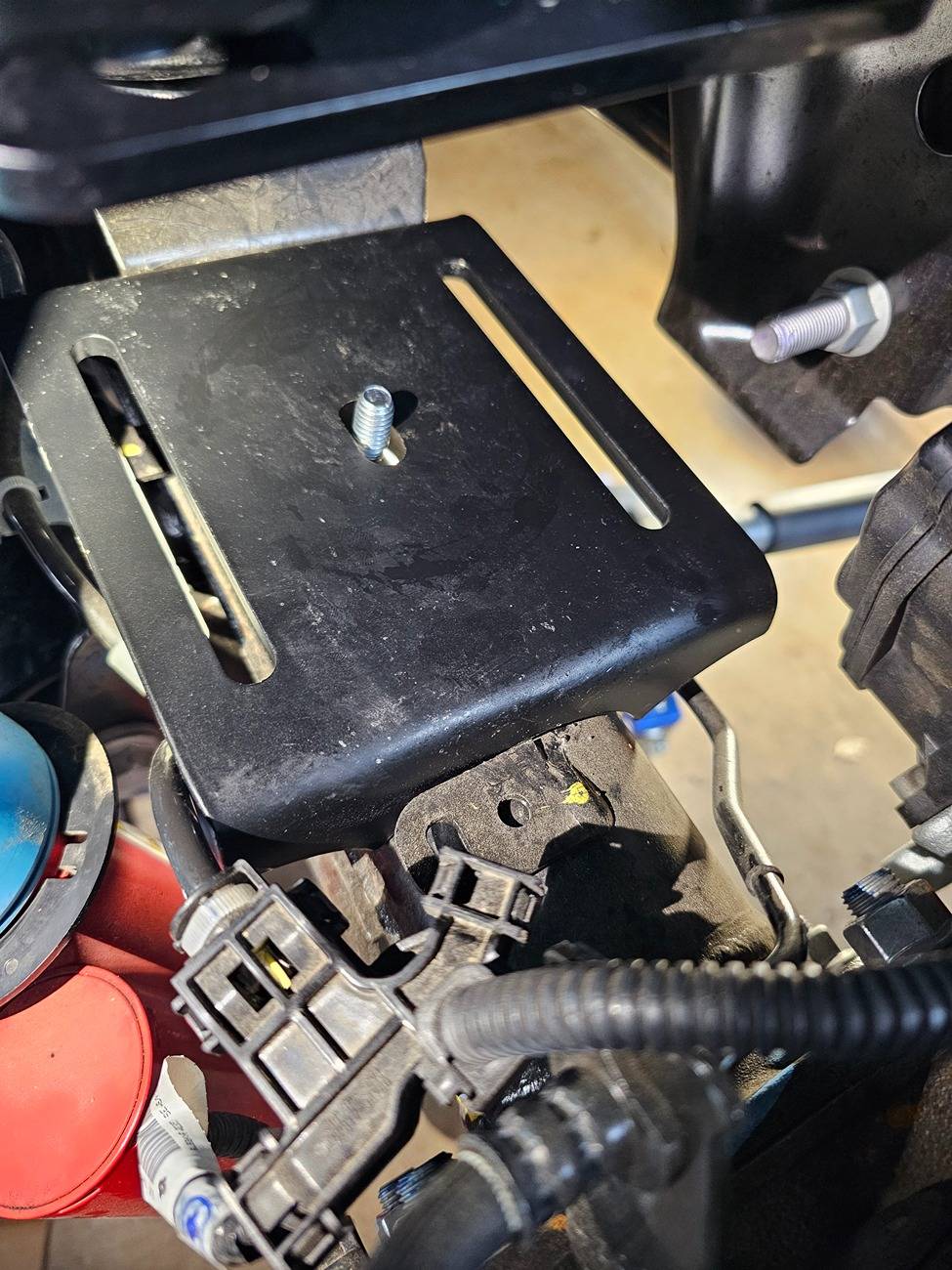

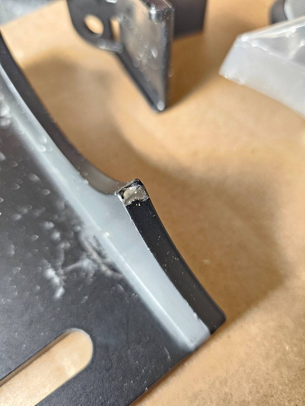

Has anyone successfully installed Firestone airbags?
I had a go with the Firestone RideRite 2599 kit today and it was a fail. First, all the metal mounts were chipped from shipping. All the parts were thrown in the box with no packaging material. The metal mounts, parts bag, air hose, and air bags were just fighting each other and the FedEx man... the parts bag was even broke open and it was pretty thick plastic.
I kept it and touched up all the bare metal thinking that it would be fine.
Partially through the install I realized that the bottom mount was not going to work. The top mount was a one-for-all deal and did not mesh well with the frame but it did go into place.
The bottom mount required a wire plug to be moved and zip tied to a nearby wire loom. Removing the plug from its mount did not give enough room for the suspension to cycle without rubbing something. Worse, the bottom mount is attached with some really long carriage bolts. If anything were to get loose and the bottom mount clocked itself rearward by about 1/2", it would take out the brake line.
I'll post some pictures.

Also, for context, I ran Firestone airbags on my 2009 and 2017 Tacomas. No issues with fitment or leaks. And I'm a humble mechanic. I don't know everything but have enough knowledge to adjust or fabricate as necessary to make something work. For what I paid and how it was going with this kit, I was not into modifying the brackets or my truck for something that should have been bolt on.
1986Bronco
Apr 26, 2025
1996 Sambar, 2021 V90, 2023 Bronco Badlands, 2025 Tacoma
Some pictures of the outcome of the shipping battle.

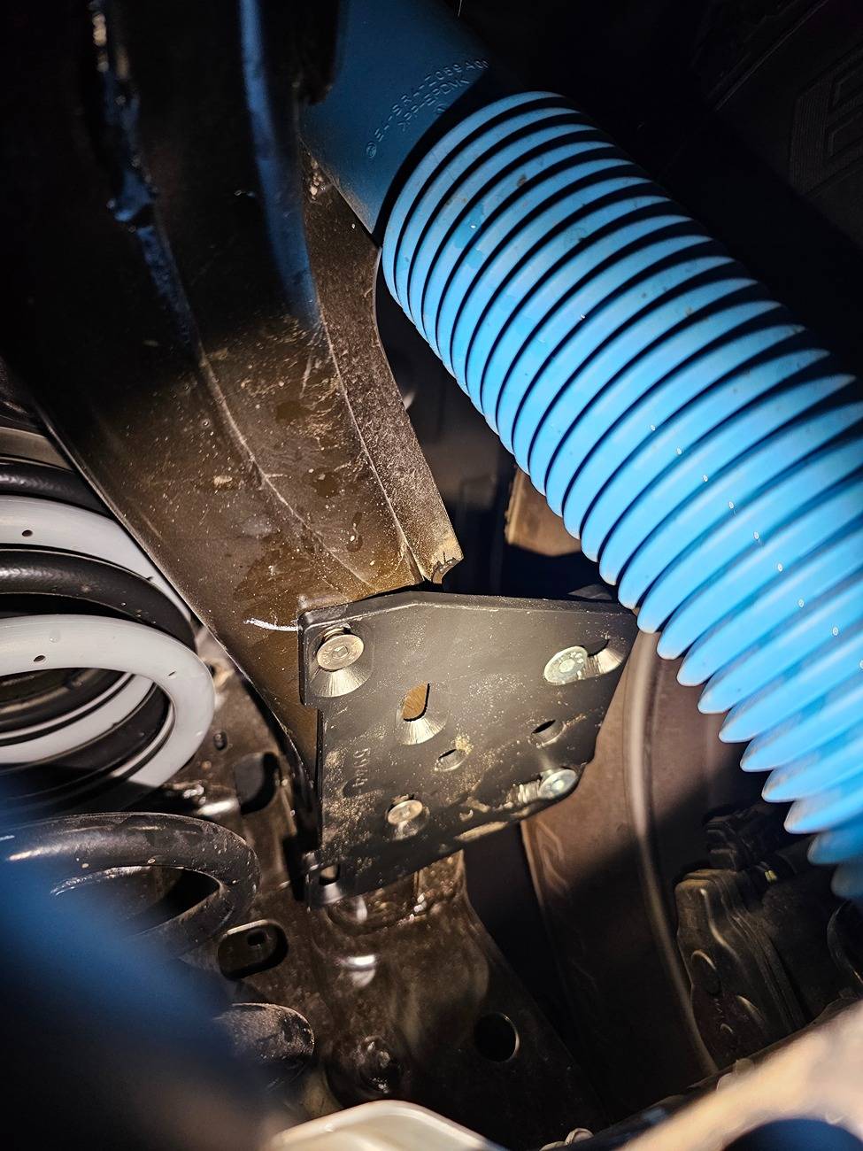

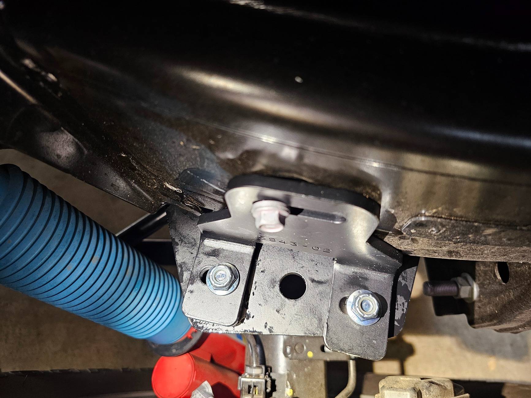

Top mount as the directions say it should fit (not tightened down yet but in place).

I would prefer the Firestone bags because of my history with them on my Tacomas (I'm also a diesel mechanic and deal with airbags pretty often) but this kit is not ideal. Something is off. It started with the shipping issue but definitely did not end well with parts fitment. If another kit with parts specific to this year Tacoma comes out I will give it another go.
Actually, if we get another member on here to get it to work, I will give it a go.
As of now, I cannot recommend it based on what I received.
1986Bronco
Apr 26, 2025
If you look at the picture of the bottom mount you can see what I mean with interference if it clocks forwards or backwards for any reason. Properly tightened with the bottom half, it should not. But I have seen these types of clamps shift back and forth and I am not familiar enough with how this Tacoma's suspension cycles to say that it is impossible.
