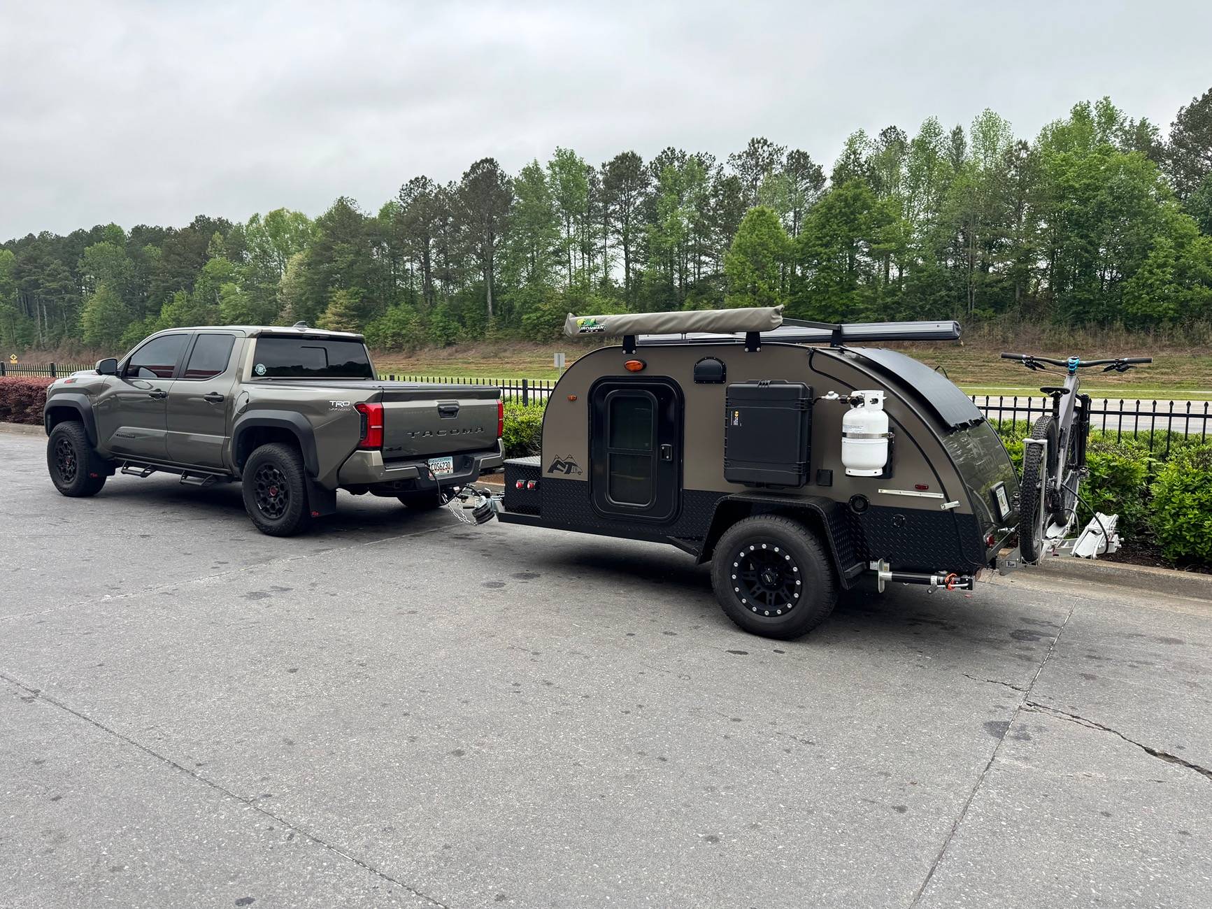

I had the Firestone Coil-Rite airbags on my 2019 4Runner and they were fantastic. I did the install and it was really a pretty simple install, just took some patience and a couple of hours. Etrailer says the coil rites don’t fit the new tacos, but I dont’t know why that would be the case. They aren’t expensive, so I will likely take a chance and order a set.
I plan to do the same on my Taco. I have the OE springs and Westcott spacers for a slight lift and to see if that helps, which it doesn’t. I have the AllDog’s rear springs ready to install and I think I’ll install airbags at the same time.
Agree completely about the trucks performance towing.
My teardrop and MTB setup.

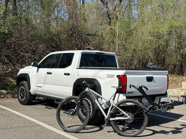

I threw a picture of my Tacoma in for fun with my MTB. My Tacoma has since gotten 285/70R17 Open Country tires and some tint, as well as a new Kuat Piston bike rack (amazing!). I use a weight distribution hitch for towing my camper but I will be adding airlift bags here soon to supplement.

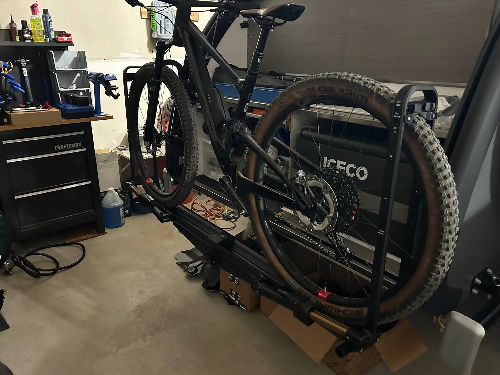

Ha! Carguy…we must be neighbors. Are you at Lebanon? Here is my setup on the back of my Bean. I don’t have my bike on my current trip. I definitely will be installing air bags when I get back.
