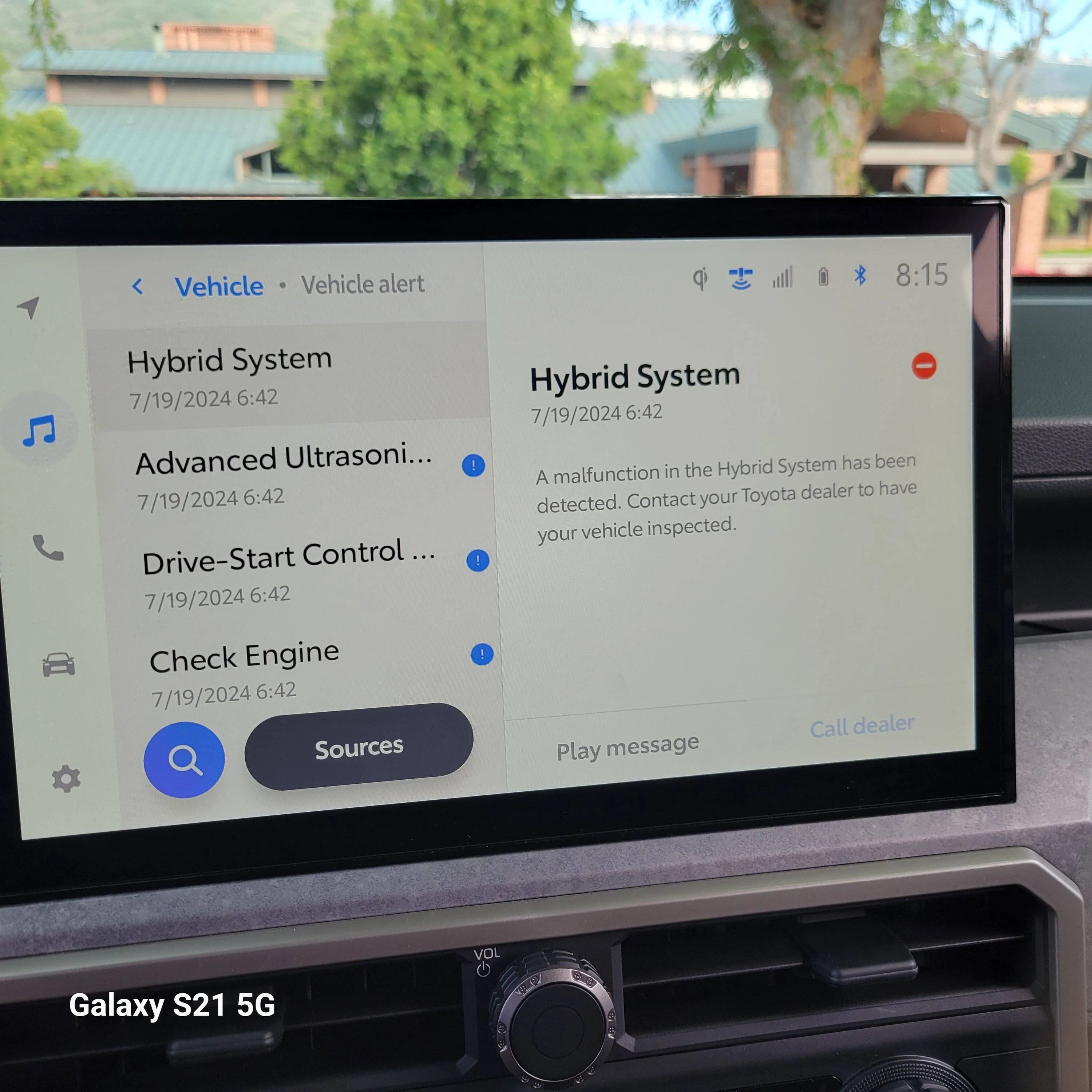

Oh boy, just had the truck at the dealer for what ended up being a short in the ds bed scene light rail. Finding that had half the truck apart tracing the issue over 1 1/2 days.
This morning all these vehicle alerts popped up. They are dated from the service time but just appeared this morning.
Sounds like the dealer might’ve missed/did something wrong?

I'll find out tomorrow I hope. Wondering if everything they may have taken apart isn't back together properly or just disconnecting stuff might have triggered all these alerts and the just need a reset. I'll let them figure that out!

Alerts had been triggered as they were testing circuits trying to find the issue with the cargo/bed lights. Why the truck took two days then give me the warning on the dash and then have that disappear they couldn't explain. They cleared the alerts in the multimedia system and they haven't come back in over 150 miles driving.
