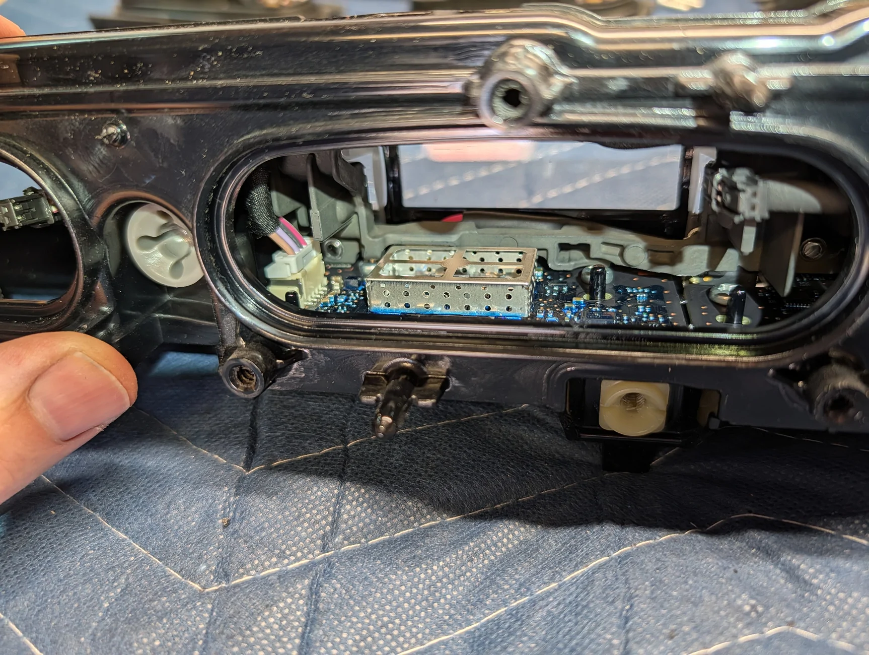

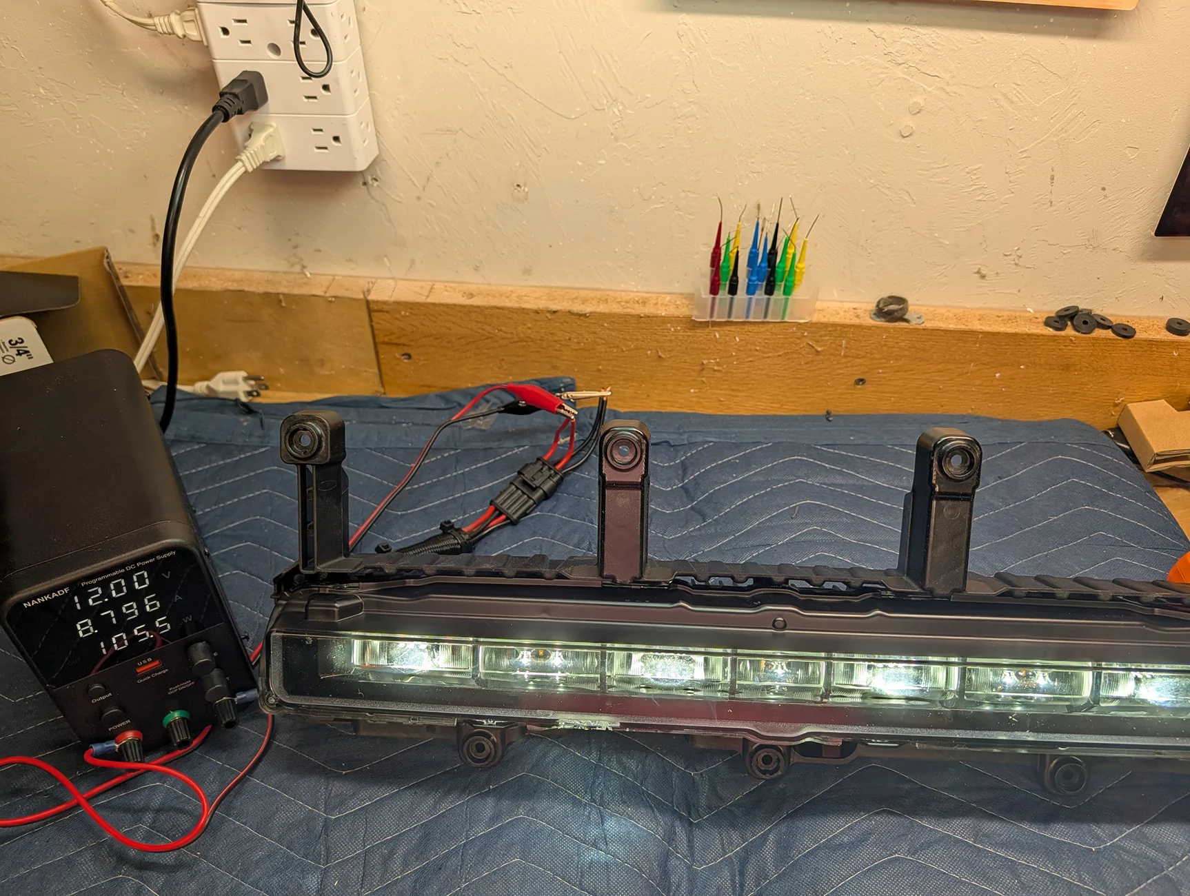

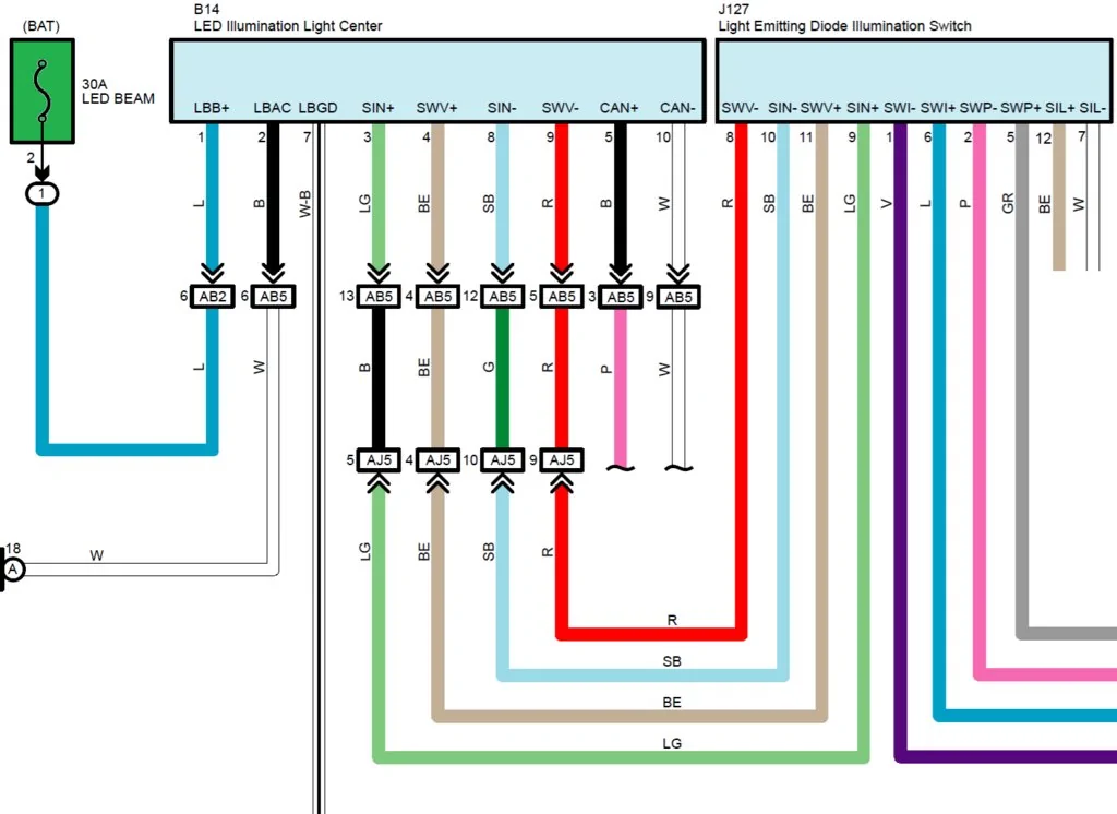

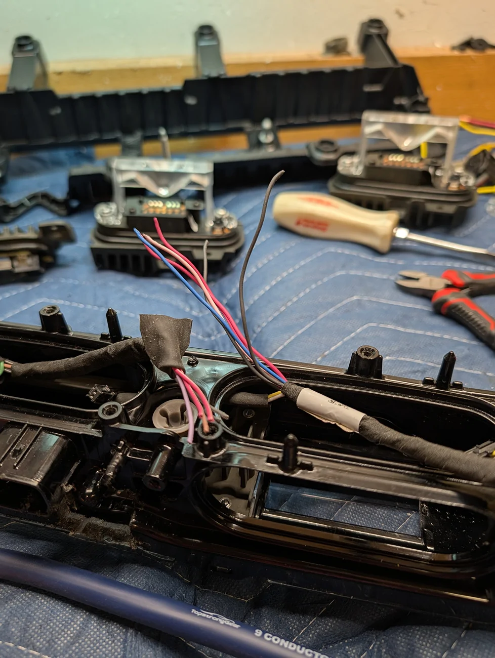

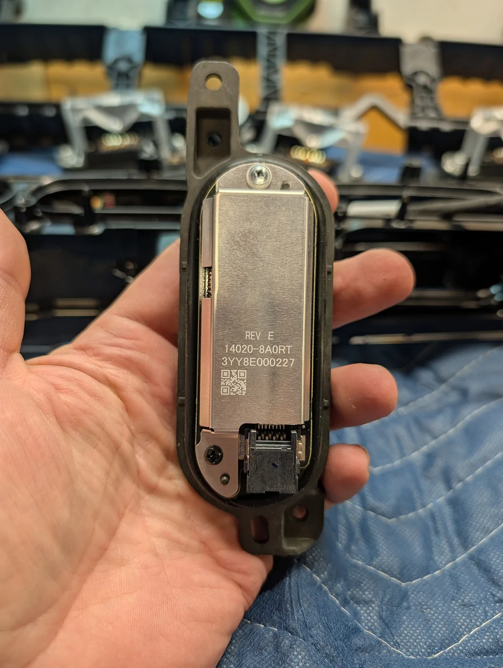

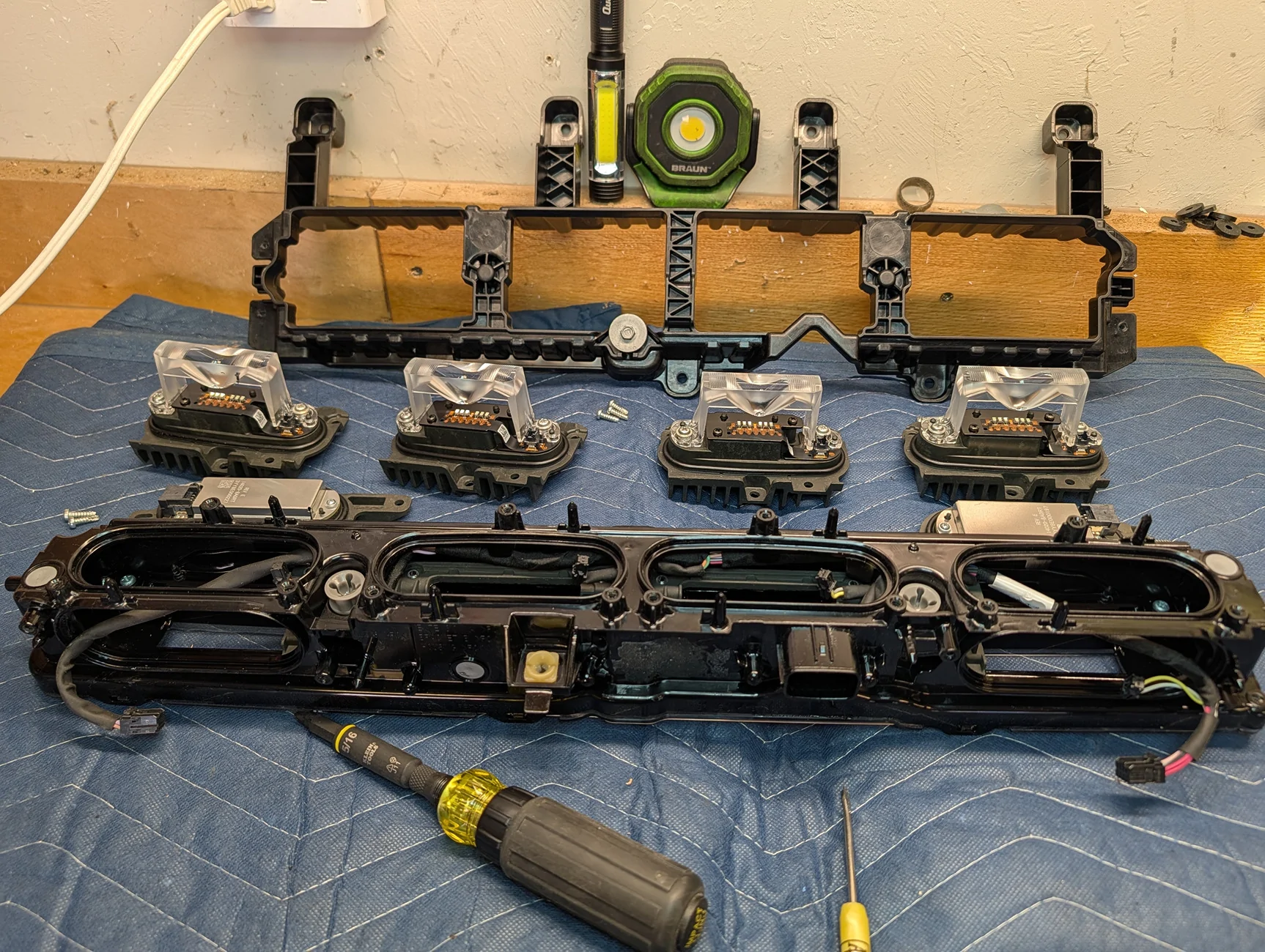

Looking around this forum for information on doing this on a 4Runner. I bought my OEM light bar from those same people on eBay to install in the Trailhunter grill on my 4Runner. Or more accurately...Try to install LOL.
I believe it's the same light as the Tacoma, just a different mount. It has the same connector on the back. Here's what the connections look like between it and the switch, there's an equal amount of wiring going up to the harness on the passenger side of the engine bay too.
2024 Tacoma OEM TRAIL HUNTER LIGHT BAR Question 1771550977689-hz
The Tundra guys got lucky that there's a spot they can drill a hole in the factory light and bypass the CANBus shenanigans, but after taking my light bar apart, I'm not really seeing a way that I'm going to be able to make it happen. There's an enormous amount of wiring inside it, a couple of pieces of kit wired in that I have no idea what they do, and what appears to be a whole ass computer. It's an absurdly complicated piece of equipment, for it just being a light bar.
I don't have high hopes, and will likely be doing aftermarket soon LOL
Thought I'd share what I've learned so far. Good luck on your journey!

Sooo...It's possible. If you're comfortable with cutting into the wiring and drilling holes in the light bar LOL
