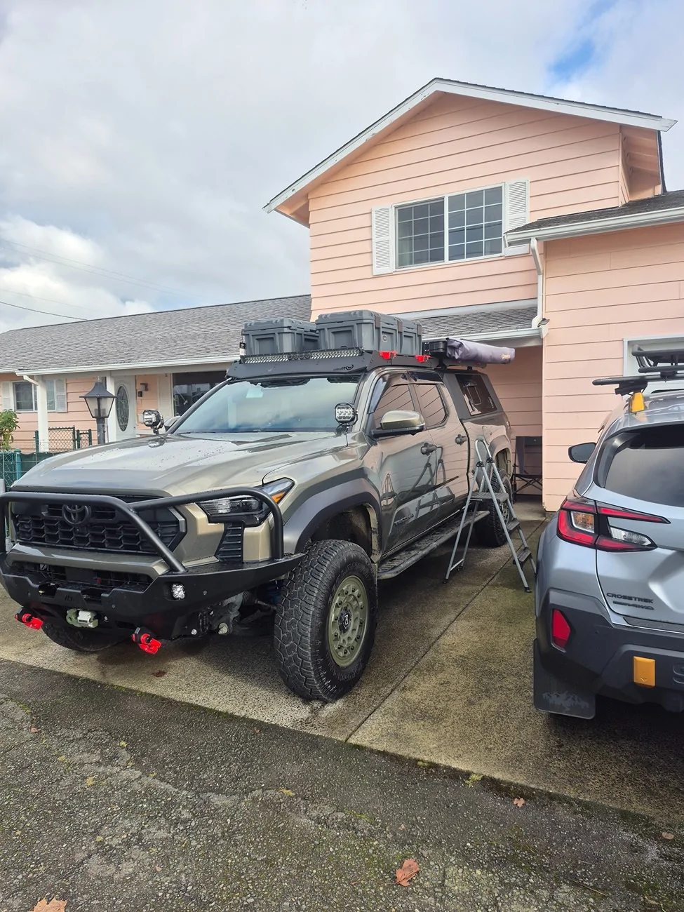

I don't believe i'm plugging.It will cause the computer to freak out. I say this because I am plugged and removed my fog lights on my TRD OR and it didn't cause any lights to come on..
