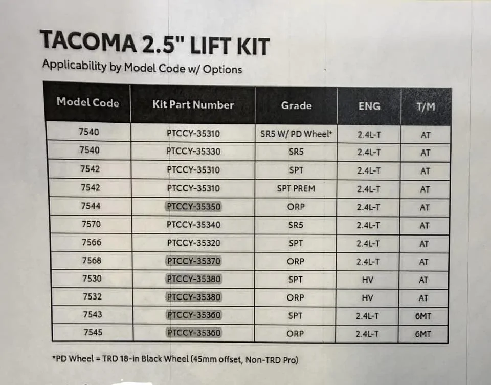

I believe those lower knuckles were for the TRDOR but don't quote me. There is an image floating around somewhere, along with a PDF, that you can try and cross reference to find specifically which parts you need.
See the references below to find your specific part numbers.
