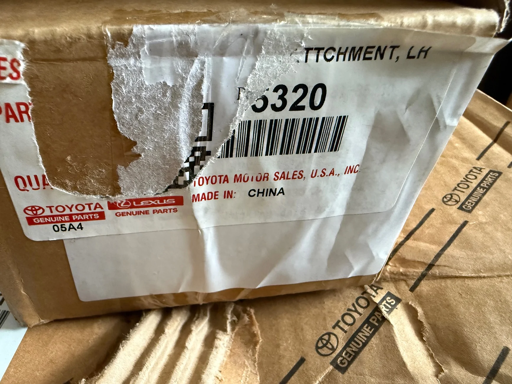

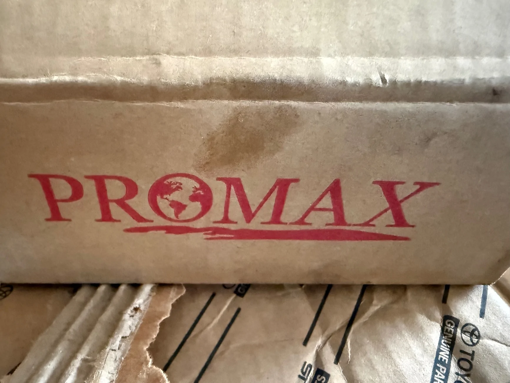

Here is what it came in. Each box had the label ripped like this I do believe the above part numbers are correct though
2024 Tacoma PTCCY-35350 Availability IMG_5736
2024 Tacoma PTCCY-35350 Availability IMG_5737
