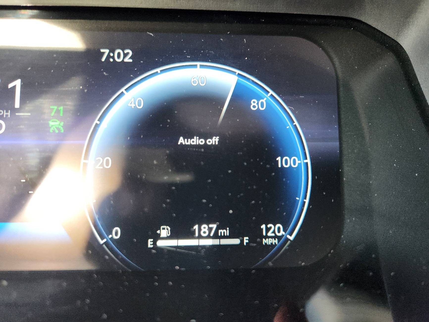

Not quite sure what you're talking about on the Android auto mixer as I've never seen one. Here's what I meant about the audio being off.
2024 Tacoma Audio isn't working while navigating with Android. 1000013068
Oh that's interesting. Never seen that. Is that the media/audio screen? I don't use that one so I don't know what would cause that. Maybe something in the Toyota side of the head unit. There are some audio and volume settings in there.

I had never seen that before either. That's all that it shows. It had been no options to turn it on or off. Just to clarify, that is the dash screen you're looking at
I was asking which dash screen that is. You can have 3 screens and customize each so it isn't clear what that one is supposed to show. I'm assuming it's the one that shows the audio source. What happens if you just press the volume knob to turn on or off audio?
