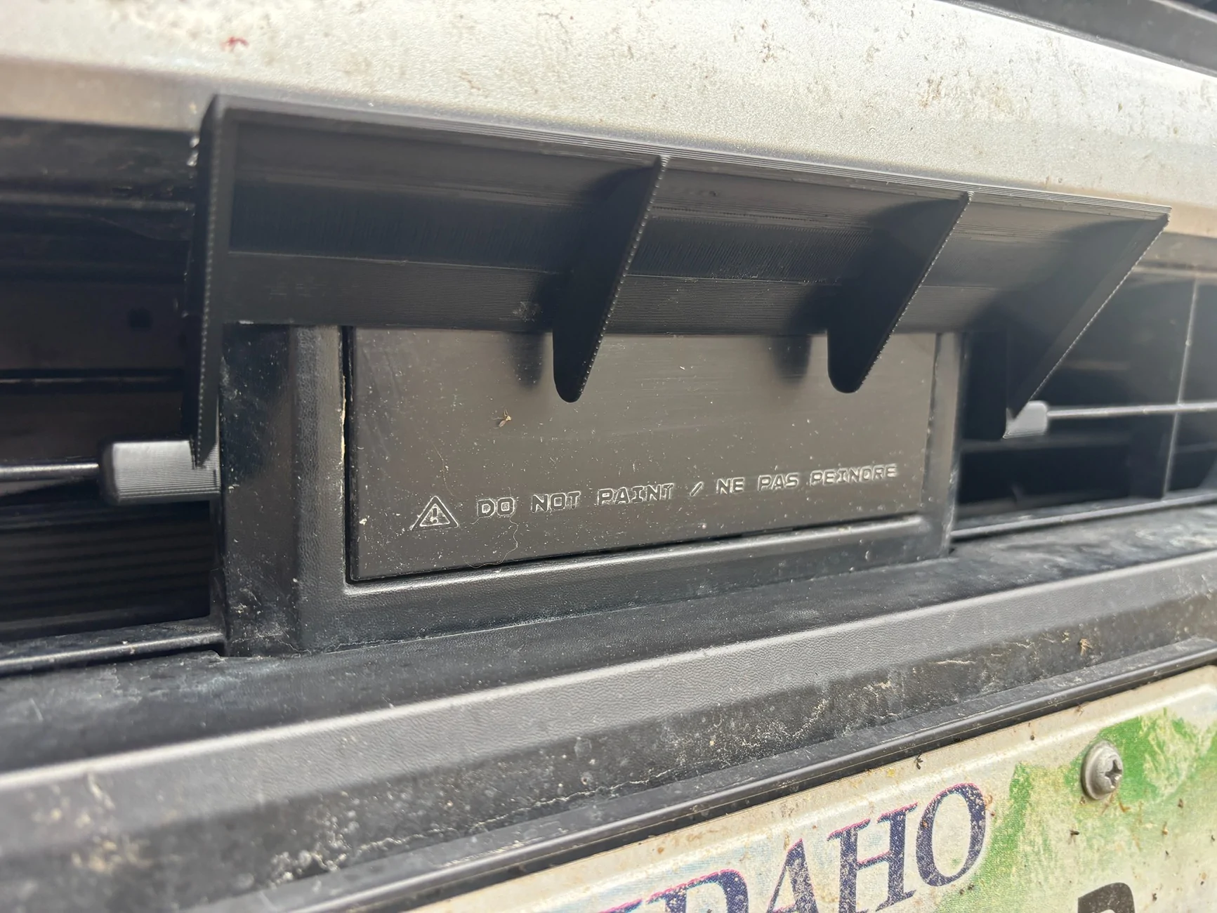

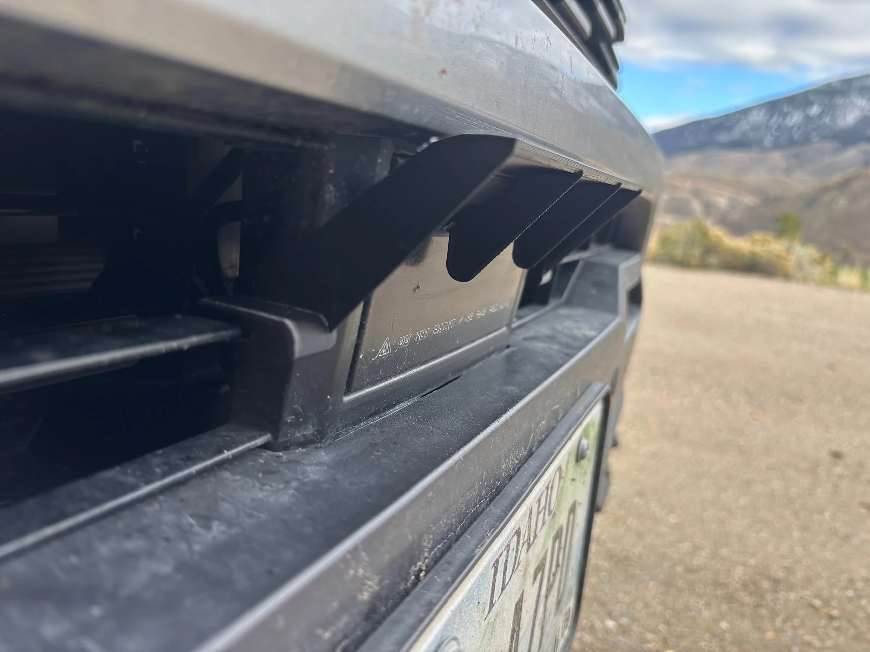

You read that right, for us northerners, I suspect we've all been driving in a snowstorm, and had the instrument cluster light up as if it were Christmas.
It's caused by snow building up on the radar sensor in the bottom of the grill.
2024 Tacoma Radar Sensor Air Scoop–3D Printed IMG_0713
I designed and printed off this wind scoop, that'll hopefully aid in blowing it off.
2024 Tacoma Radar Sensor Air Scoop–3D Printed IMG_0718
2024 Tacoma Radar Sensor Air Scoop–3D Printed IMG_0719
I'm certain it doesn't interfere with the adaptive cruise control. Will it work? Ask me after the next blizzard.

How does it attach looks like it hooks in? Or any 3M tape needed? As of now i would assume you have it on and any interference with it yet?
It clips to the grill, but it's still easy to remove.
Everything seems to work fine–adaptive cruise and lane assist–with no dash lights. I think if it were printed with carbon fiber or glass-infused filament, it might cause an issue, but this PETG plastic doesn't seem to have an effect on it, plus the stuff doesn't mind UV rays and is fairly heat-resistant.
