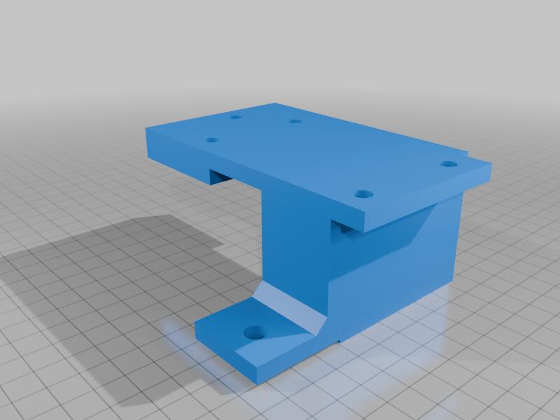

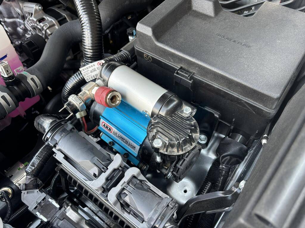

For automotive use, what type of filament is needed?"
This is what I wrote about it on Thingiverse:
This is a bracket for mounting a single ARB compressor in the engine bay of the 4th-generation Tacomas.
I printed this with PETG with a heat tolerance of 176Âş. In a test run with the bracket in place without the compressor, the temperature of the part was at 127Âş after a twenty-mile run on a hot day. Ask me at 10,000 miles how it's holding up. ;)
Bolt the compressor to the bracket before installing it. I used 5mm socket-head bolts for this. Use 6mm socket-head bolts to bolt it to the truck. Make sure to install washers. You'll need extra-long ball-head Allen wrenches to do this.

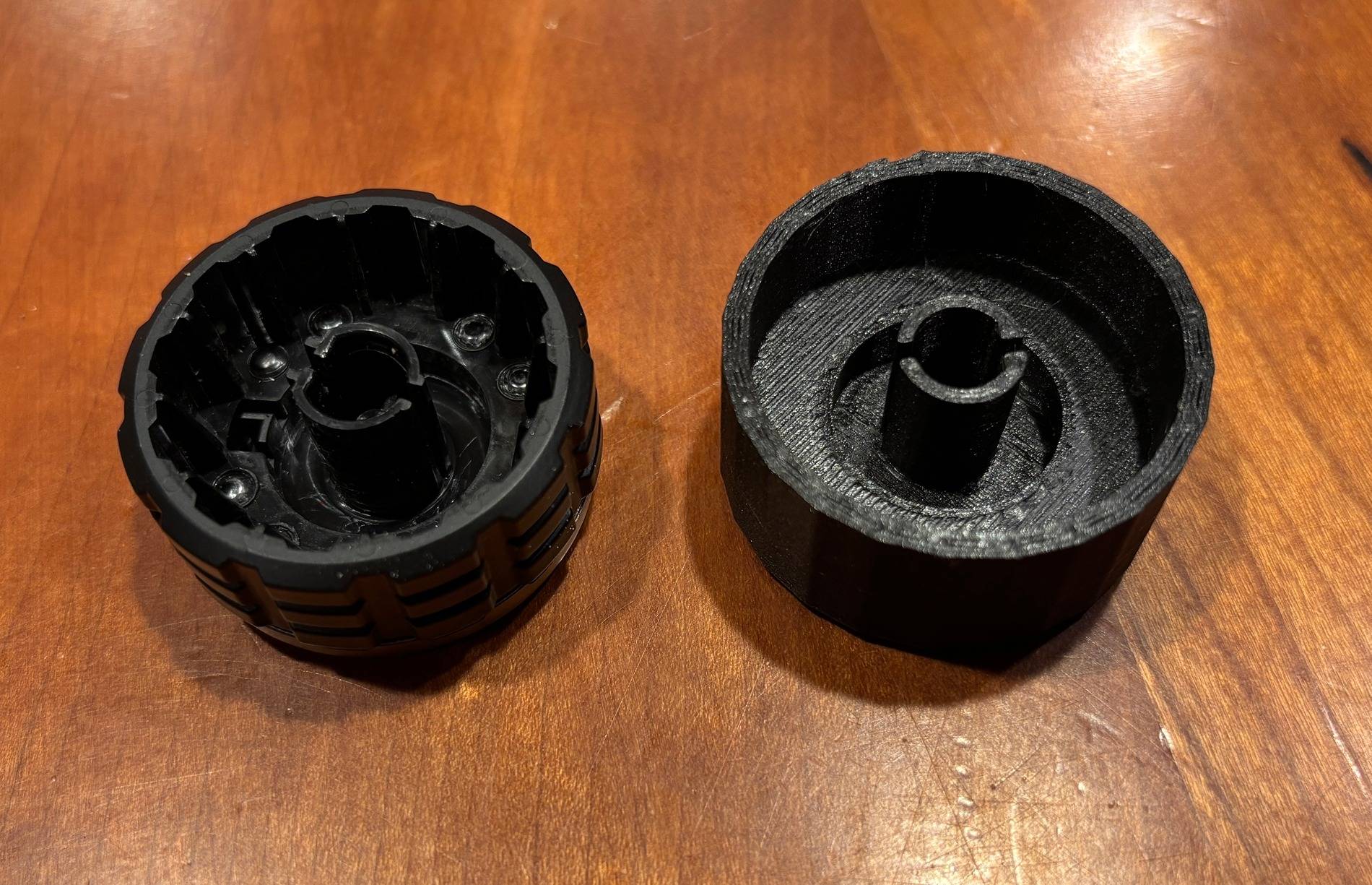

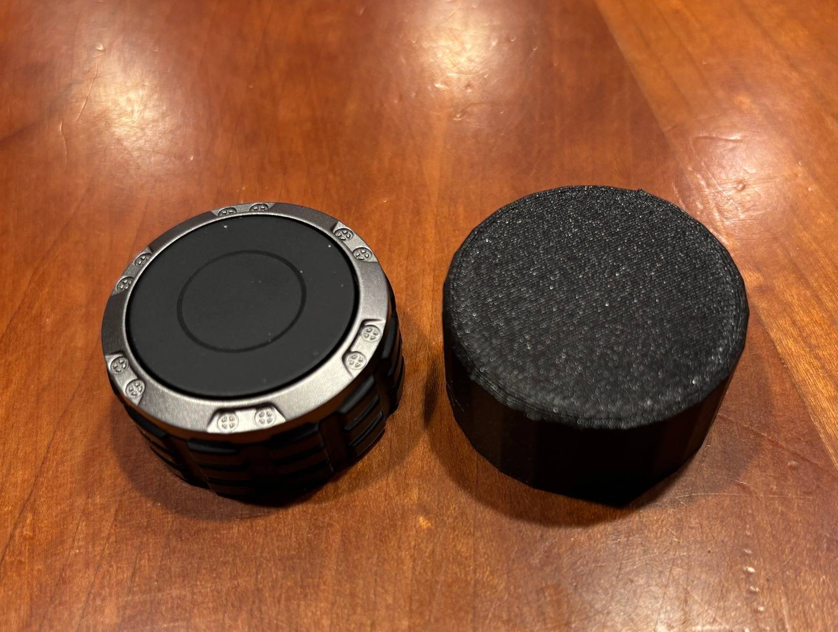

So... the volume knobs are breaking below the big screens? Mine hasn't, but here's a replacement if you have a printer.
2024 Tacoma My 3D printed parts for 2024+ Tacoma 4th Gen -- bed storage box, flashlight holder, oil change channel, ARB compressor bracket IMG_7855
2024 Tacoma My 3D printed parts for 2024+ Tacoma 4th Gen -- bed storage box, flashlight holder, oil change channel, ARB compressor bracket IMG_7856
You can grab the file over on Thingiverse:
https://www.thingiverse.com/thing:6807426
It's not quite as fancy as the stock part, but it works fine. I'll throw mine in the glove box.
