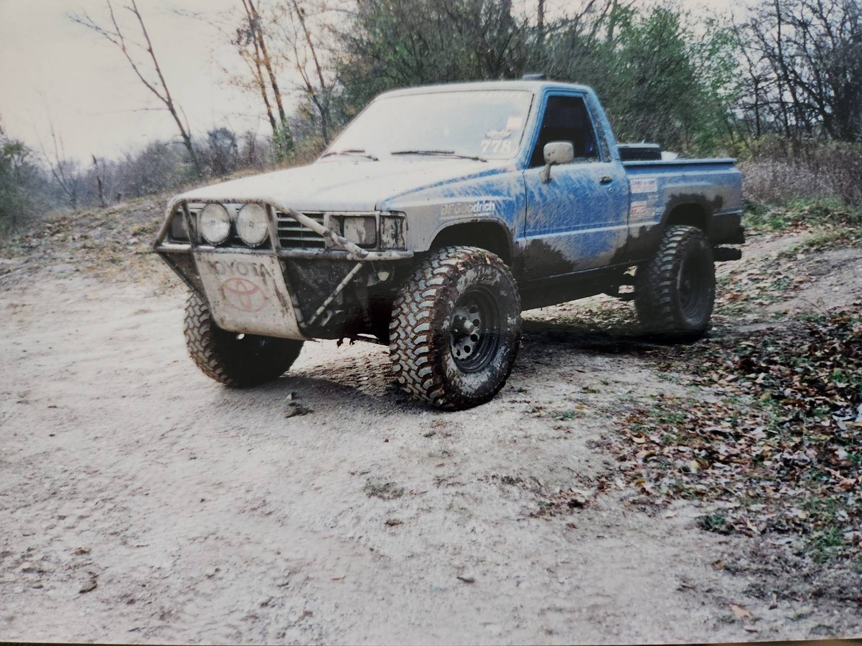

I once put a gussted idler arm on my 85 2wd on my own, never did the alignment before the trip to Arizona (Parker 400) and it chewed up my Mud's from Wisconsin.

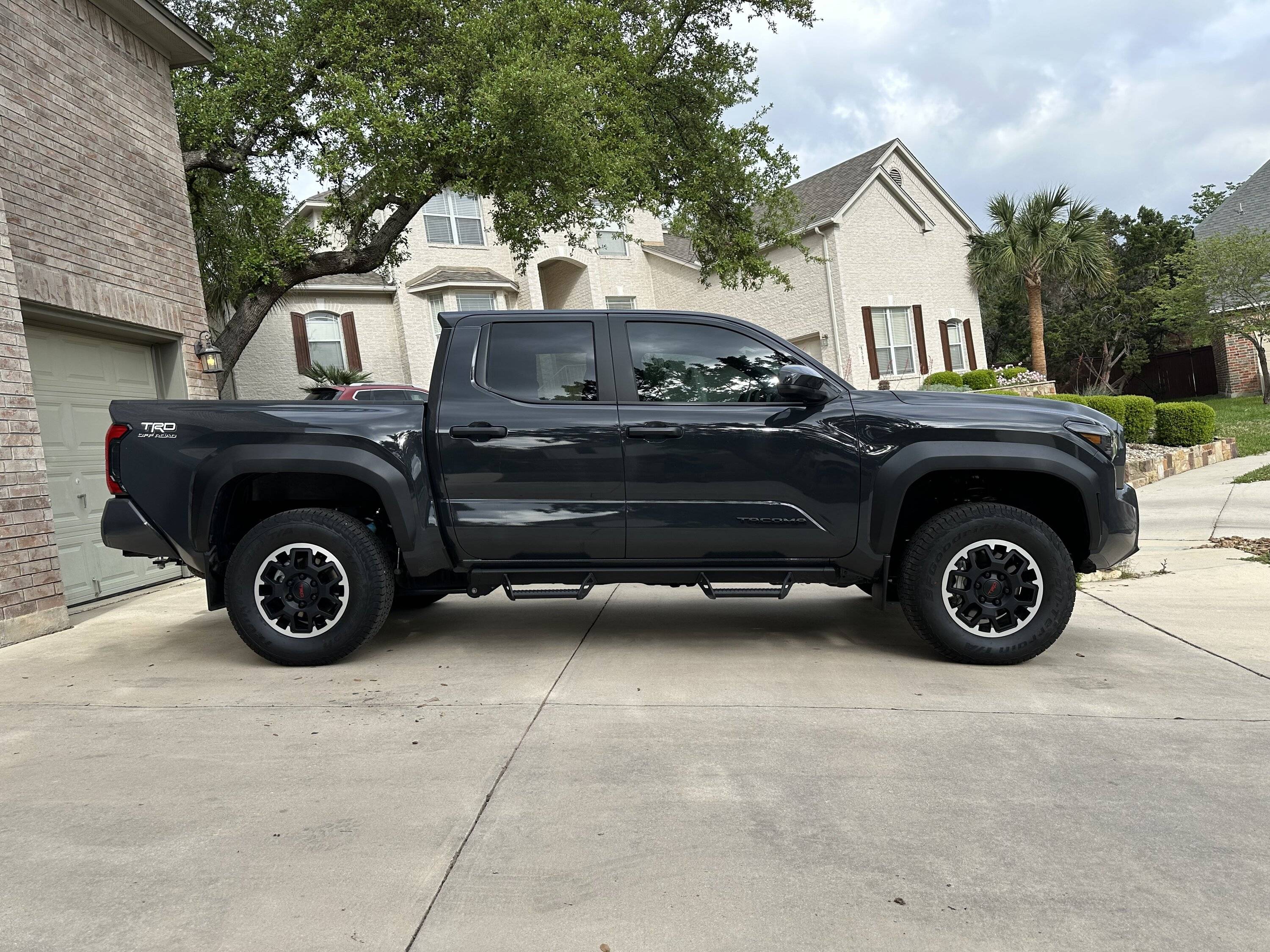

I've had the ReadyLift kit on my truck for a week now. It makes the truck feel tall when looking out over the hood.
That looks amazing! So there’s no lift on the rear? Just the 1.5” up front?
I was originally thinking about a 2/1 lift but that looked like it made the front slightly higher (in photos anyway)… but yours looks great. Just the 1.5” in front?
