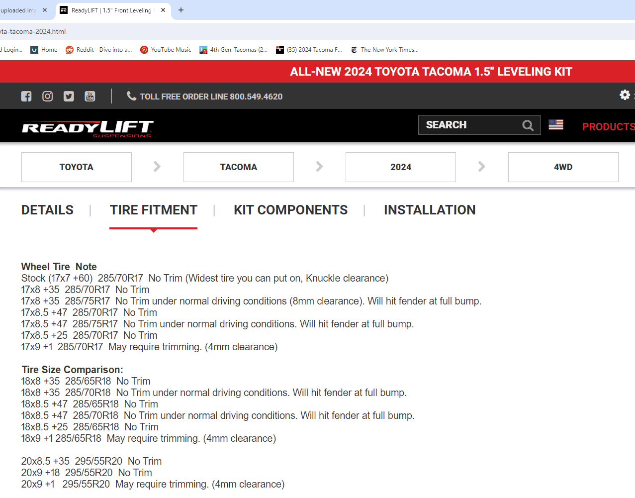

Do you wish you had 285/75/r17 now instead with the level? I'm kinda thinking 70s for stock but 75s for level

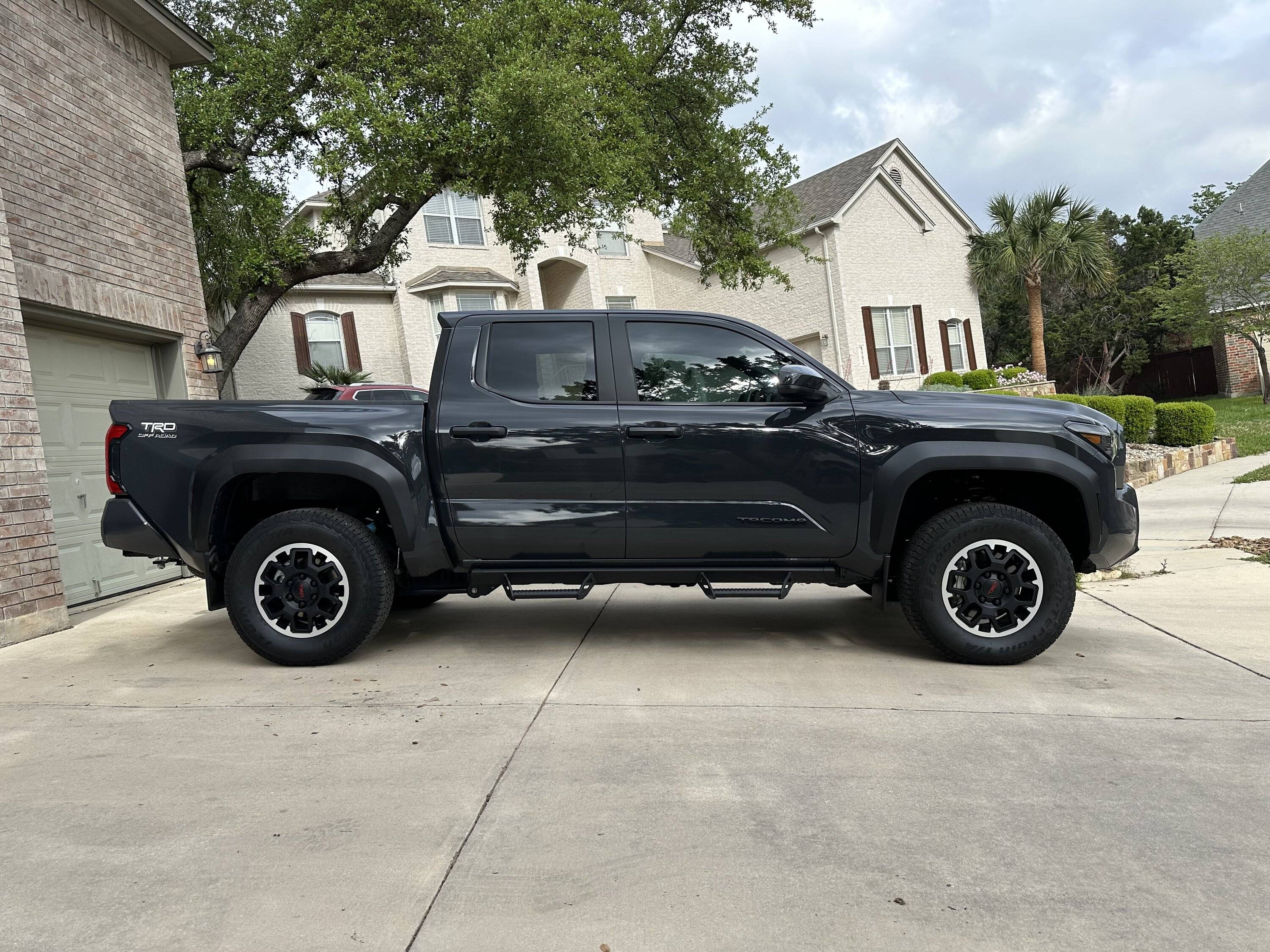

just installed the 1.5” readylift leveling kit. All stock besides leveling kit. Looks great to me. Still a slight rake which I prefer and now it doesn’t look slammed in the front like before. Install was easy but a bit annoying to trim the OE strut top mount bolts. All in it was maybe 40 minutes, but I’ve installed a lot of these kits before.

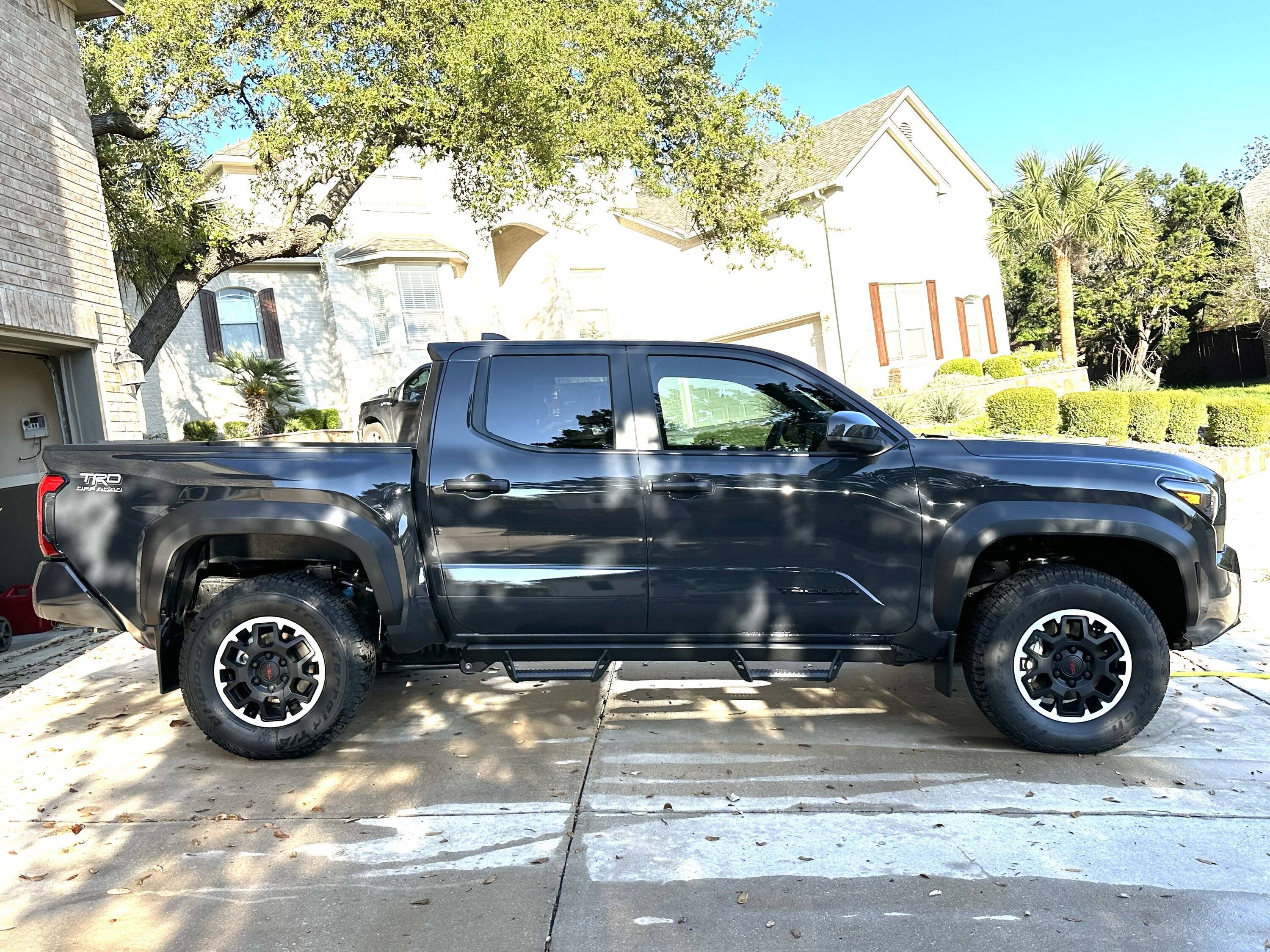

this is before the leveling kit. The factory front ride height looks really awkward to me. Truck looks normal after the leveling kit.

Yeah that looks much better. Still has some rake too. Thanks for posting that. I want to put winter tires on the stock rims in the stock size with a 1.5” level and was curious how the stock size would look.
I’m debating on the Rough Country level because it’s half the price of the ReadyLift, there can’t be that much difference can there?
