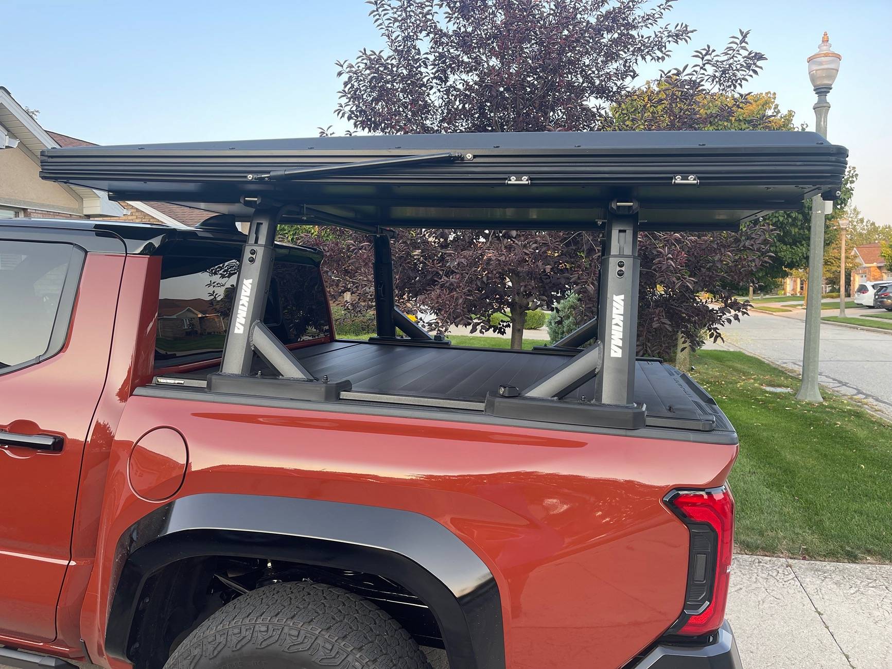

I have the retrax pro xr with the Yakima overhaul HD racks. Have a tent on currently as well

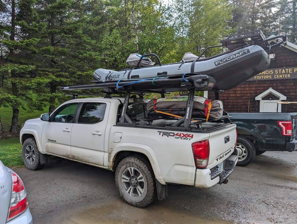

Agreed re: weight limit. Easy to hit it. I love my Retrax XR Pro on my 3rd gen, but when my Trailhunter arrives I will probably figure out different setup that can handle more weight. Just about anything can fit on the Retrax since it uses a T-rail system. The weight limit is the issue.

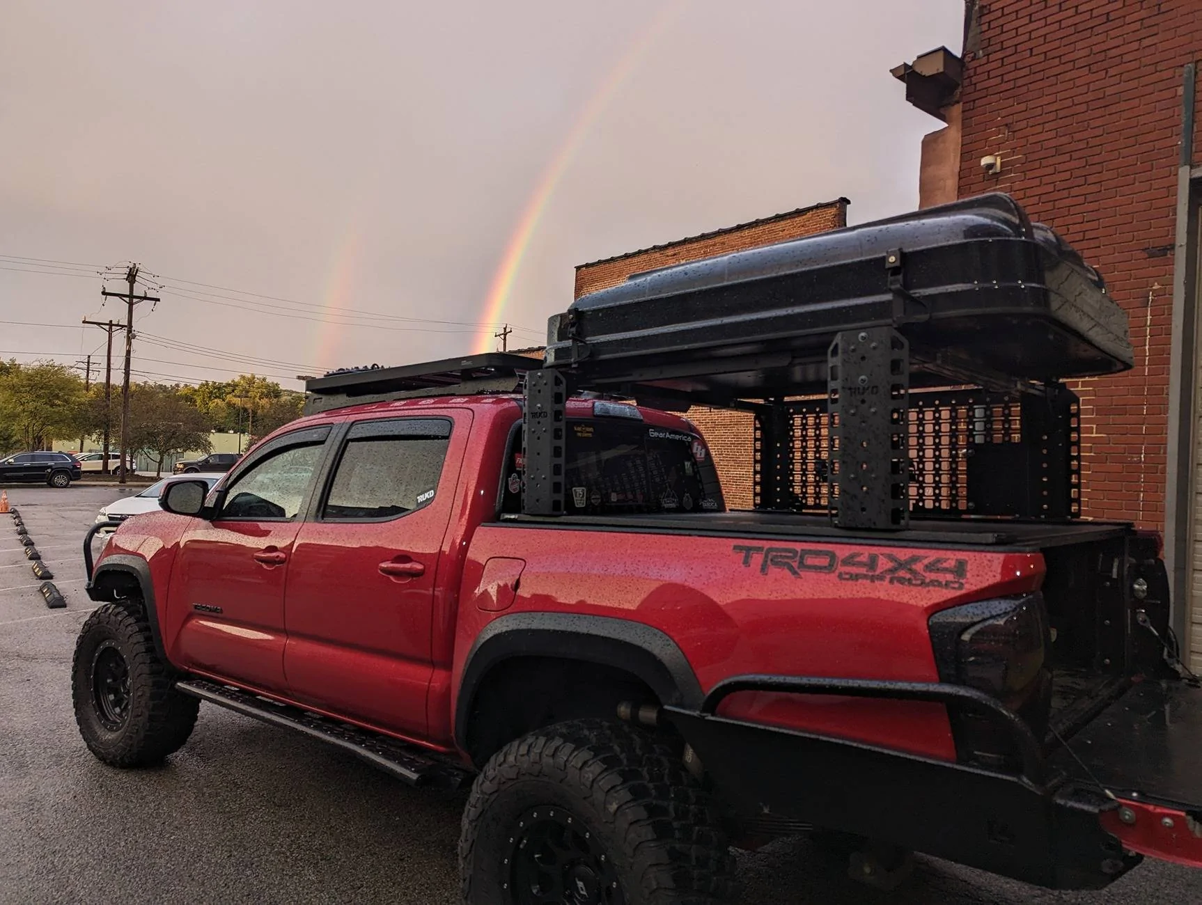

I have the retrax pro XR on my 2024 TRD Pro and I added the Yakima Skyline towers with HD bars and adapters (landing pad 26) and have a ikamper DLX mini on it.

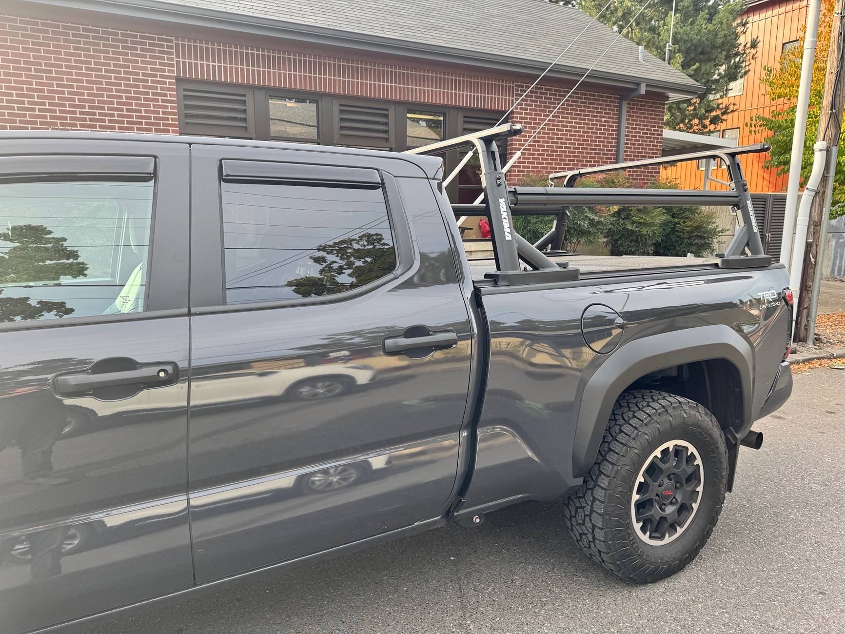

I’ve got the same setup with the overhaul HD and sidebars. Seems to make it a lot more stable on the t-slots. Mine is the long bed RetraxPRO XR which retrax finally released last month.
